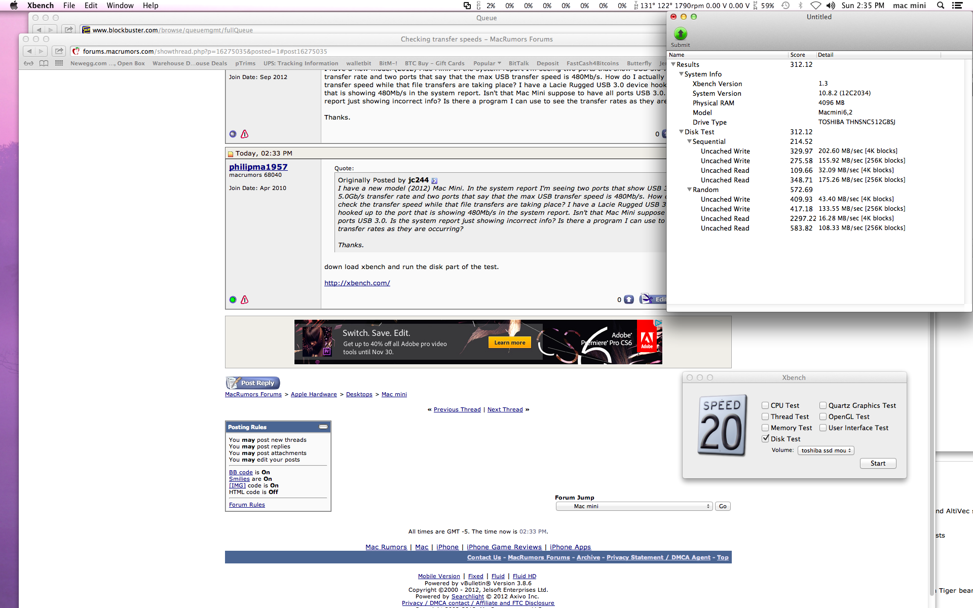

down load xbench and run the disk part of the test.
http://xbench.com/
my read write is 200/170 on a slower ssd a toshiba on a t-bolt case
