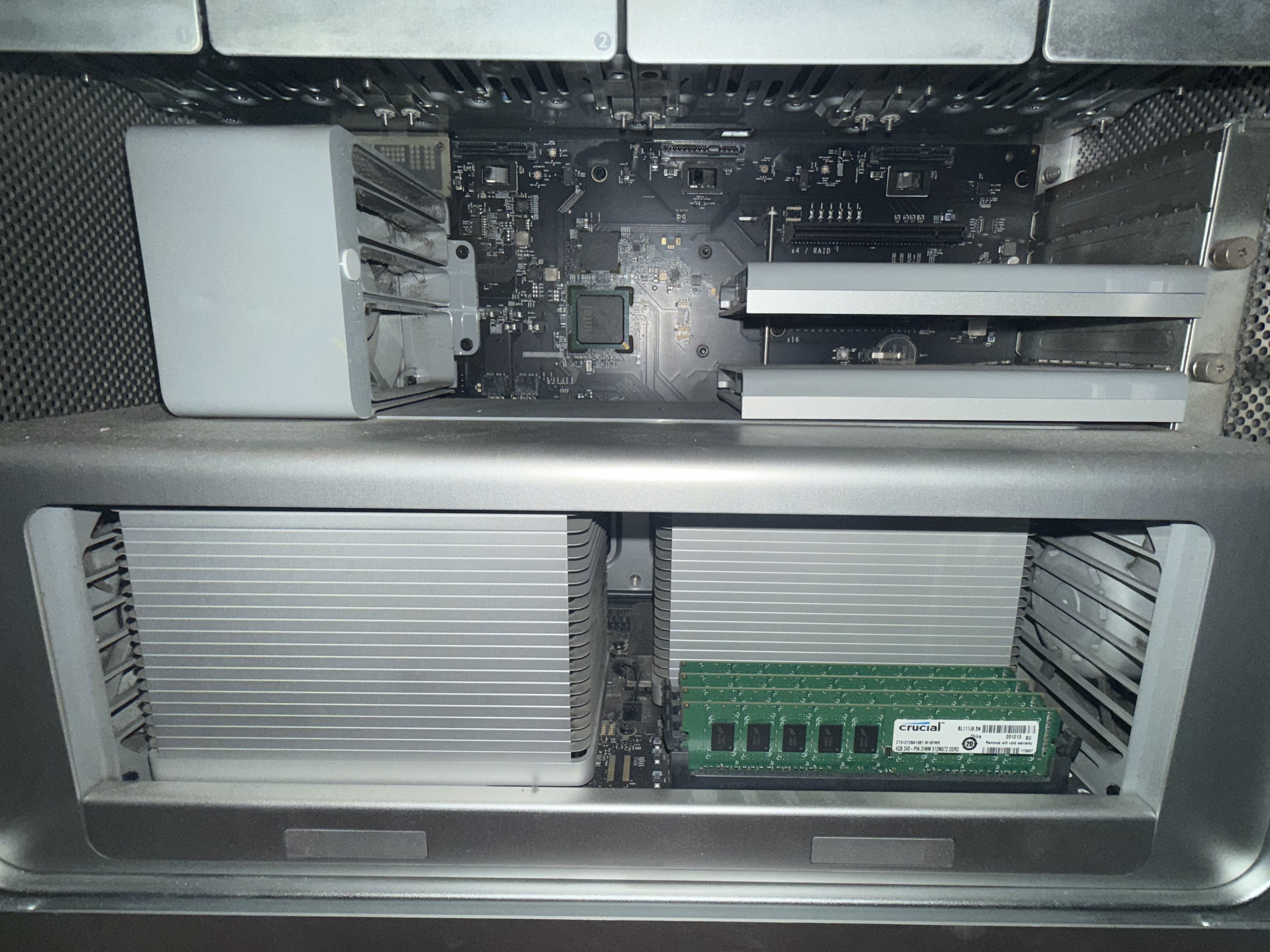

I just wanted to share a quick observation, as you're trying to get your footing with this project. Looking at your most recent photo, it appears that you actually have a Mac Pro 4,1 (2009) or 5,1 (2010-2012). The reason I believe this is that those later models had two FireWire 800 ports on the front (the bottom two in your photo). The 3,1 (2008) had one FireWire 800 and one FireWire 400. FireWire 400 ports are a different shape, so it's the easiest way to tell the older and newer generations apart at a glance.
You should have a peek at the label on the back, and share the specs so folks here know exactly what you're working with. A photo of the inside might also illuminate things.
Good luck!
Just by looking over the pictures you have posted, this is a 4,1 or 5,1 Mac Pro. That's a good start. So it is NOT a 2008 model. It's either 2009 - 2012.
I can tell this by the extra Firewire 800 ports on the front and back.

Yes, but you need to do all the maintenance (like replace the BR2032 RTC battery and clean everything) then install El Capitan (10.11.6), cross-flash it to MacPro5,1, do all the firmware upgrades, finally you can run Windows 10.

With a real MacPro5,1, you'll gonna have one step less, the cross-flashing one.
Unless you got a Mac Pro from someone that already did everything, not the case of 2nd hand Mac Pro from Universities/Corporations, you will have to do all the other steps I've listed.
Mac Pro is not a cheap machine to own, even if you bought it for almost nothing. Maintenance and upgrades will be expensive, money and time wise.
For running Windows only, get a PC.
