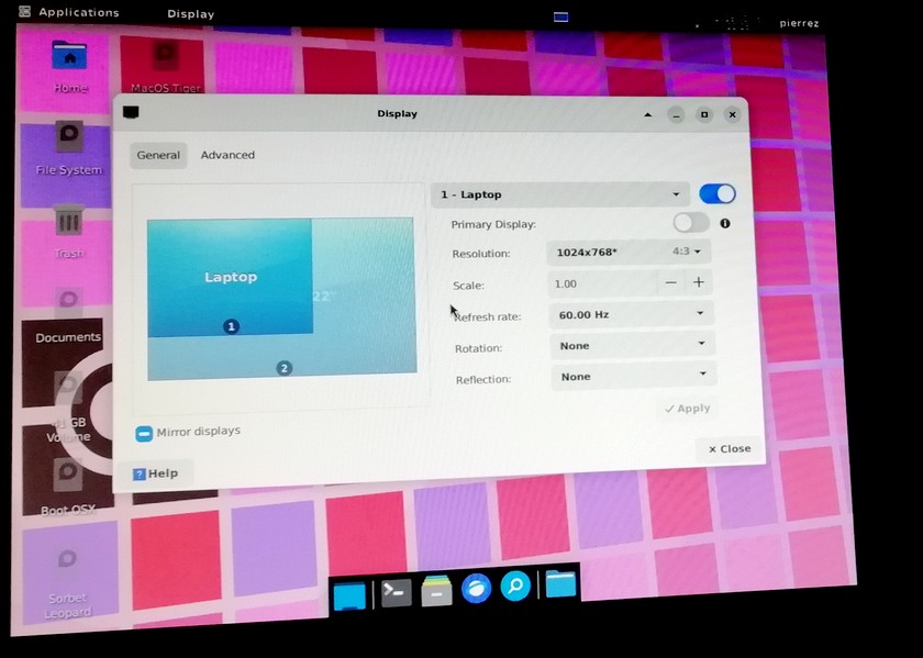

Then added Xorg (Wayland being too heavy for my machine as per above advice), and then XFCE4 (supposedly lighter DE than GNOME or Plasma) on top of it, created a .xinitrc file in my home dir, with this single line of code (not sure that's what's needed, not sure of anything to be more precise) : exec /bin/startxfce4 --with-ck-launch > ~/.xsession-errors 2>&1
and launched the DE with : startxfce4
The result can be seen below. The DE does start (after a brief moment, no issue here), however neither the mouse nor the keyboard are active, it just sits there for a while and I can't do anything but watch it turn the screen off after a few minutes, and that's it, I must then hard reboot. :/
The display settings panel is there only because I've plugged the external monitor, which auto launches the panel and do send a desktop there (nice !) - albeit restricted to the laptop 1024x768 definition.
What I would love to understand is :
- how can I replace mesa with mesa-amber as advised above ? I tried to apk del mesa first to avoid mixing it with mesa-amber, but it won't let me
- should I install a DM ? (I've read all and the opposite about this)
- obviously, any idea why the DE ignores mouse/kbd action ?
- and, just found out that Wayland is installed while I had initially installed Xorg instead, most probably done by adding XFCE4... so how to uninstall Wayland without having to remove XFCE4 altogether ?
Any other DE I should want to try at this point ?
TIA.

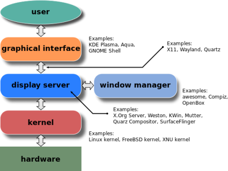

Why the f*** does the keyboard stop being listened to when going from TTY (where it works just fine) to the DE ? Why should one have to "do something" special for the keyboard to continue working, seriously ?
If you consider that technically the tty it's running on one environment and any DE will run on another layer, yes you'll need to prepare for use everything, the graphics, input, sound etc.
doesn't make sense to me but that's the way it clearly is, the DE should be able to do _at least_ what the tty/console does without having to tinker here and there, I mean come on automatic keyboard support is dated from previous century, and today one has to "explain" to the DE how to deal with it, really ? LOL. (in FR we say "rire jaune", "yellow laugh", nervous laugh in fact)

Anyway, I think it may benefit you to pretend this hobby actually is from the previous century and go back to basics. Define what it is you want to get out of the system and do the absolute minimum to get there. What I mean is, what are your goals for running this? Is it to get a nice, shiny, pretty DE that looks cool and has lots of packaged programs? Or are you looking for something a bit leaner, say a current kernel, modernish web browser, office suite, and Spotify?
I'm sure you know this already, but it goes without saying logs are your friend. And in my opinion, in this type of endeavor, they're about the only friend. dmesg, stuff floating around in /var/log, running processes in the foreground, etc. are probably gonna be the best ways to figure out what is going on. If the system isn't hanging when you start Xfce and it really is just the HIDs going sideways, I suggest enableing sshd on your Chimera box and ssh into it from another machine to view logs that might not persist through a reboot.
If that fails, I suggest focusing on getting X to run in the most basic vanilla way, with a nice xterm, and see if you can't get the mouse and keyboard functioning. Forget the DE (for now). Go back to the days of startx (asuming that it's available, else you might have to use xinit) and see what happens. If it doesn't run, can you use your mouse in tty with gpm and something like htop or links?
I admittedly don't know much of anything about Chimera specifically to guide you better on where to look, so I apologize if this is all obvious things you've already done.
If you can get a vanilla X session going with mouse + kb, then you can start to add some of the 'fun' programs on top you want (maybe a nice WM instead of a full on DE?). I suspect you may end up needing to build some things from source but maybe not depending on what your goals are. Of course, you might also be able to figure out a trivial fix from the logs for what is happening to your mouse and keybaord when starting Xfce.
My two cents, I hope this makes sense.
