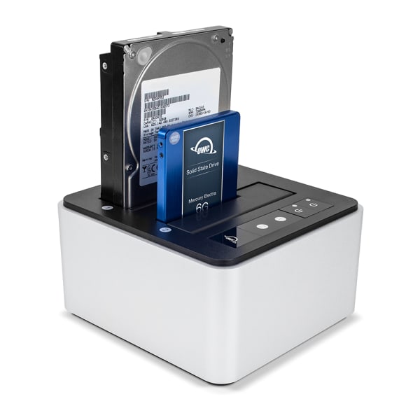

I've been using Chronosync for years as a backup solution (in addition to Time Machine, on a separate drive) and it's worked great all along. This has been to a Firewire 4-bay drive rack and more recently to a USB-3 dual-dock solution from OWC.
owc-drive-dock-usb-c-with-hd-ssd

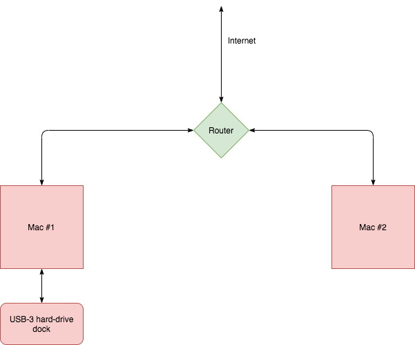

Now I got this idea that I could back up another Mac in the same house (i.e. connected to the same LAN router) to a hard drive inserted into the abovementioned dock using Chronosync, like this:
Both Macs already have their own Chronosync license, but would I need to buy ChronoAgent in addition to this (and two licenses?) or can I do what I ask already with just the Chronosync software?
You should get ChronoAgent for Mac#2.

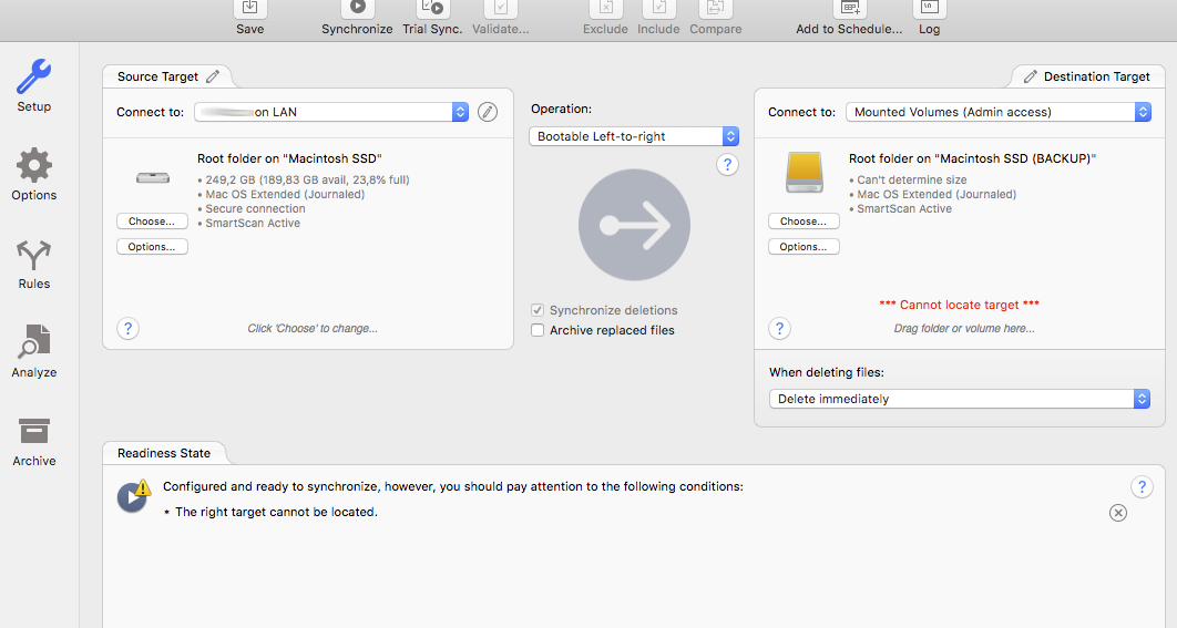

Then, on the Mac with the backup drive attached (in my case I have a USB-dock for removing/inserting standard 3.5" SATA drives) you have to have Chronosync installed. It's from this computer you decide when to perform the backups (as long as the other Mac is power on of course!) and how it's done (which files to back up etc.).
As someone who's used Chronosync for years I set up a backup document the exact same way as I've always done with locally attached drives, the only difference being that I selected the source drive as one attached via ChronoAgent on the other computer (don't mind the error message in red -it only tells that the backup drive has been ejected and therefore no longer available) as opposed to a hard drive inside the same Mac:

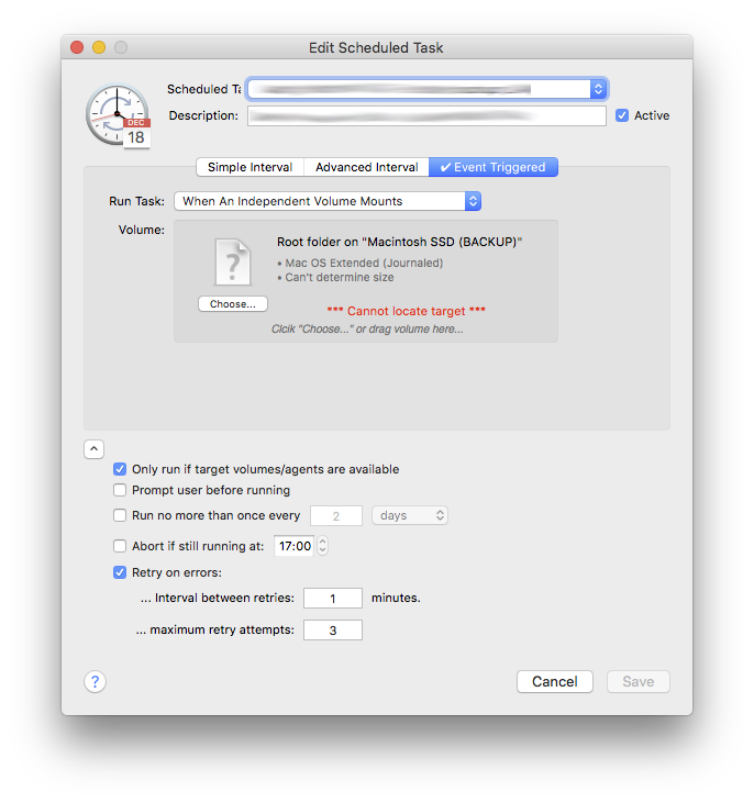

And to make it even more convenient I've set up its Scheduler like this:
This way, whenever I insert the backup drive into my drive dock (it recognizes its name) and the other Mac is switched on, the backup procedure will start up. So once configured I can forget about all the details and just remember to physically make the backup drive available. Perfect for doing backups (which so many people forget or set aside all together because they find it too cumbersome or complicated).
