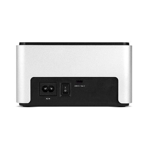

Internal power supply
Yes! The unit comes with a built-in power supply, so there aren't any external power adapters to be used. This means when you turn the unit off (by using the rear power switch) it actually shuts off power to the unit (unlike a "wall wart" power adapter which draws power (and generates heat/a potential fire harzard) even if the device it's connected to is switched off. According to the specs on the OWC product page it works anywhere between 100V to 240V 50/60Hz. I suppose the cable comes with a plug that suits the country it's sold in (I don't know as I've only bought one of these, and in my own country, and mine came with a standard plug which fits here).

Neither OWC's website nor the user manual mentions each cable's length, which is why I've stated them here. The USB socket at the back of the dock is a USB-C type (just in case you'd want to use another cable than those supplied). If I'm not mistaken you shouldn't exceed the 1m cable length limit if for maximum transfer speeds, but I haven't tested this so I really have no idea how much of a speed penalty you'd pay should you need to place the dock further away than 1m from the computer.

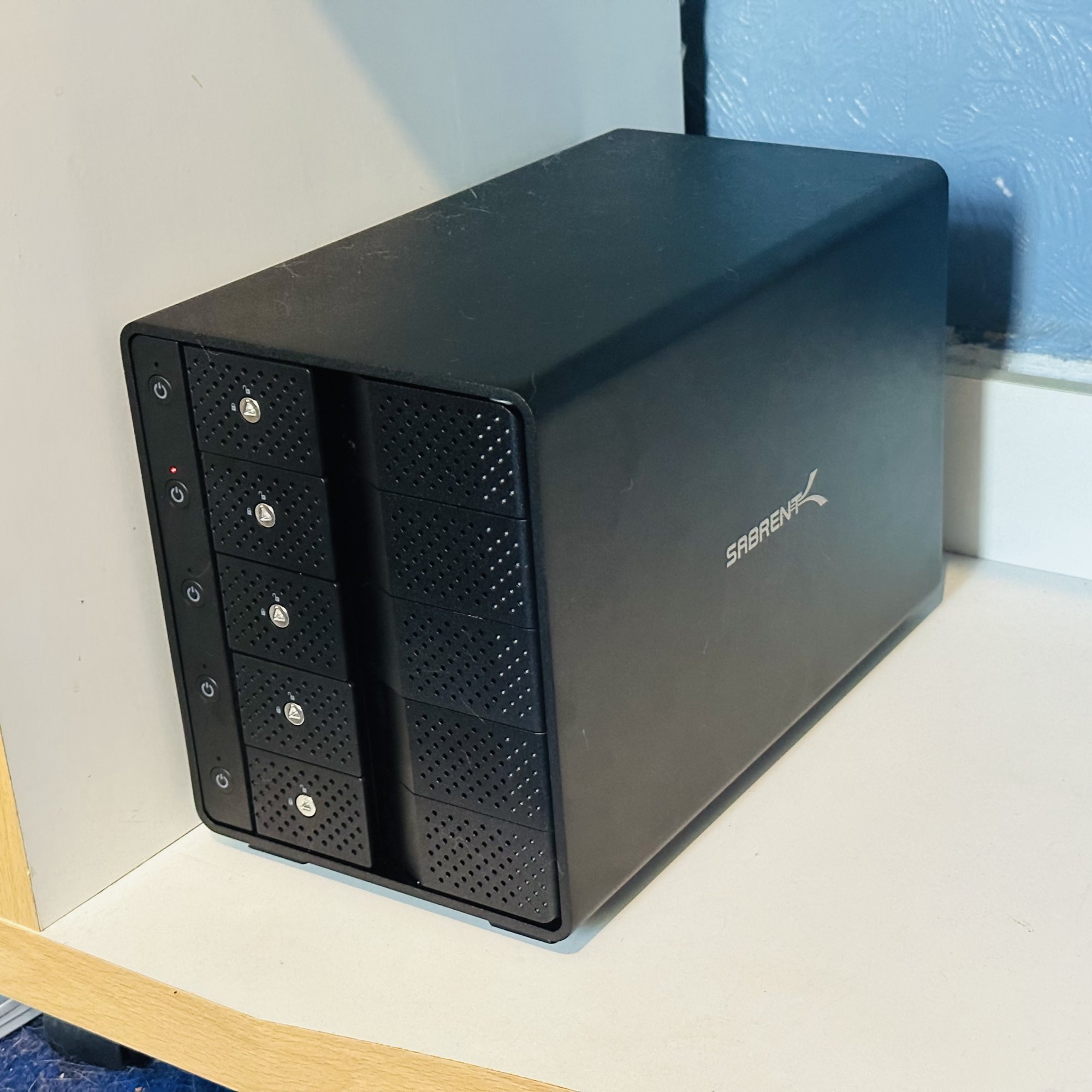

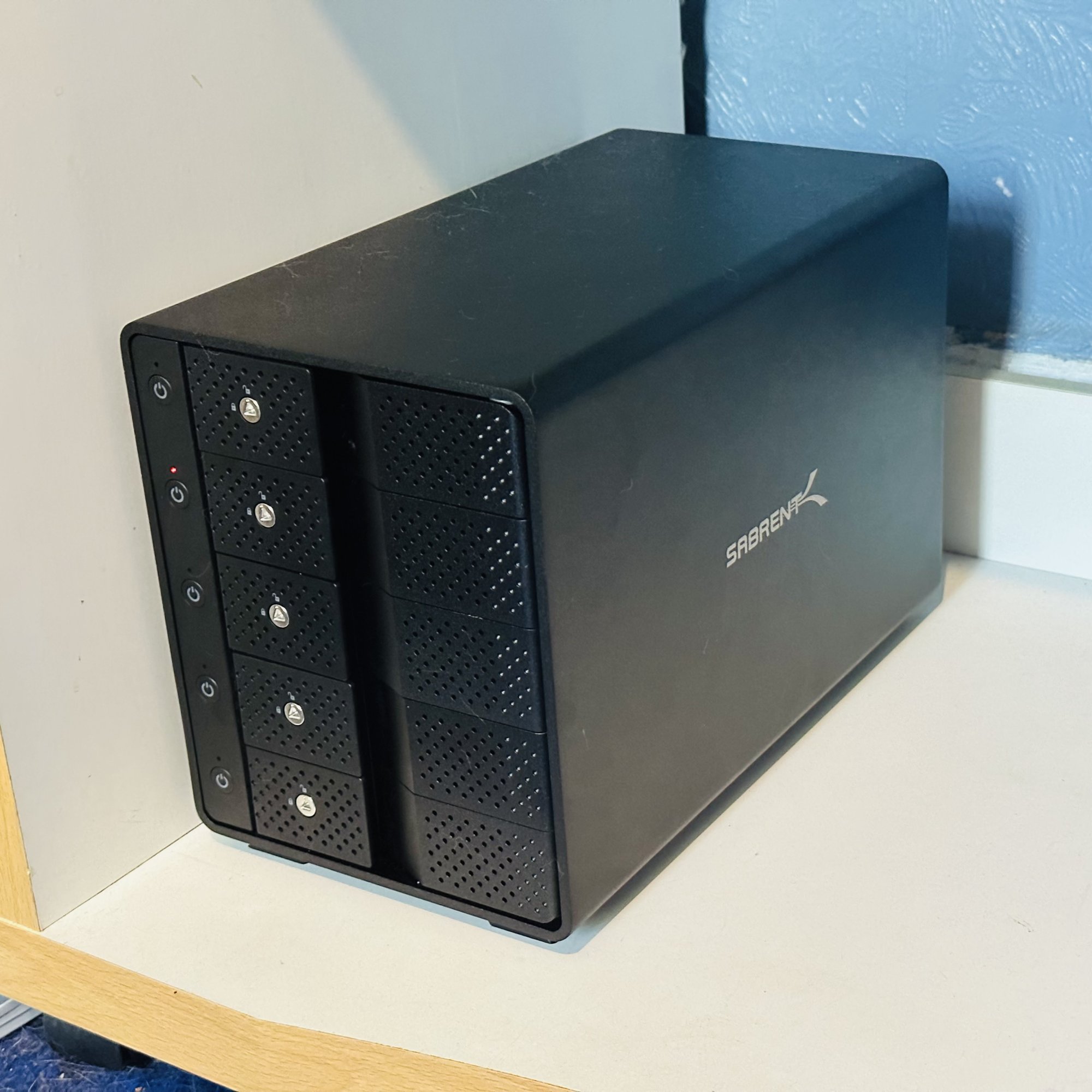

Just as a follow up I still have the Star Tech solo dock for drives used occasionally but ended up getting a Sabrent 5 bay dock for longer term storage. It’s basically the same kinda thing. Individual switches to turn drives on and off. Runs from one USBC connection. The fan is silent when the drives are off and even when they aren’t being accessed. Nice bit of kit.

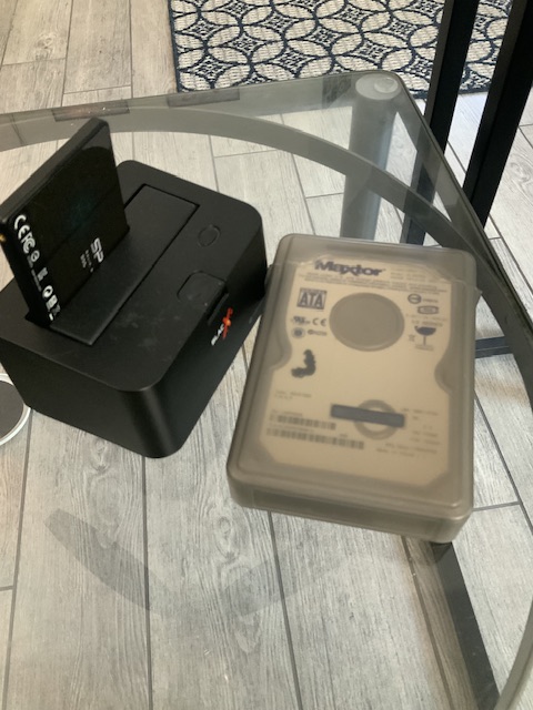

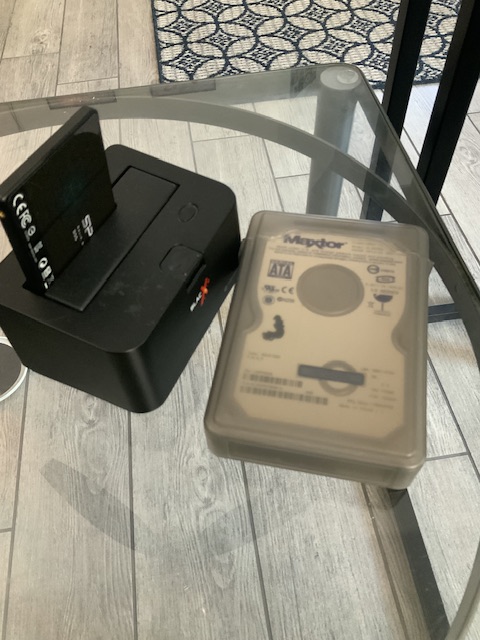

I was hoping to get a thunderbolt 3/4 / USB4 2 bay dock, but it is too expensive. I’m going to run a 2TB green WD and a SATA 2 TB SSD. Rarely, if ever at the same time. The spinner will be for my iTunes purchases and the SSD will be encrypted for my iCloud Photos local copy.
No heavy duty video editing, so a 2 bay ought to be perfect, and space saving as well.
I was actually wondering if you can boot off it? Good to know. I bought the Thermaltake BlackX E-SATA version specifically so I can boot off it. It’s old and only has usb2, so it will be retired.
As long as whatever I get can handle a basic SATA SSD being on 18 hours a day or so, I’ll be fine. I just want to use the new Mini as a NAS really….Ive already got a 4TB iron wolf ready after I test any dock with the green drive..
