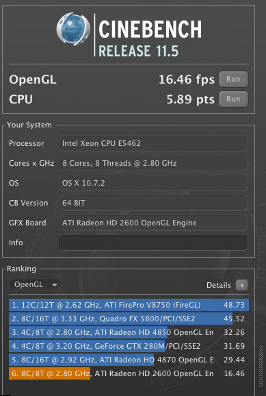

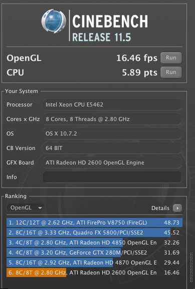

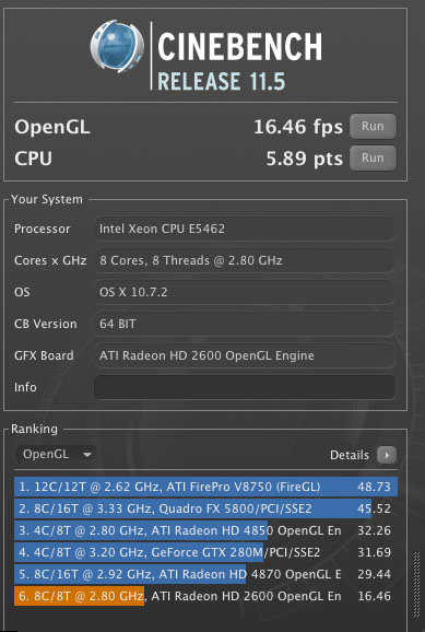

interesting and surprising, i ran cinebench on my 2008 macpro
My early 2008 mac pro has 10gb of ram and compared to indg 2011 mac mini the server the raw numbers are pretty similar. so if i upgrade to a 2011 mini server what performance improvements will i notice?
Sorry my first reply missed that Cinbench had the CPU numbers ran too. Also for reference, my Server Mini gets the same numbers essentially so that is an accurate representation provided by indg.
Obviously, if performance is your concern, you shouldn't upgrade to a 2011 Mini Server. Your CPU & GPU marked better, and you have more RAM than you would likely want to install in a mini (8GB is what is affordable).
Therefore, I'd suggest you wait. Perhaps, maybe next year's mini will best your machine, but it looks like you're still going strong indeed. Unless you needed to reduce the physical size of your computer. 🙂 Even if the Server was a tiny bit better than your Pro, it wouldn't be worth it, and indeed, your machine is still faster!
