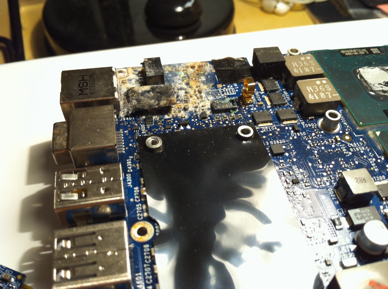

I've been given this MacBook for repair. Someone spilled a drink (she claimed water) in the upper left corner of the keyboard. The machine boots, but the DC inboard is dead, as is half of the keyboard. Went to replace the top case and DC inboard and saw a lot of buildup on the upper left side of the logic board that leads me to believe it was something more than water that was spilled. After replacing both of the parts the Magsafe was still dead and the new keyboard would power on the machine but couldn't type anything, nor did the trackpad work. I put the old keyboard back and it still works... sort of.
Now I've disassembled the whole thing and removed the logic board - I attached a picture of the problem area (top left). Any idea as to how I should clean this? Once again, the DC inboard is the only big problem though I didn't test every port on the left side I/O...
