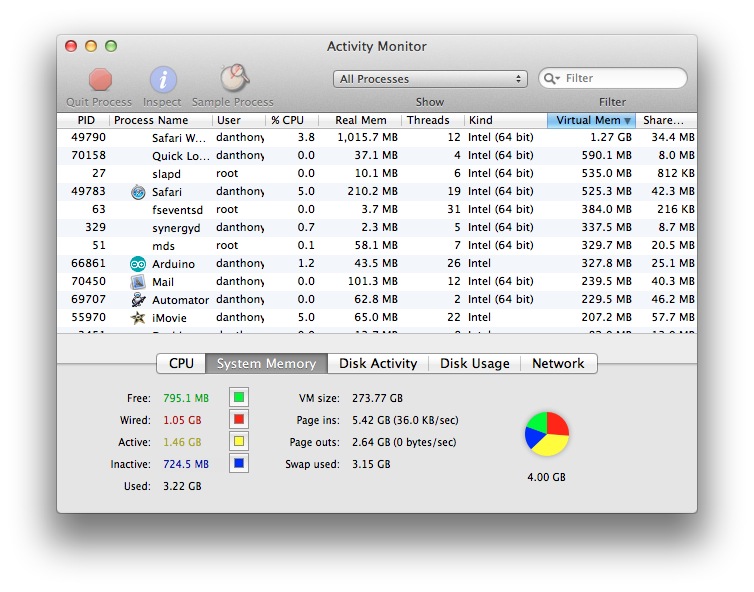

Is it ok for my virtual memory to be 80+ % of my hard drive? Right now my virtual memory is 273 GB Running Lion, 4GB of RAM, 320GB HDD

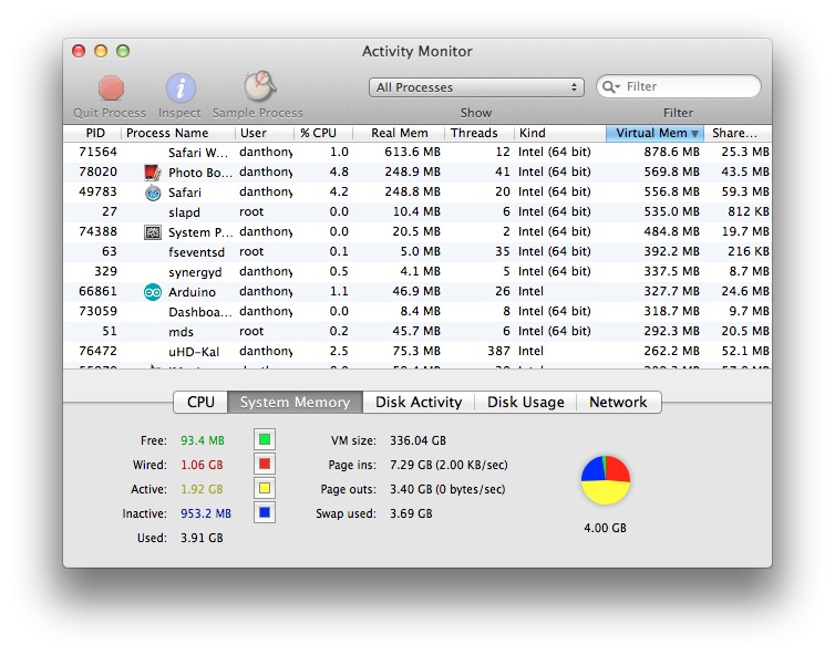

Now it has gone above 330GB. Is there a reason it has gone above 300?
The activity monitor help file (which is seen by clicking the help button in the menu bar) states:
VM size: VM size is the total amount of virtual memory space reserved by the OS X and your apps. The actual amount of virtual memory being used is likely to be much less, because OS X and apps frequently reserve virtual memory space that they don’t use.
My VM is frequently larger than my hard drive.
1. Do you actually have a problem that you have reason to believe is caused by excessive VM?
If not, continue to use your computer normally and don't worry about the numbers.
