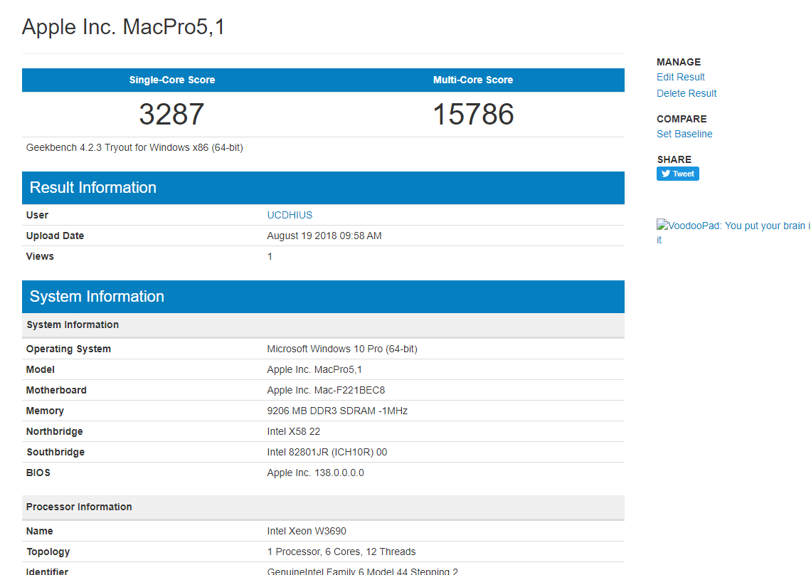

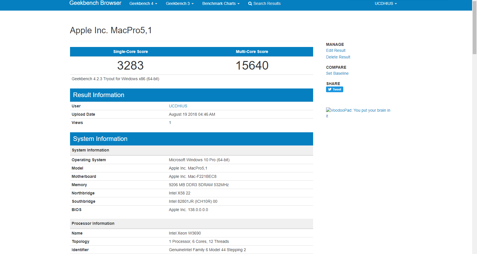

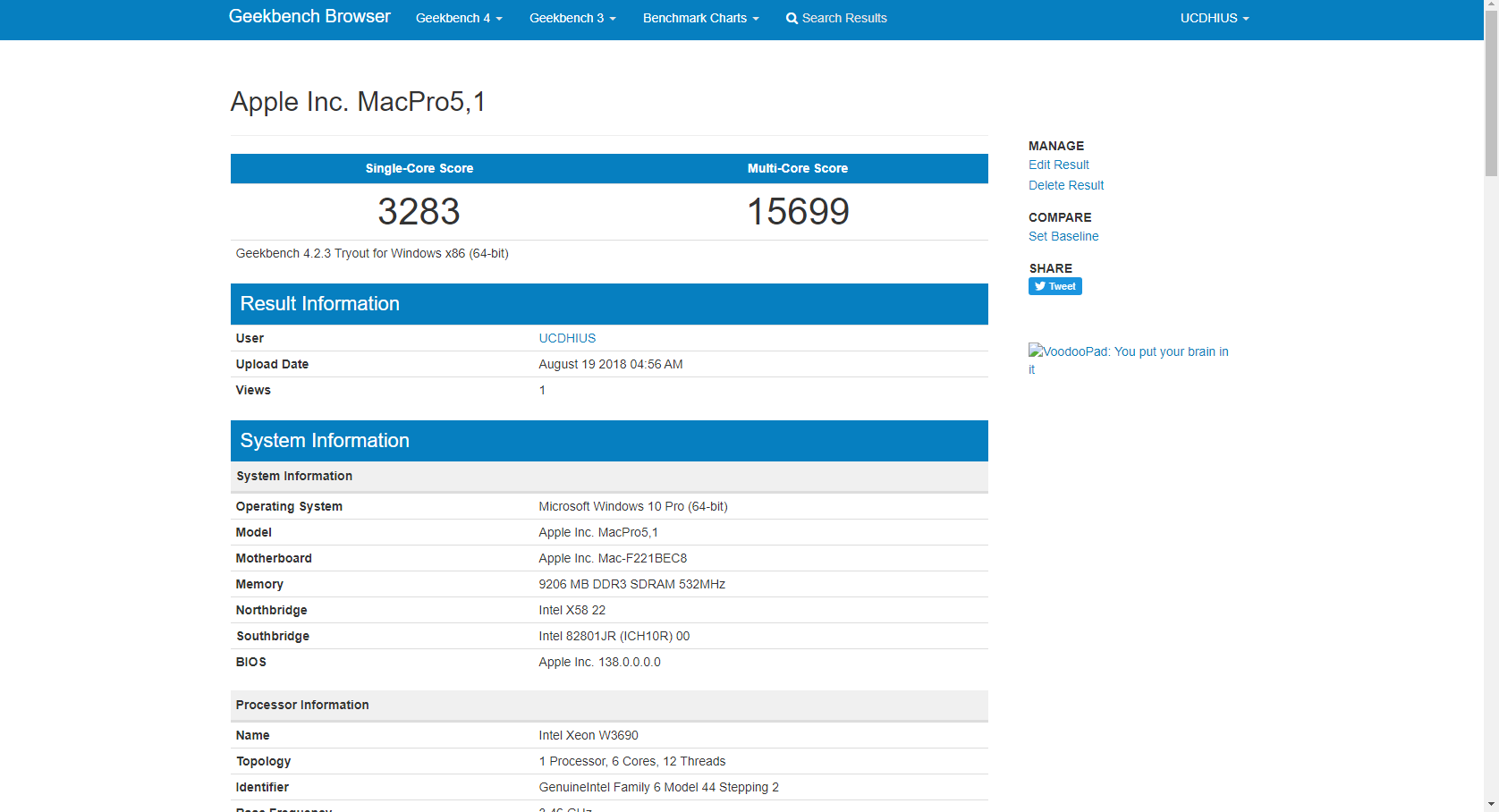

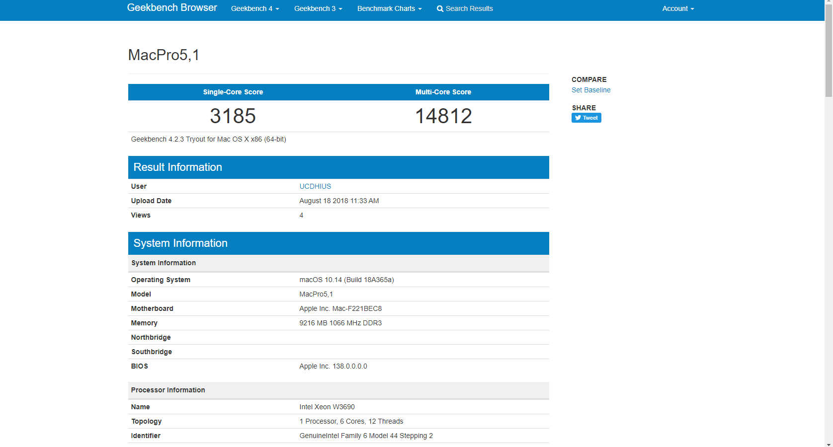

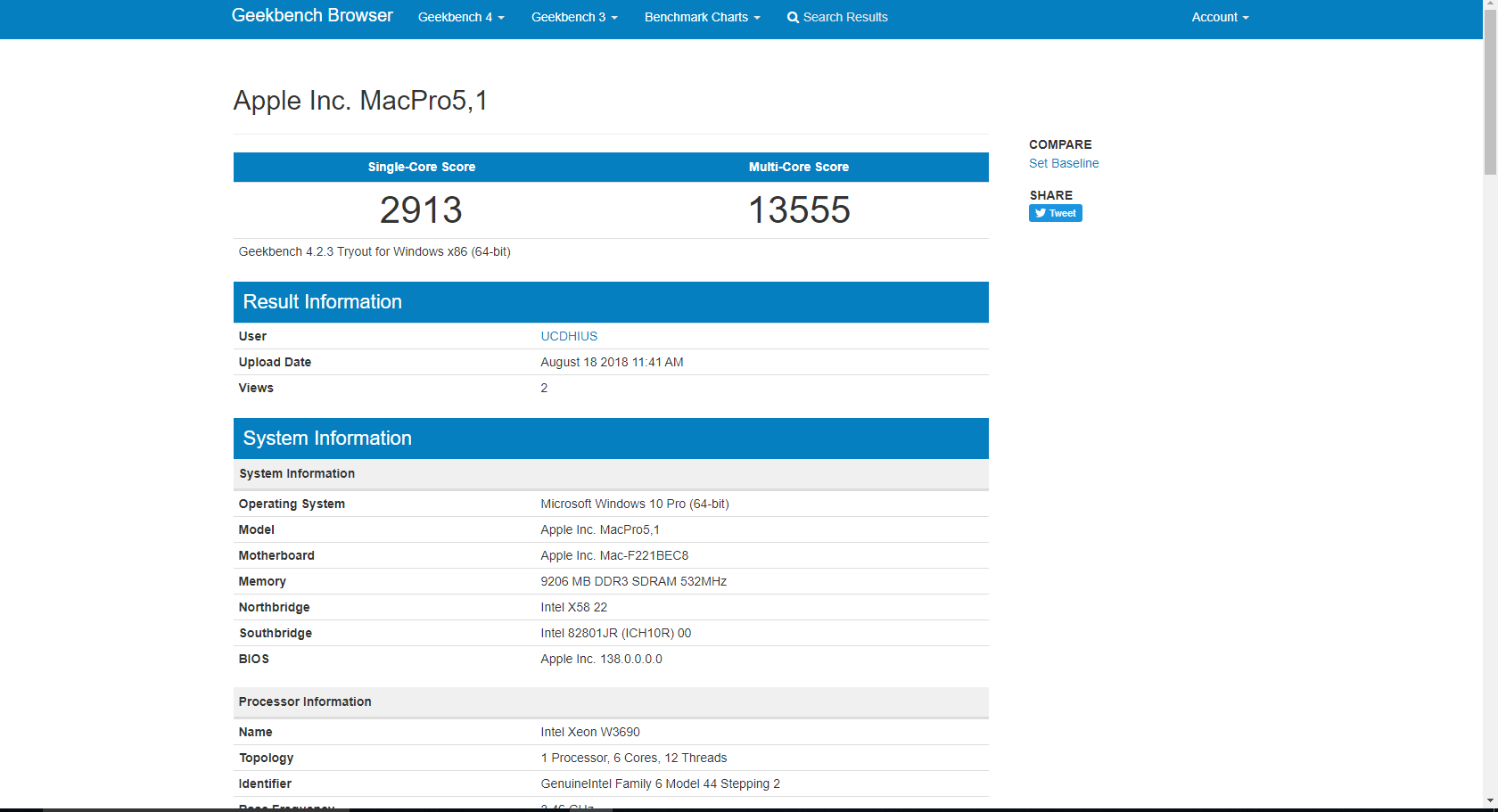

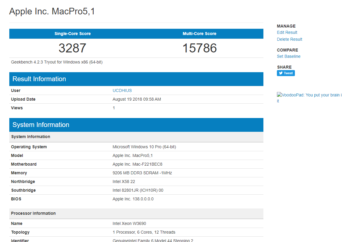

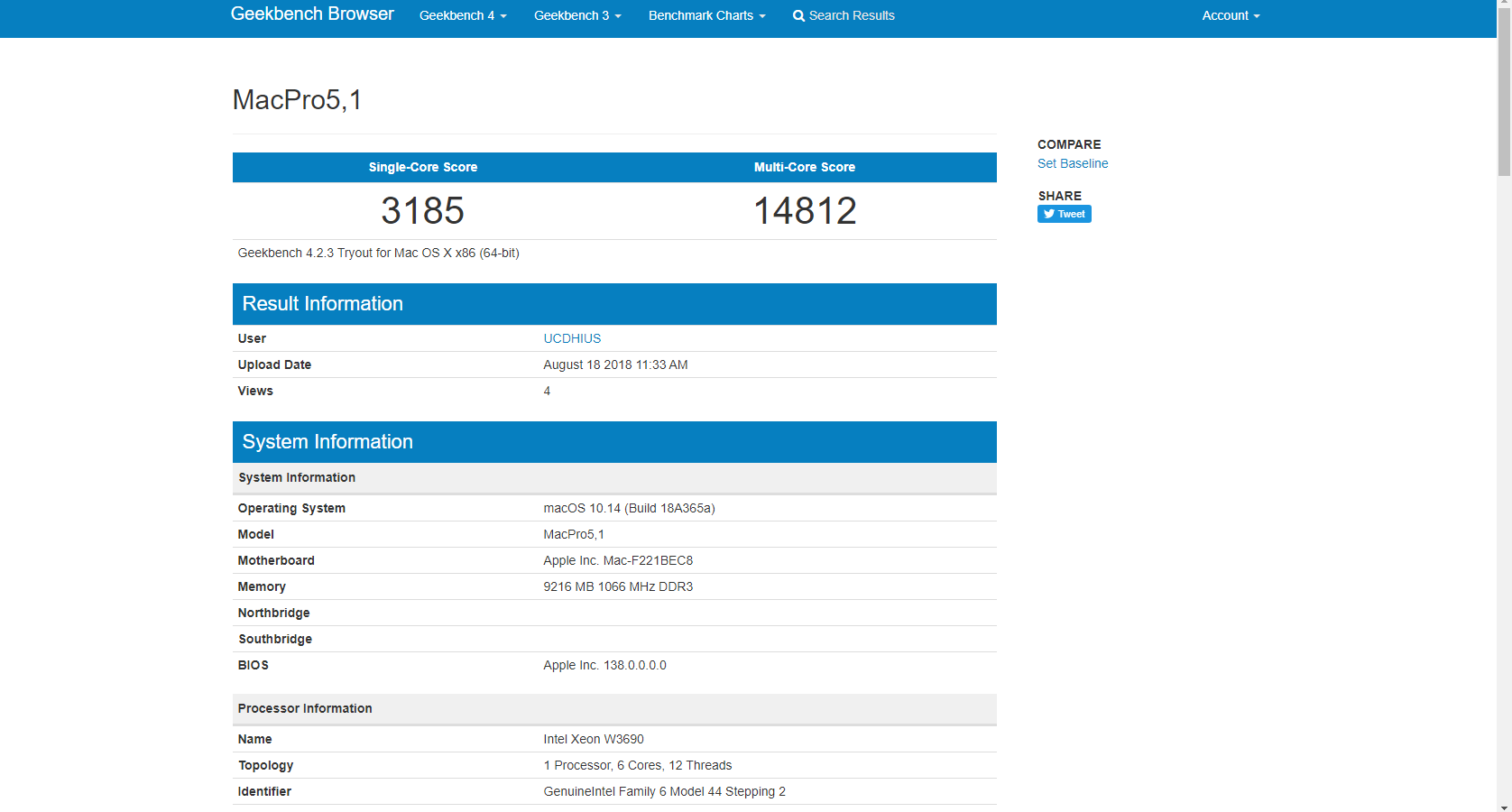

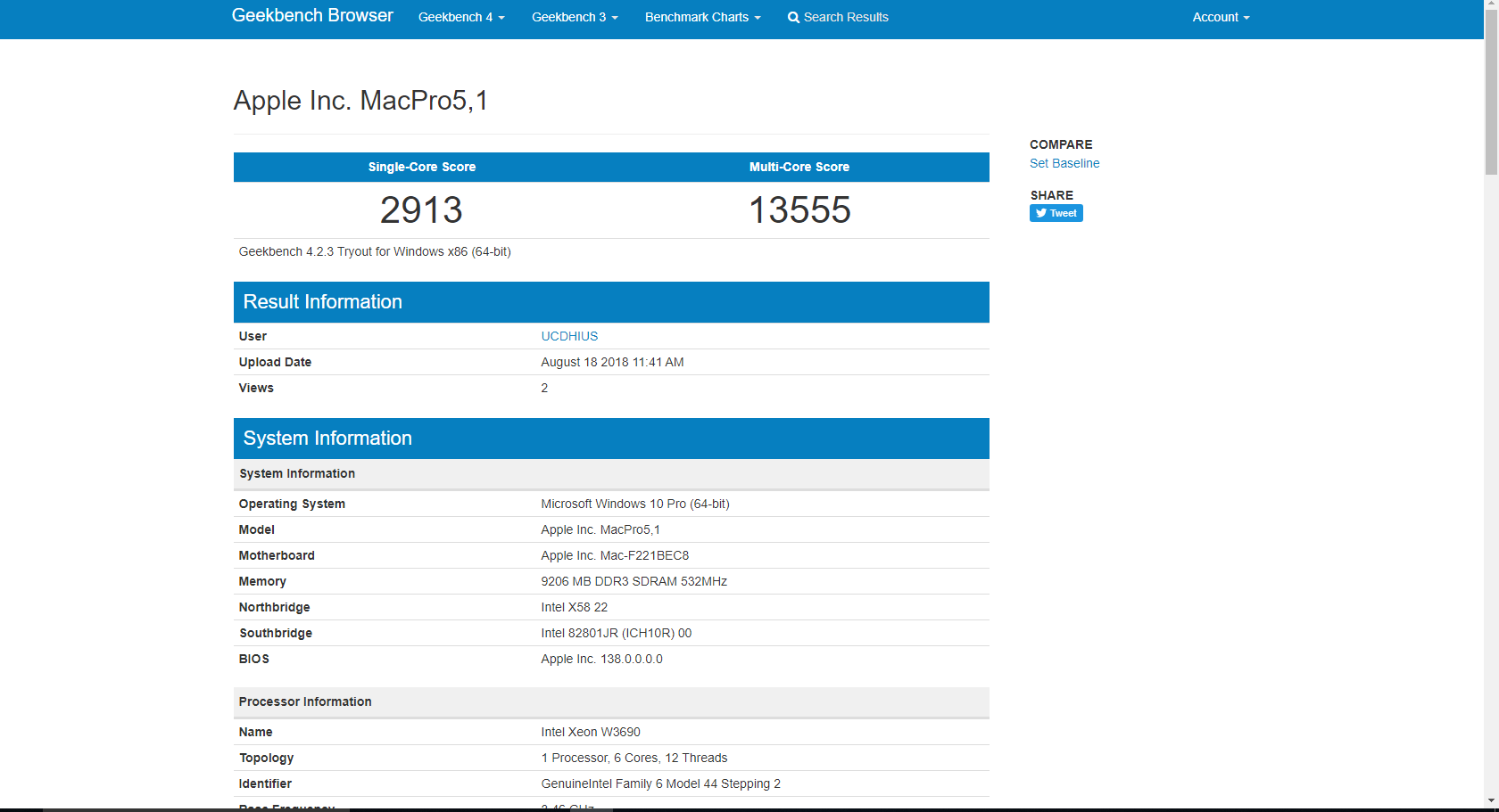

I ran back to back, geekbench tests. "stock speed" in macOS Mojave and in Windows 10.
At stock speed macOS dominates windows
macOS
Windows 10

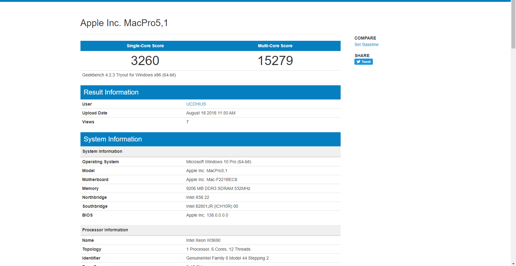

Here comes the "overclock" results in windows of course.

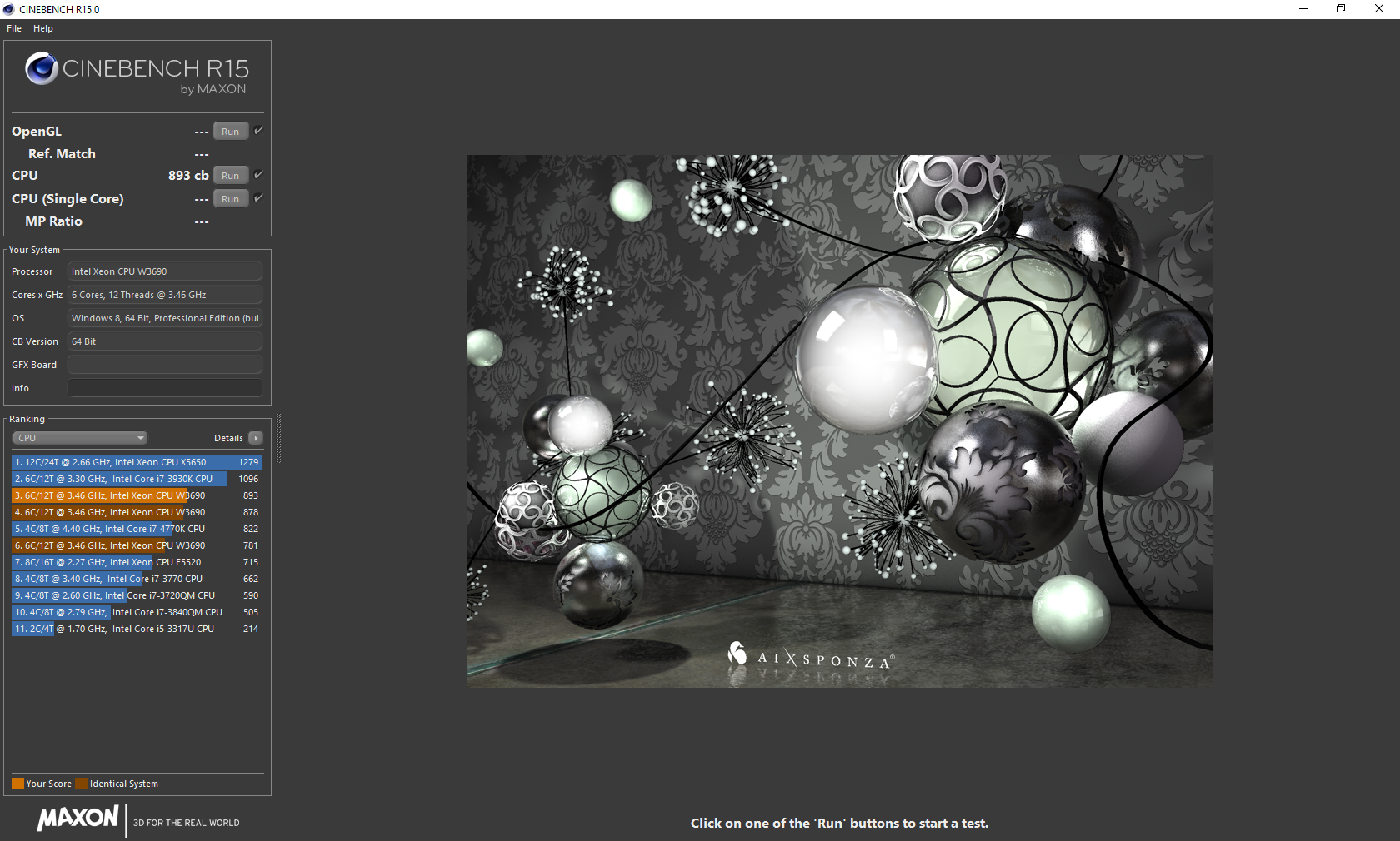

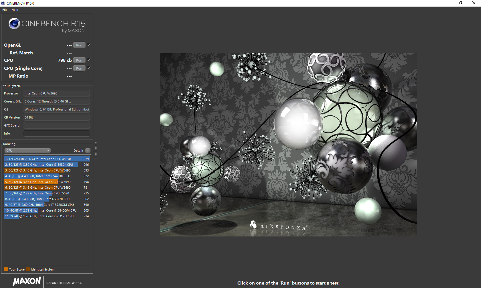

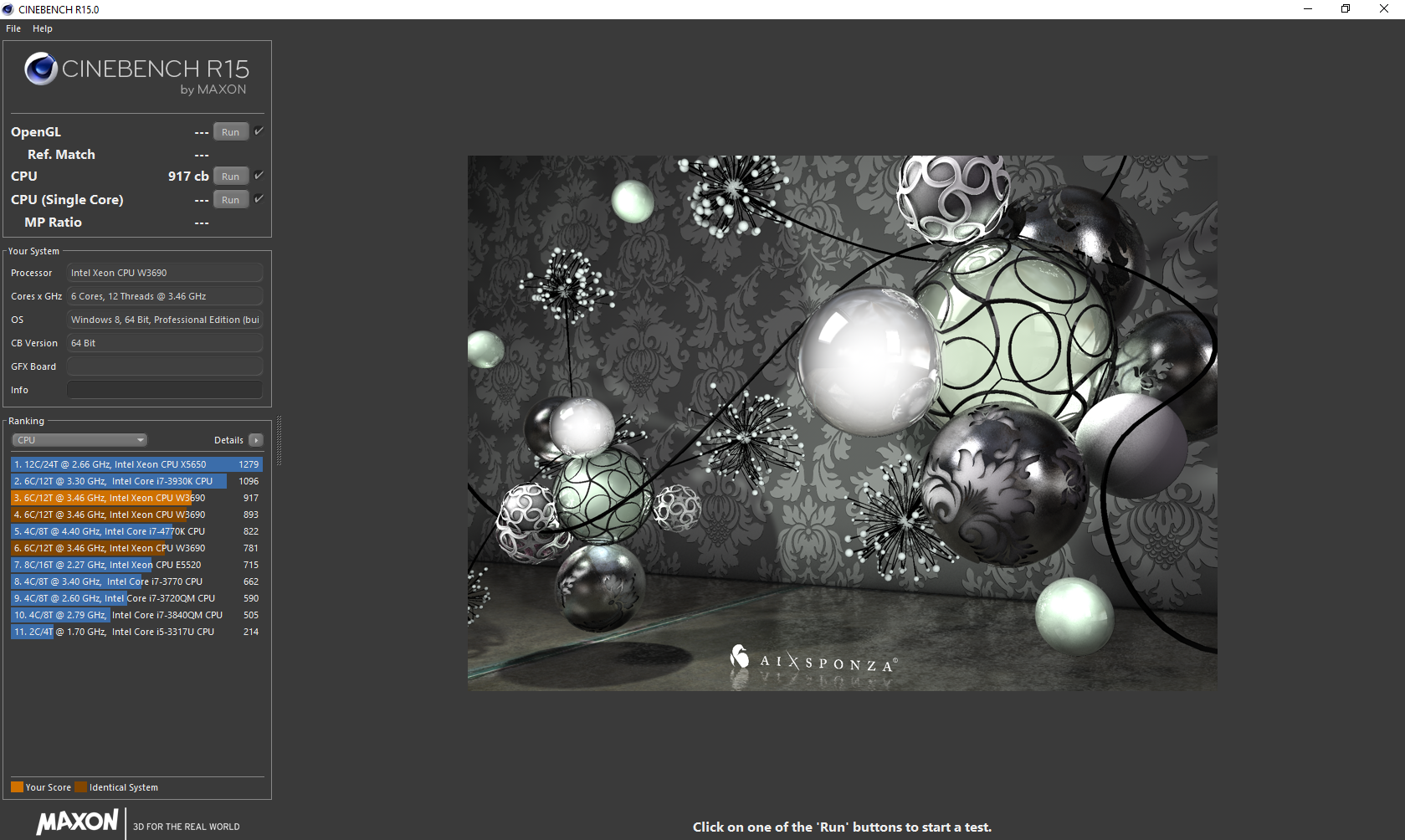

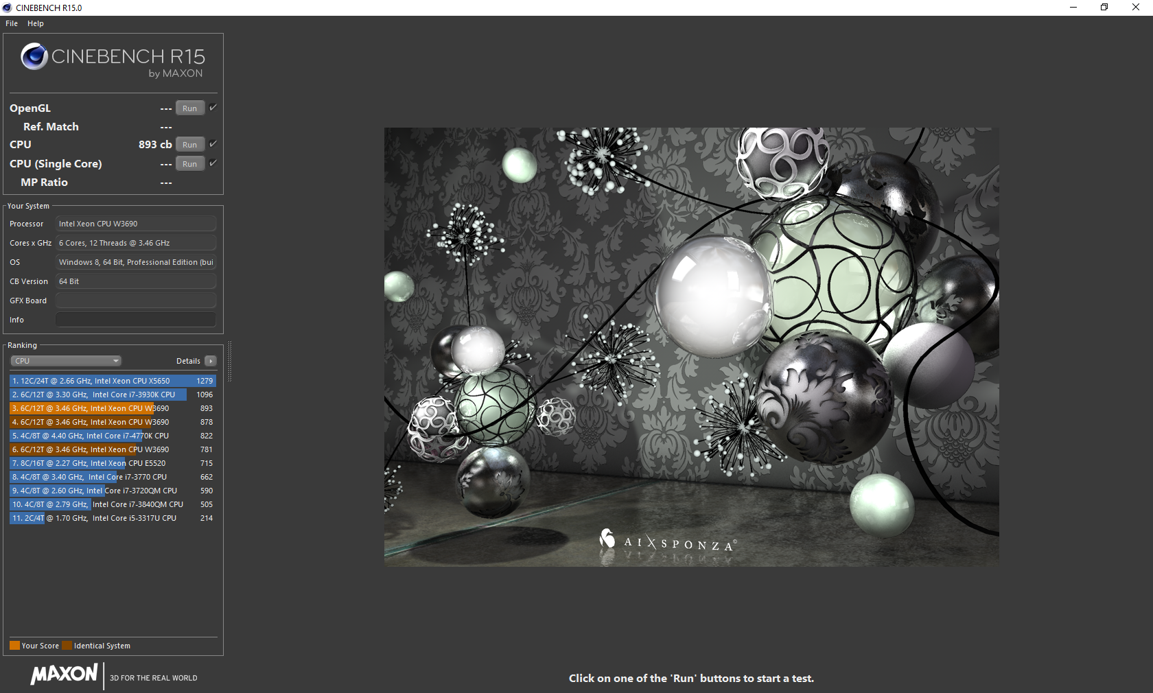

Here is cinebench scores
Cinebench multicore stock (Windows)

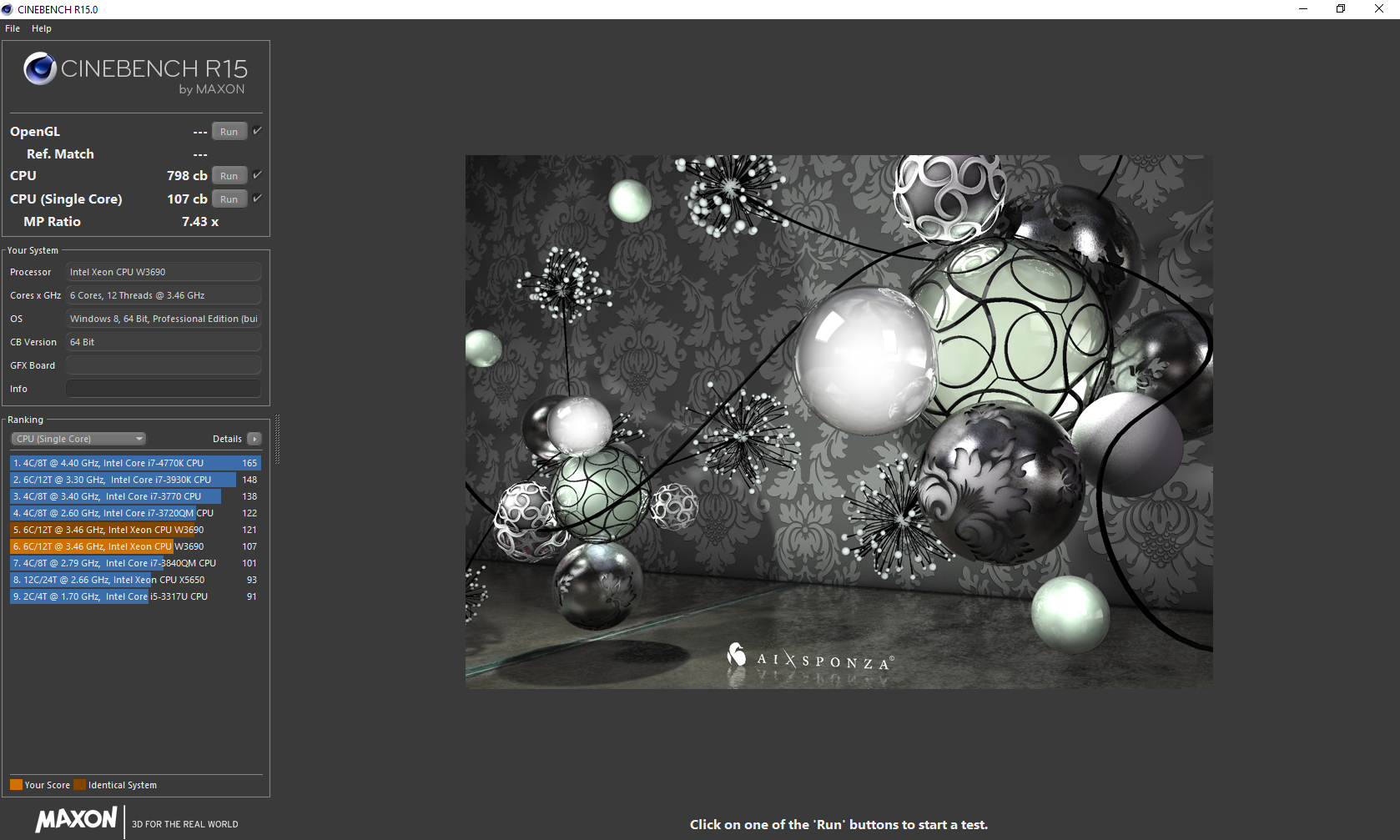

Cinebench single core stock

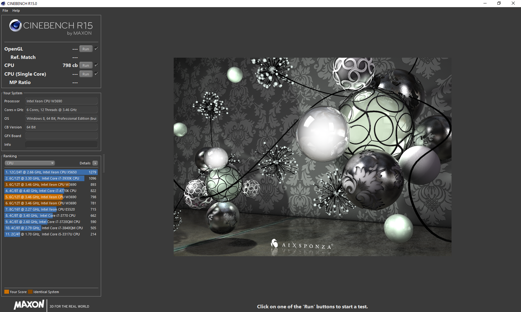

Cinebench multicore "overclock"
Cinebench single core "overclock"

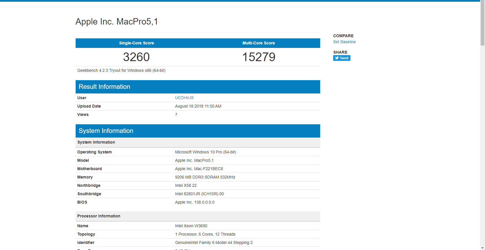

Here are geekbench links for verification
https://browser.geekbench.com/v4/cpu/9469210 (macOS Stock)
https://browser.geekbench.com/v4/cpu/9469295 (Windows 10 Stock)
https://browser.geekbench.com/v4/cpu/9469381 (Windows 10 Overclock)

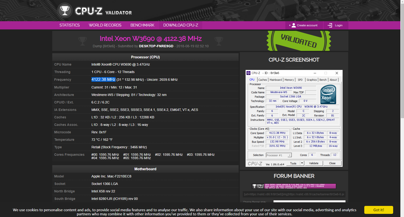

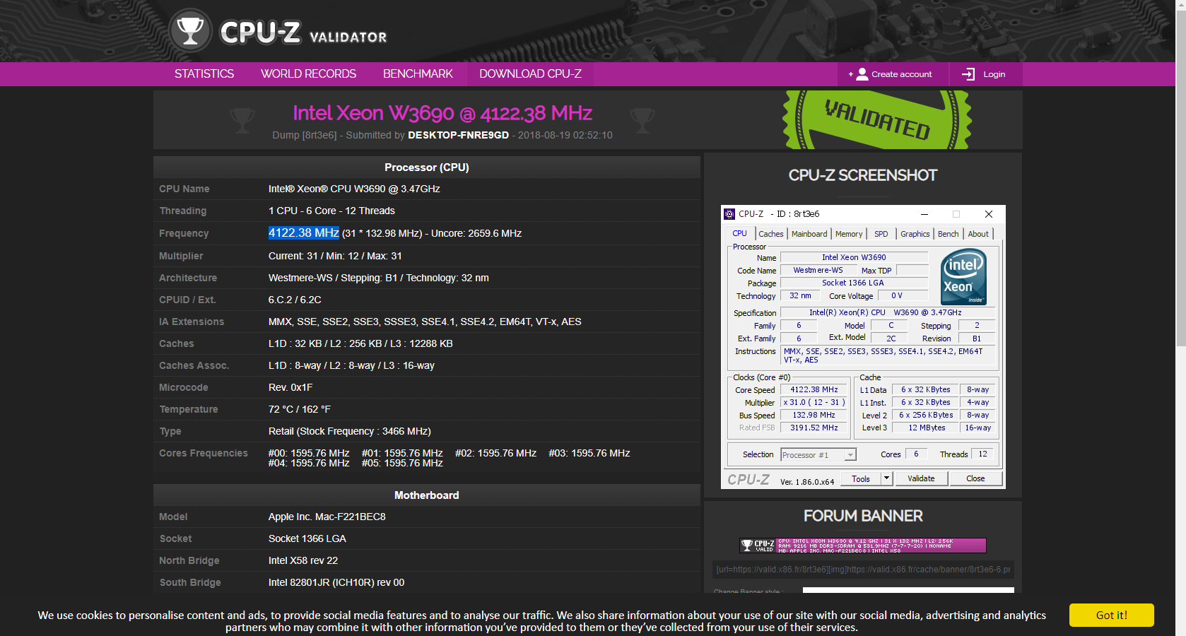

https://valid.x86.fr/8rt3e6 (CPU-Z)
CPU-Z and Intels own app report 4122.38 MHz.
Others I showed the results to are saying its wrong and reported clock speed is cosmetic.. but the scores in (windows) both CB and GB show change and performance increases with the overclock.
Newest cinebench score
It's slowly creeping as tweaking gets refined 🙂

I tried everything I can to OC the CPU with the old firmware. The best I can achieve is the system report higher clock speed, but actual performance shows no noticeable improvement. (But I never use CineBench as CPU performance reference. I only use GB. This may make the difference)
917cb in CineBench is definitely not a W3690 can do at the default clock speed normally in MacOS. I never test this in Windows 10. Not sure if the score algorithm is a bit different. May test that later when I have more time.
But the GB4 result still at the normal range. So, I still doubt if the CPU is really overclocked.

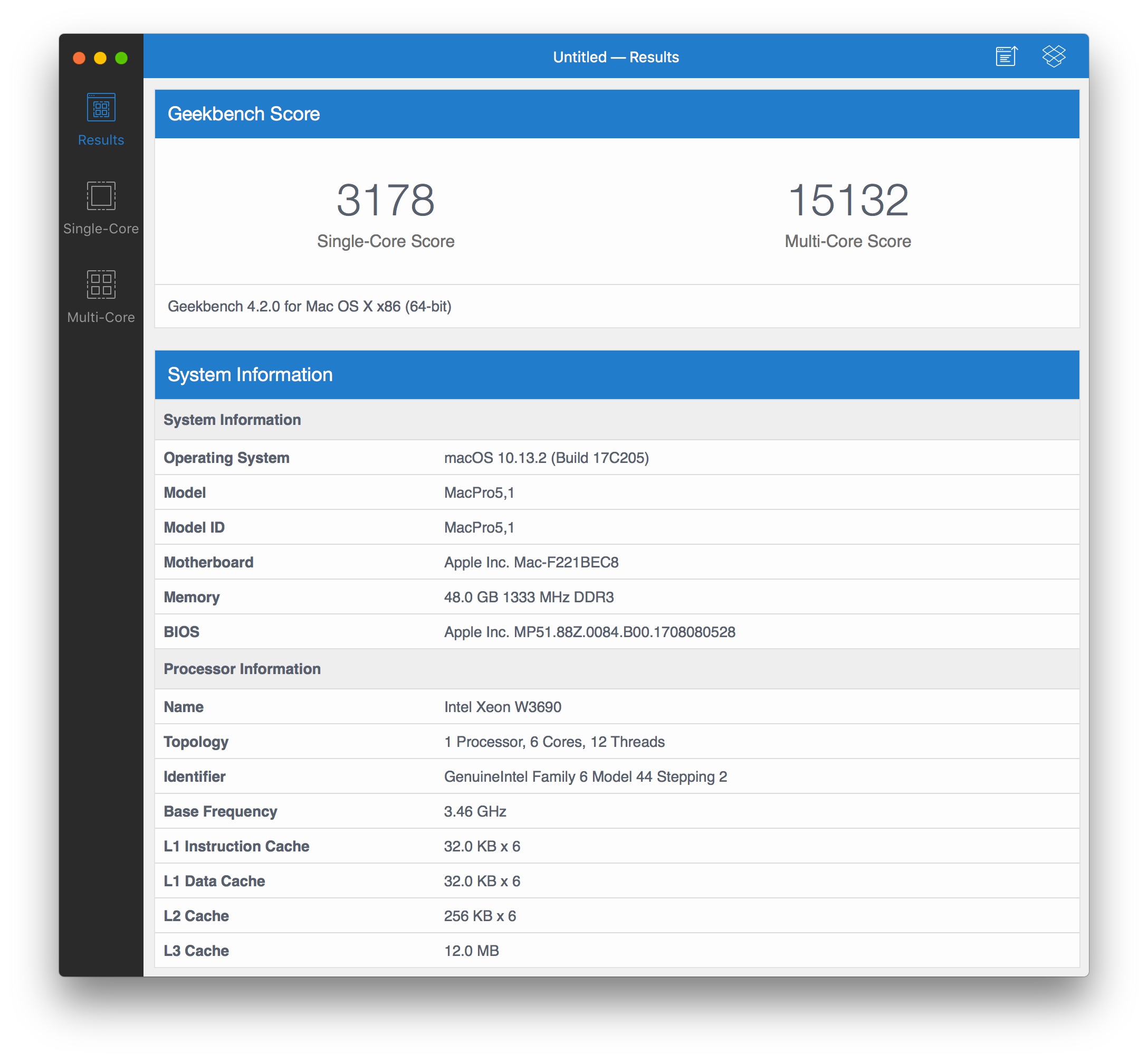

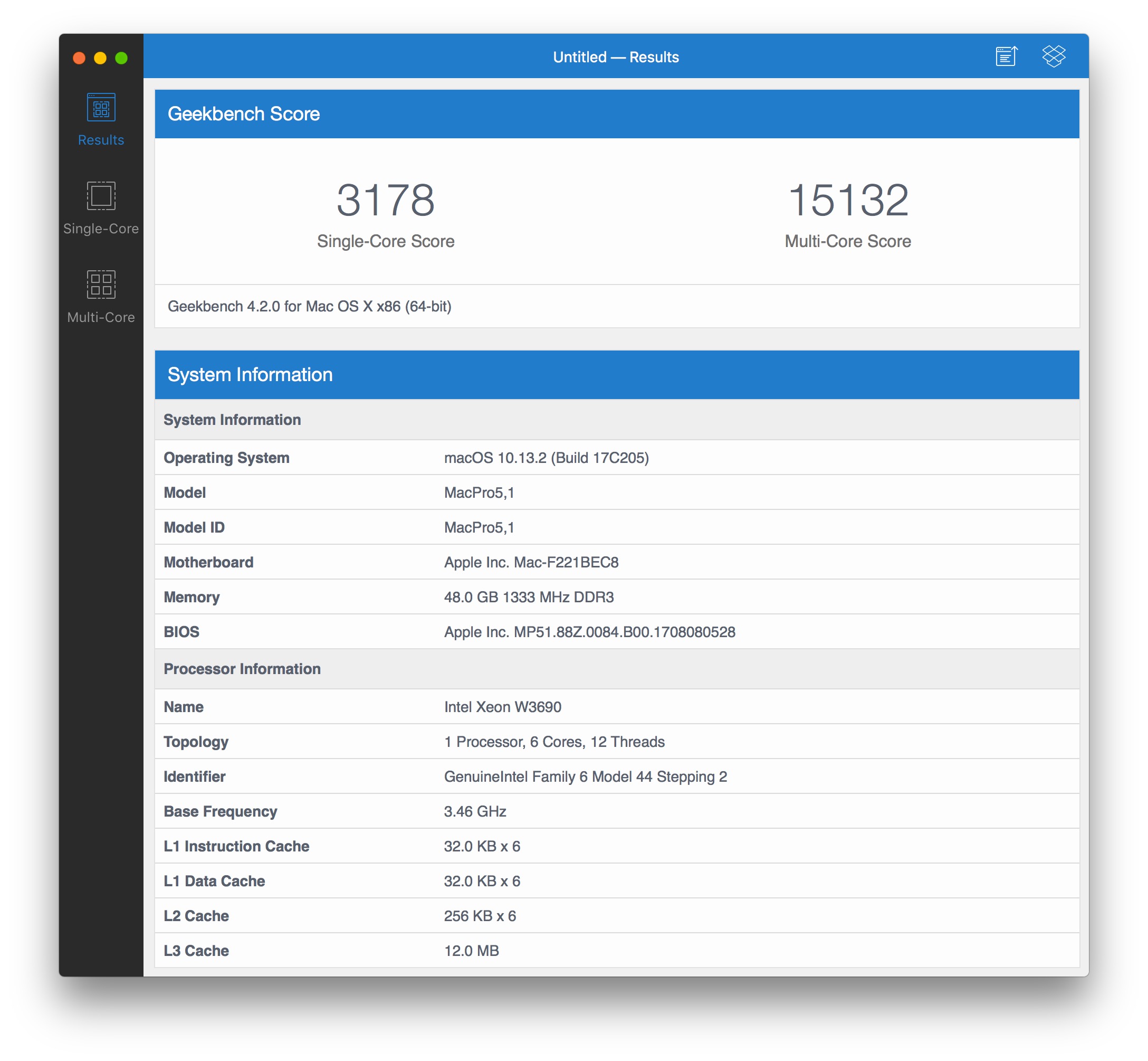

This is what I got with my non OC W3690 some time ago (still with 10.13.2 and 0084.B00). Nothing specially done (e.g. clean installation, or kill every unnecessary process in activity monitor), just run GB4 in macOS. The performance is not that far away from the OCed score which is done in Windows 10 with newer version GB4.
If the real clock is over 4GHz, I will expect a better improvement.

This is the pedal to the metal, multicore is still climbing tweak by tweak
https://browser.geekbench.com/v4/cpu/9481266

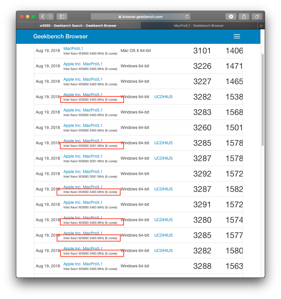

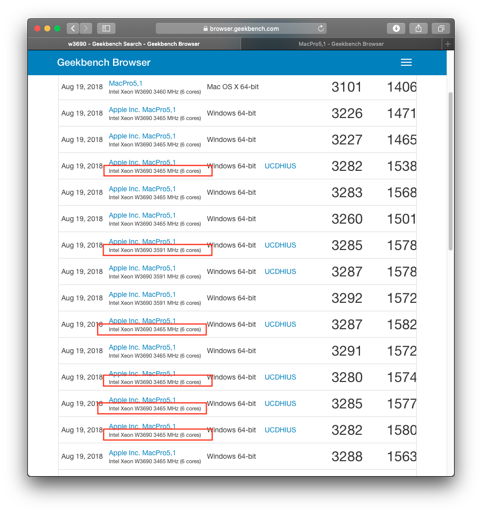

It looks like you are getting a 5 MHz overclock. Pushing the silicon from 3460mhz to 3465mhz. The chip can go much faster without harming the silicon. If you can raise the voltage, it can easily go faster.
😉 I’m hitting 250 MHz it’s blazing fast.
In all seriousness though It’s running a stable 4.1-4.2 GHz though. Some Geekbench says 5MHz some say 8.1 GHz , 6.25 GHz lol.
Sure that’s not really operating at 4.2GHz. Even we compare that to the single core turbo clock 3.73 GHz. 4.2GHz still a 12% OC, and your GB only shows 3% faster than mine.
If that’s compare to the base 3.46GHz, 4.2GHz is a 21% OC. However, your multi cores score is just 4% higher than mine.
So, no matter what you insert, the CPU definitely not running at that speed. Also, I doubt if the voltage is really changed. Again, it’s not that hard for the software to report what we entered. I wonder if hardware monitor can correctly report the CPU operating voltage.

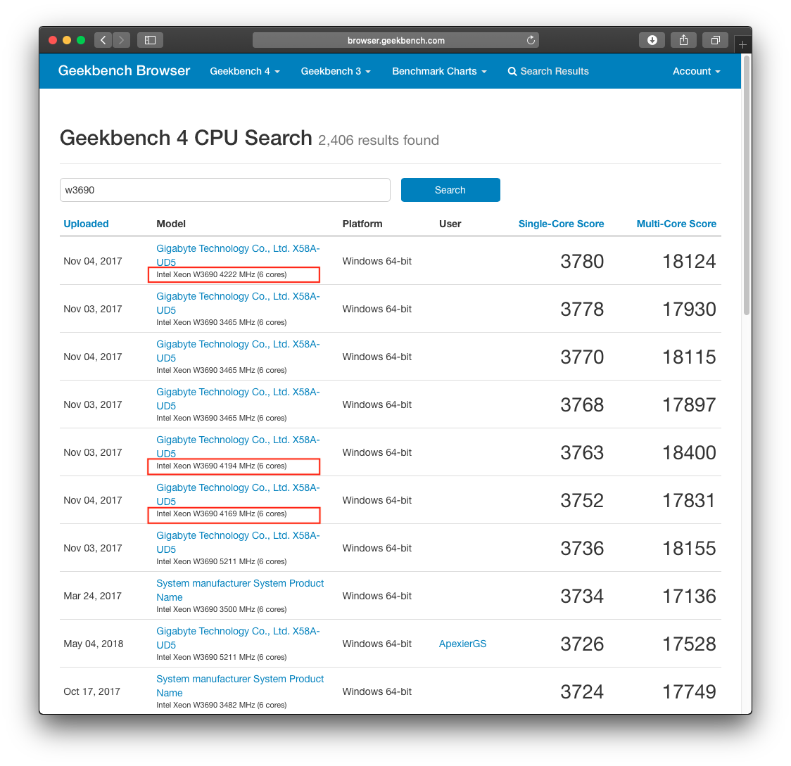

That's not what Geekbench is showing
A Score of 4.1 / 4.2 will deliver a much higher score.
Open Hardware Monitor from Windows display's the speed and temps for all CPU cores. Can you post a screenshot of the clocks and temps from your w3690.
It would also be helpful to see CPU and SPD tabs from CPU-Z.

Nope. Perhaps a misunderstanding of Geekbench results.
Getting info from additional apps will help define what @UCDHIUS is seeing, as there are plenty of referenced results on Geekbench browser.

I have validated CPU -Z links of it running @4.1 GHz in the original post. I can post another if you want.
I made sure to post, it when I first made a the thread.
[doublepost=1534721306][/doublepost]https://valid.x86.fr/8rt3e6

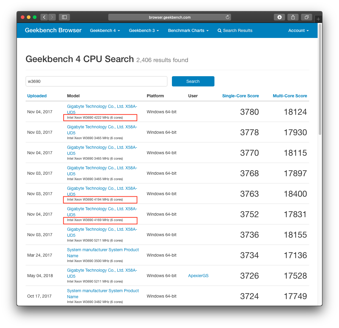

The posts you highlighted that actually show a higher geekbench score are clearly Windows machines that are overclocked. Note the gigabyte brand motherboard.
Plenty of people have OCd these chips with sometimes incredible results. But no one has ever done it on a cMP. Because you need access to a bios that doesn't exist.

Here is a validated link to CPU-Z of it running at 4.1 GHz.
https://valid.x86.fr/8rt3e6 please look at it.

This is the jankiest OC I have ever done, do I recommend do this? Nope.. it’s took me a day and some to get where’s it’s at.
There is so much stuff to get around, to even get to 4.1GHz
I bought the machine with intention to try and see if I could even get over turbo boost and OC it.
At first I couldn’t get it to hold even turbo boost clocks, but I kept on trying.
That’s the reason why I bought 2 more trays and spare parts. (Just Incase it went kaboom)
On the flip side, IF someone else came out of nowhere, I wouldn’t believe it myself ethier.
So I can understand where others are skeptical of this “since I just came out of no where” and said “look at this, look at this, I have a overclocked 4.1/5,1”.
It’s hard to believe yes, as I couldn’t believe it myself at first.
I wouldn’t come on here to macrumors.. just to say “look at me, look at me” to “show off”.
This post/thread wasn’t meant to do that. It was meant to document this “journey” of improvements (if any)
The chip won’t let me go past 4.2GHz stable for extended amount of time. Could it be the chip?, the limited controls that’s available?, the tray, the main board, power supply? Who knows.
[doublepost=1534726178][/doublepost]@handheldgames I missed this part of your post
click on all the links on geekbench, with my name.
Look at the max reported clocks
That’s where I’m getting where “geek bench” says “5MHz, 6.25 GHz, 8GHz etc.” as max reported clocks. It’s inaccurate at best for max reported clock speed.
That was a joke hence the emicon
I see improvements in the software, I use games etc.
Take it for what it, I was honestly shocked my self with limited control that is available.. that I could even take it remomtly close to 4.1 GHz.
I thought I couldn’t even to get it to hold over turbo boost for a extended amount of time.
(At first, It would boost up to 4.1 GHz on 1-3 cores when it hit four or more throttle down to 3.80 GHz.) but I got over that hump.
I’ve been doing this for close to a day straight. I wouldn’t post photoshopped images on here just to say “look at me” “look at me”.
Once I get my 1080Ti back in, (my SFF PSU gave up the ghost.) I’ll do multiple screen recordings.
Temp is a clear indication of something is happening.
89-93C under load. Would you say, that’s “way to hot what are you doing”.
Here’s is the thing I have multiple spare parts. I honestly don’t care if something gave up and when kaboom while I was doing this.
[doublepost=1534723983][/doublepost]This is the jankiest OC I have ever done, do I recommend do this? Nope.. it’s took me a day and some to get where’s it’s at.
