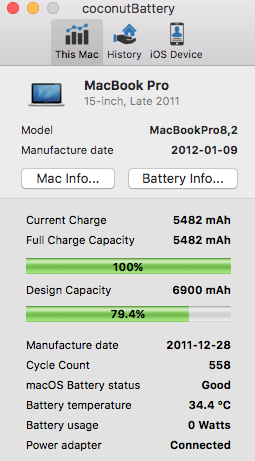

Don't think you know better than the battery control software. Just use it. I leave mine plugged in at home and my 5.5 year old battery is still at 80%.
