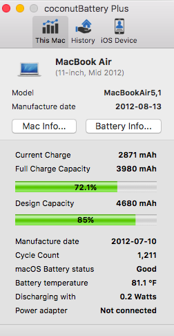

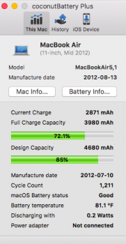

Never let the battery go below 10%. Thats it. Here is my 2012 MBA. 1200+ cycles and still 85% and going strong

But it would not be. I've had enough MacBooks to know that. My current is 5 years old, with 1211 cycles, 85% health. Thats better than "average" but at least double where you are at. If you waited until at least 1000 cycles to start leaving it plugged in all the time, you would have at least gotten your money's worth out of the battery. But now it prematurely "died" from health deterioration. You are 450-500+ cycles behind in health. Like I've said a bunch of times now, batteries must be used or their health degrades early.
