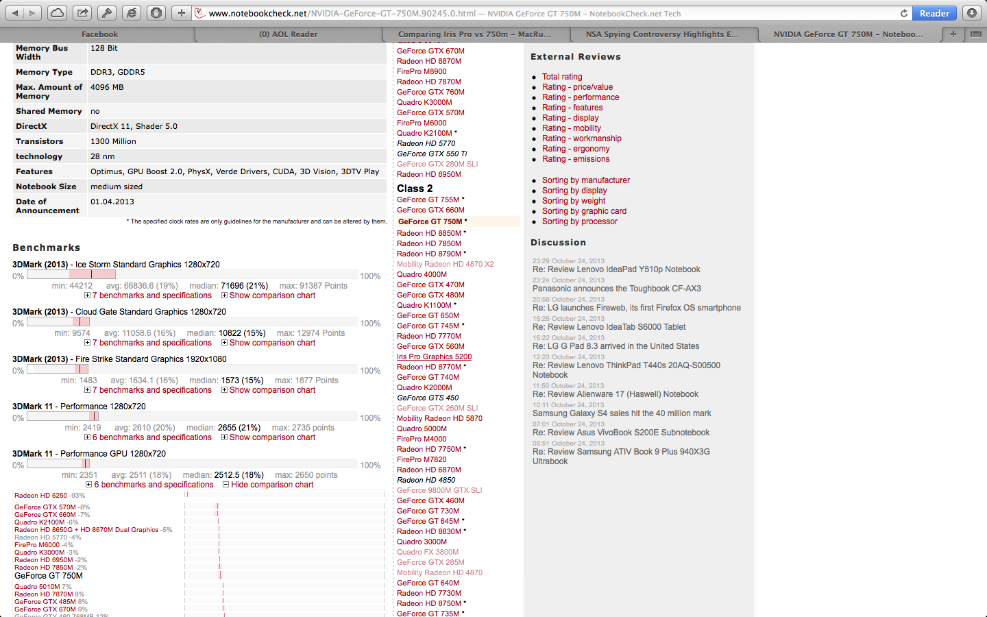

If Intel's GPUs score well in synthetic benchmarks but lag behind in specific games, that would imply that the drivers need optimizing, something NVIDIA and ATI/AMD have been doing for years. It will be interesting to see if Iris benchmarks significantly improve with successive driver releases.
This screenshot shows the 5200 is just below the 650 while the 650 is just below the 750.
I'm not sure whether the new pros use the 5200, I would imagine so though.
This is for more gaming benchmarks, you can review the differences, but it looks like the iris pro isn't that much worse surprisingly.
