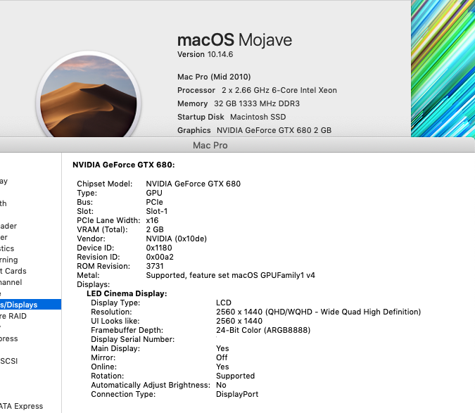

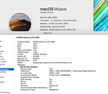

Hi. I recently flashed the ASUS GTX680-2GD5 following the guide Step-by-Step Instructions for Flashing GTX680 by @ActionableMango. The only extra step that I required was to insert nvflash --protectoff before flashing as I could not without. All the ports (DVI, HDMI, Display Port) seemed to work fine on Mojave (with Bootscreen) and Windows.
My issue is that after keep using the card I noticed that sometimes the gray boot screen only appears for half a second just when the chime (POST) sounds. After that, the screen goes black and just come back before the login in Mojave (10.14.6). Just as it would not have boot screen. Nevertheless, if I press the option key, I would get the boot screen and can select the drive and everything works fine. Maybe on the next restart I still have the boot screen without having to press the option key but after some restarts, the gray boot screen only flashes for half a second just at the chime and then again black screen until the login. Weird...
From the functional point of view, it is not an issue as I can still select the drive and the whole boot screen appears if I press option but it is an "annoying" behavior and I really wonder what could be producing it and if possible fix it.
I searched but could not find anyone with this issue.
Already tried resetting PRAM and SMC.

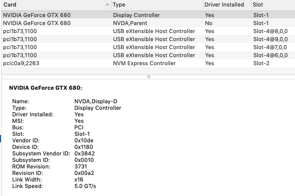

My Mac Pro is a 5,1 with the boot rom 144.0.0.0.0 booting from a NVMe (clean install of Mojave 10.14.6) and the information on the card appears to be fine (ROM 3731, link speed 5 GT/s) (please see attached file). I have it plugged to a 27 inch Cinema Display (mini display port to the display port on the GTX 680).
The only thing that I noticed different is that in my case it says Metal supported MacOS GPUFamily1 v4 and on someone else screenshot I noticed it says v3.
What could be producing this?
Thank you.
Thank you.
HighSierra versus Mojave METAL support.
HighSierra
Code:
Metal:    Supported, feature set macOS GPUFamily1 v3
Mojave
Code:
Metal:    Supported, feature set macOS GPUFamily1 v4
Reactions: h9826790

Thank you for the information.
What could be the reason for the weird behavior at the boot screen that I am randomly having? (on the last restart it did show the gray boot screen normally, it is random). The flashing seems to be correct according to the information displayed on the screenshots.
Any possible solutions/suggestions for fixing it?

I am wondering if I should try to flash it again or according to the rom info displayed it was successful and the situation would not change...
In case of flashing it again, would I have to follow any different step or following the same steps should be ok?
Thank you.

Same steps, no change. To me, seems your problems are related to compatibility of your card to the Mac EFI ROM, the Mac EFI ROM is for eVGA cards and have several degrees of problems with cards that are different. Cards that follow the NVDIA reference design usually work very well, cards that differ have problems.
I read people having some problems with the different ports or adapters in other models . Therefore, before flashing it again I am going to rule out that it is not a problem related to the connection via Display Port or because of the Display port to mini DP adapter.
I have connected it to a second monitor via HDMI and so far, 3 reboots, 3 boot screens without issues on the HDMI monitor.
My card appears on the confirmed list of this post (ASUS GTX680-2GD5) and its configuration seems the same than the original eVGA one but let's see!
Thank you for your help and suggestions. I appreciate.
