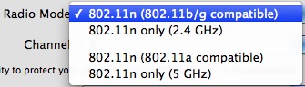

You can set most all routers to operate in a "mixed" mode which allows for both G and N devices.
There is no such option for the AirPort Express, using AirPort Utility:
