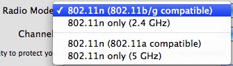

No, the network speed is determined by the slowest device on the network, so both the Dell and the Mac would run at G speed.
No, not true. There will be a speed hit, but by no means will he be operating at G speeds on his wireless N Mac. It was true that wireless G networks that had wireless B devices connect would run at B speeds, but it's not true for N routers. Or at least, not true for the Airport Extreme or Express.
I have personal experience with this. I get about 2MB/s from/to my wife's wireless G MB, while I get 5-8MB/s with my unibody MBP.
There is no such option for the AirPort Express, using AirPort Utility:
What you posted is effectively how to do "mixed" network setup. If you select B/G compatible, B/G enabled devices can connect. If you select N only, only N devices can connect.
You should check your facts:
Note that the network will only be as fast as the slowest device. While Apple TV supports 802.11n, if your computer only supports 802.11b, then the network connection will work at 802.11b speeds.
One of many such references on many sites. This one from:
http://support.apple.com/kb/TA24640?viewlocale=en_US
