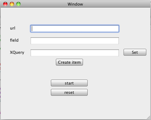

Hello guys,
I am writing a Web scraper APP, First i implemented it and ran it through Console, It works great! but after i tried to make a GUI for that, It does not work.
Application class Called: ScraperApp
Class for GUI called: ScraperCocoaApp
the problem is with method!
Code:
-(IBAction) FieldAndXPathQuery:(id)sender
when i press SET button, it gives the EXC_BAD_ACESS error !
>> To observe the problem just fill the textboxes and press SET.
I appreciate anyone's help, if you just download the the attached project and take a look at that.
Thanks

Thank you for reply,
I did do an analyze, it is successfully! the error happen when i press the "set" button!
How can i turn on compiler warning ? i am using xcode 3.2

Actually i used break point! i was not able to figure out the error. even i placed it insed a try/catch. it even does not give me the reason ... that is why i uploaded the project here, so if u professional guys can find the problem, since morning i have been working on this problem, but still no result 🙁
