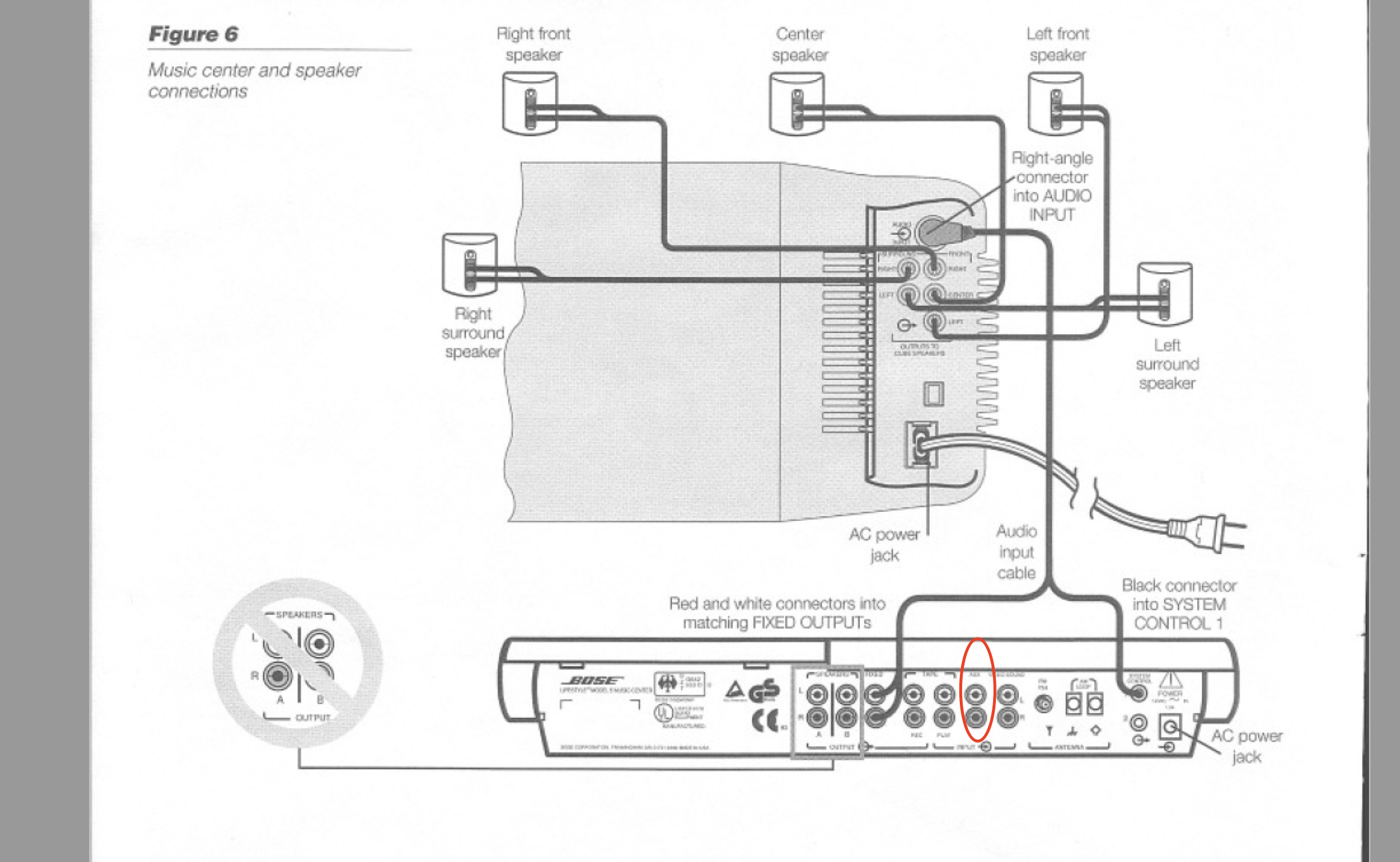

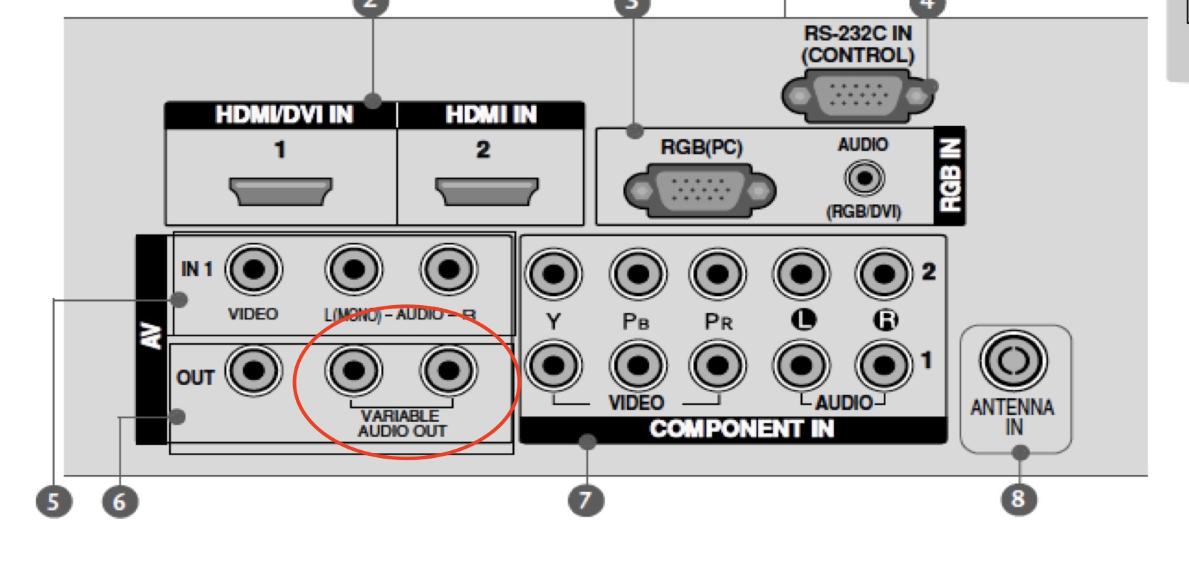

which output exactly I need to use?
see attached image bellow

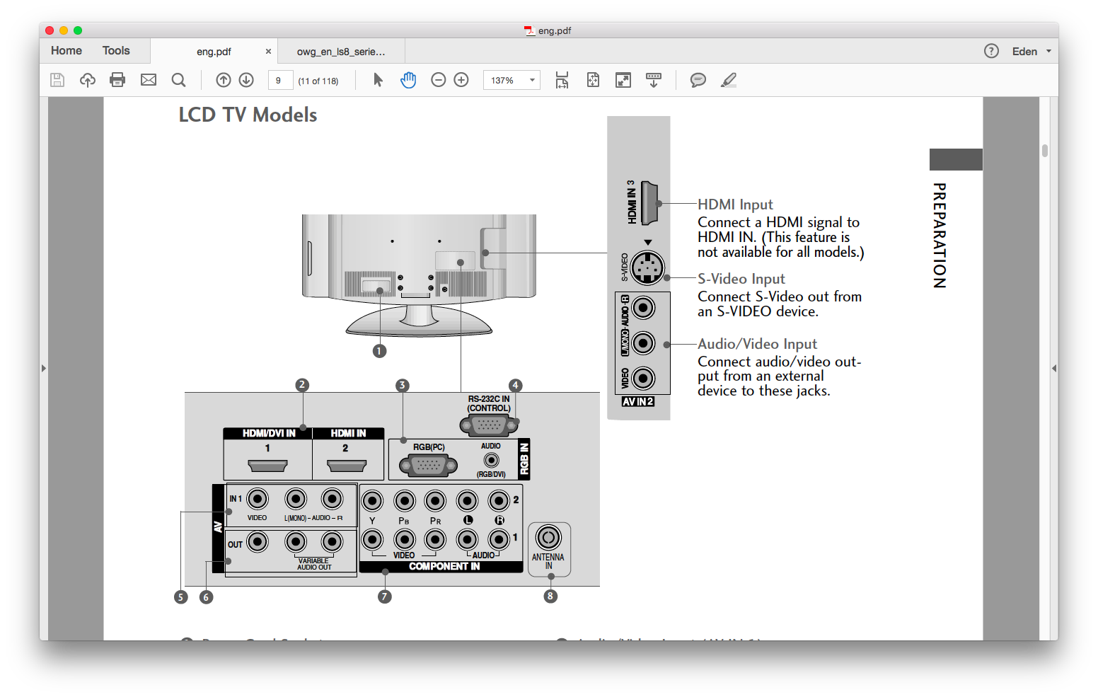

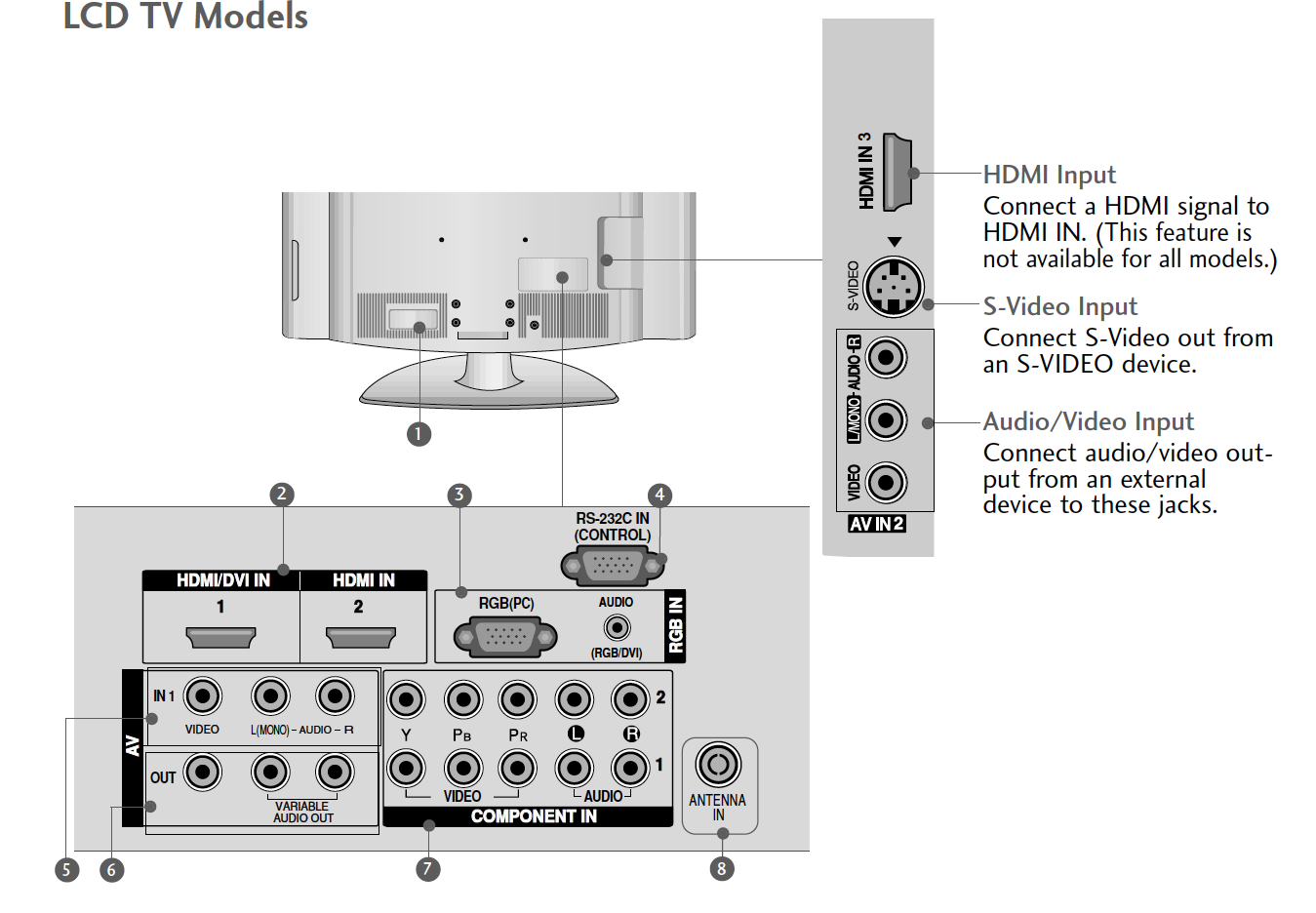

look at #6 in your LG manual to see if that would be the one.
[doublepost=1470165188][/doublepost]by chance are you in Denver? if not bummer.
[doublepost=1470165848][/doublepost]damn, or #7
audio (on right side) to Bose out
again, sorry but it has been awhile
Maybe I am missing it but I do not see an optical connection on your Bose or TV. If you do have them on both units connect an optical between them. If they do not have optical, use rca cables (red & white) between the units.
Not to get you down or anything, but I think it may be about time to retire the old Bose system. I looked up the manual for it on Bose's website and happened to notice this particular model was produced between 1998 and 2000. The thing's going on nearly 20 years old. I even saw a reference to laserdisc in the manual. Best case scenario, you're going to get stereo from your Apple TV and not surround sound.
Looks to me like your only option is to use a stereo RCA cable and connect the TV's variable audio out to one of the Bose's audio inputs. This is assuming of course, that the "variable audio out" does what I think it does.

I don't want to buy a new system. The bose works fine. even if the RCA connection will solve the problem its fine to me. the question is which output from tv (according to the diagram I attached i need to use?) and to which input the bose system?
okay, try this again.
use the red and white cables, plug em in here, red=left
to Bose Aux

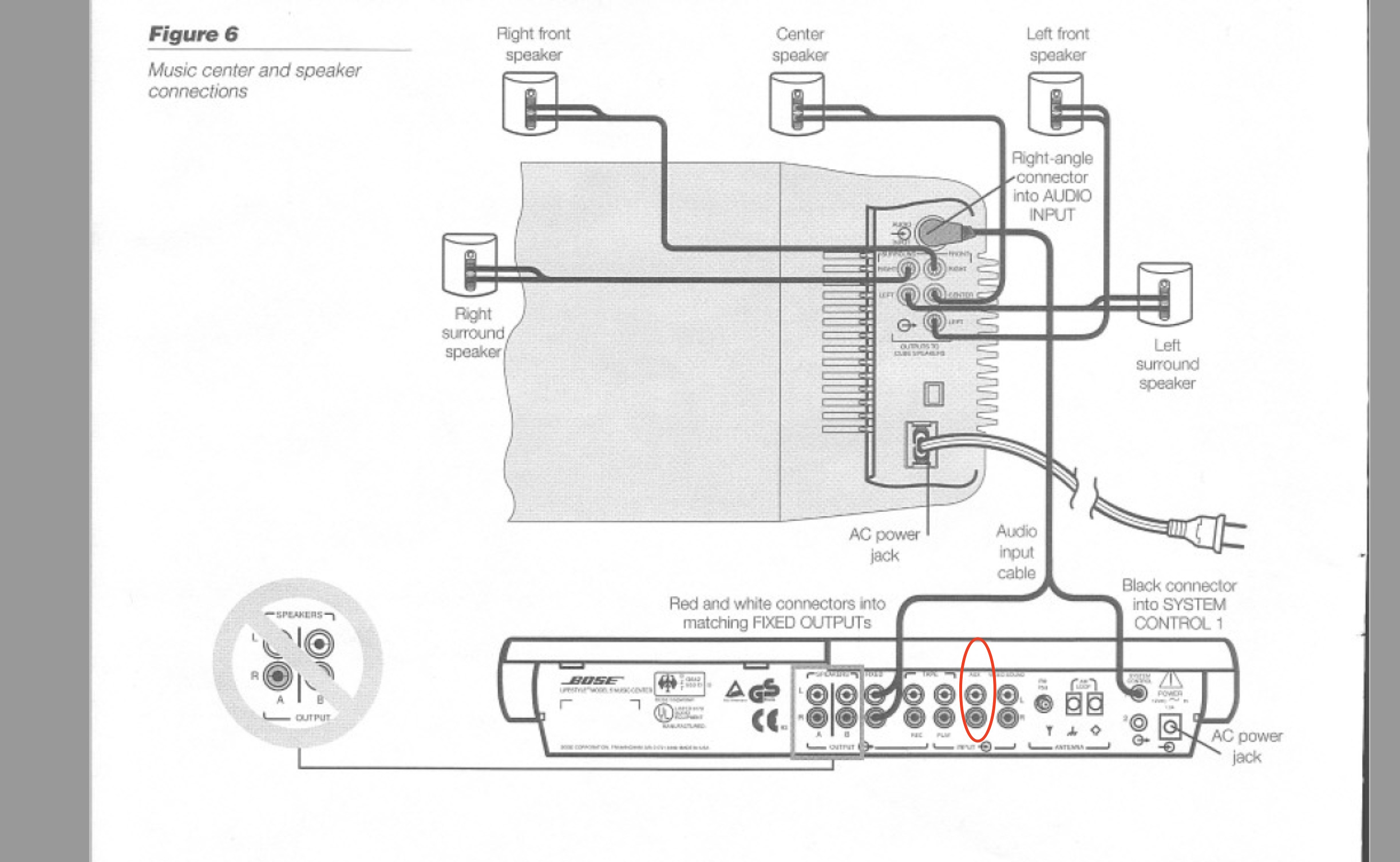

to hear sound from TV, select Aux on Bose

The jacks diagram for the Bose is too small to be certain about what connection for real 5.1 is there: is there at least an optical audio jack IN(put) on that unit? If not, the Bose appears to be creating faux surround by taking stereo audio in and "faking it" by pushing that to the 5 speakers attached. This can work OK but it is not real 5.1 surround (because you are asking technology to guess what sounds should come out of each speaker instead of letting- say- a movie or TV soundtrack send the actual sound intended for each speaker to the correct speaker).

Edit: I went the extra mile and visited the Bose site to try to see a better picture of your connection options. I'm now 99% sure that this Bose system cannot accept any real 5.1 audio input. In other words, I'm practically certain that all "surround" it generates is faux surround instead of the real thing encoded on movie & tv show soundtracks. Thus, I see this as a "room filling" stereo system that happens to have more speakers than it absolutely needs to be a stereo system. I suggest giving more consideration to buying a new system that can deliver real 5.1 surround sound unless you really don't care about that.

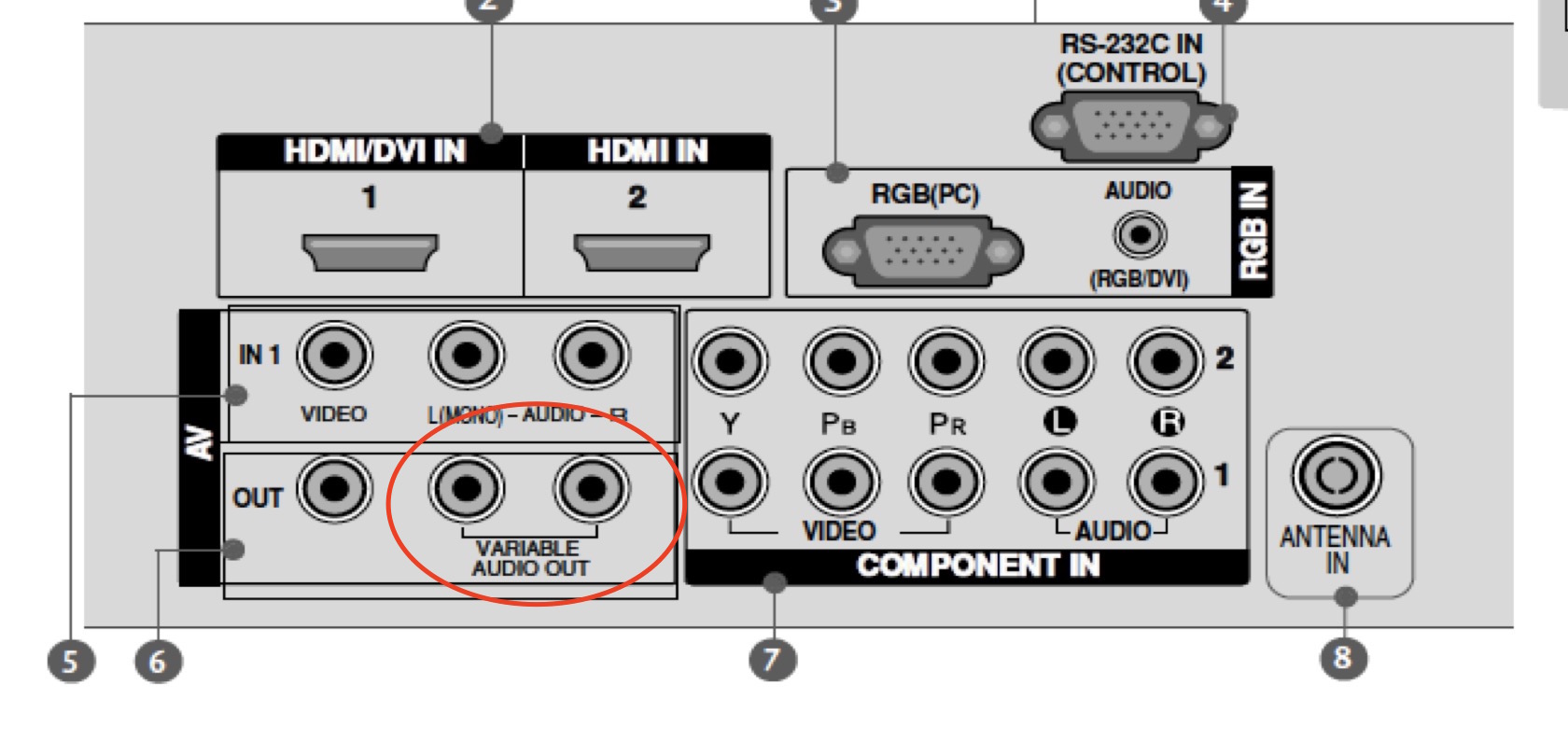

I insert the RCA cable to variable audio out in the TV and to the input aux in the bose system. now its working but I can hear from 1 speaker only

Look at page 83 and 84 of your manual to make sure the variable audio output settings are correct. If they are, then it sounds like one of the output jacks may be damaged. In that case, you're likely SOL since the TV doesn't have an optical audio out. Even then you'd need either an optical-to-analog converter to connect it to the Bose, or a proper receiver.
