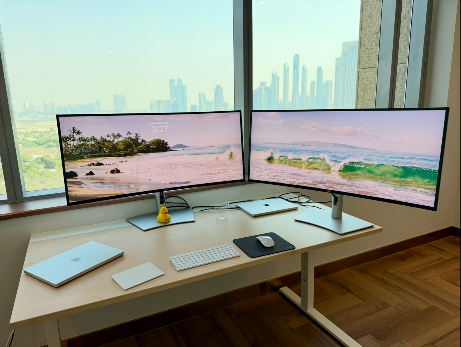

If you commit, please post pictures and screenshots!

Confirmed.
The M4 Pro can only power 2x Dell U4025QW with 5K at 60Hz. The M4 Max can power 2x Dell U4025QW with 5K at 120Hz.
The image quality difference is substantial! I love this setup! 🙂
Very happy with my purchases. Now, the development fun can begin.

I got a Twelve South Book Arc today and my setup looks even better now! 🙂
Also, the better cooling will surely help.
By the way, nobody commented on the rubber duck. I guess not many developers here? 😉
