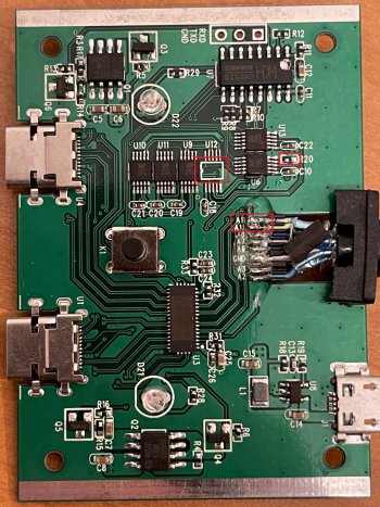

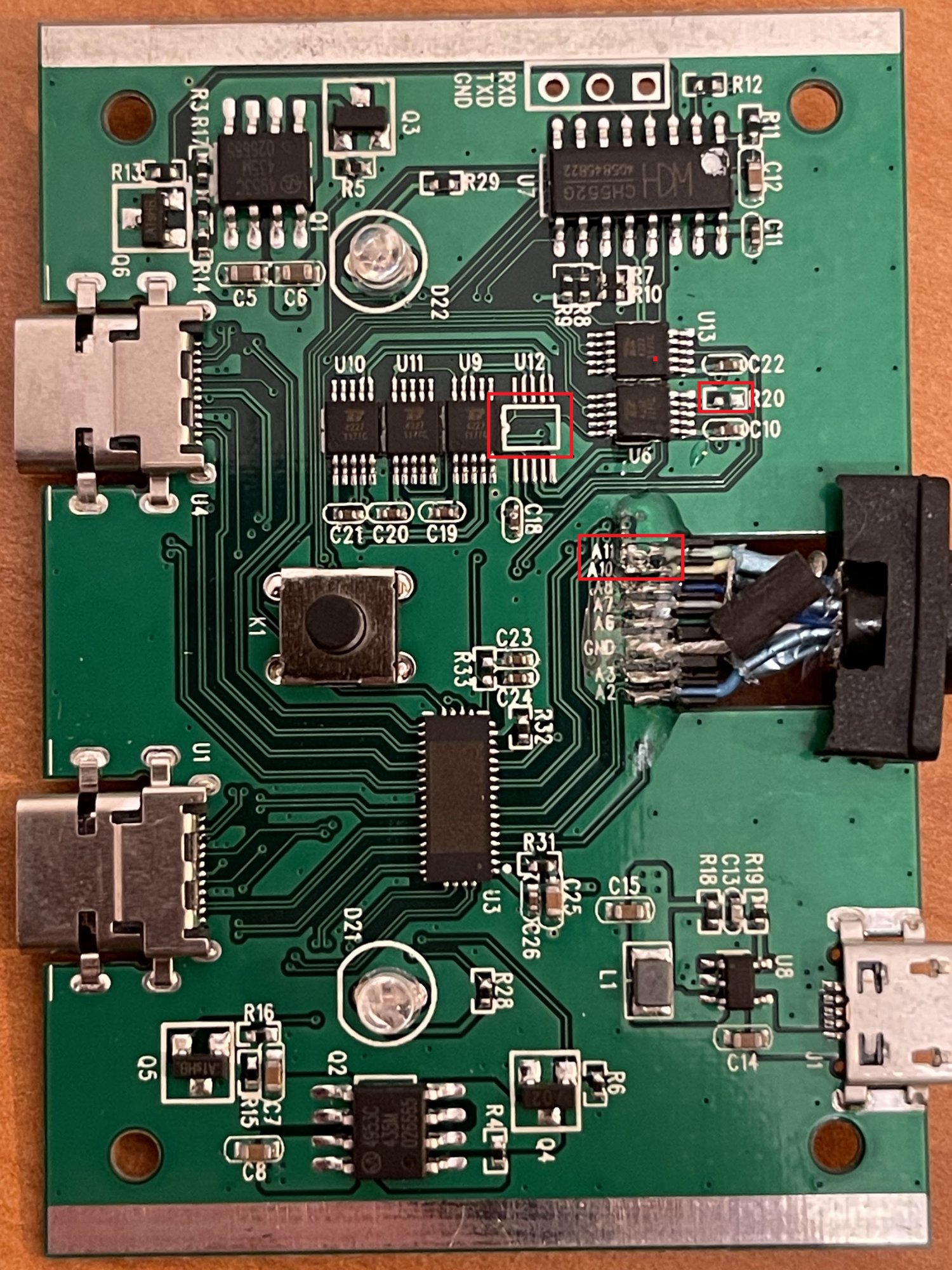

Here are my two cents. I recently bought the CableDeconn USB-C switch, but unfortunately, it doesn't even power on. The diode does not light up when I connect a micro USB cable to the device.
Probably nothing is wrong with the product itself and it will probably work with the XDR display.
But I got some defective unit.
I watched a YouTube video where the Cabledeconn was supposed to light up and allow for USB-C input switching, even when USB-C cables weren't connected.
To investigate further, I disassembled the switch. I removed the black stickers on the sides and four screws. I'm wondering if there might be a short circuit between the A10 and A11 lines, and two components on the board are missing. 😀😀😀
