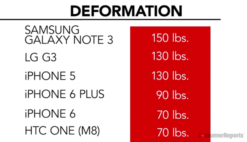

OK Mr. Nitpicker, then the iPhone 6 AND the HTC One (M8) are BOTH at the bottom of the list. You must be in marketing or in politics because people like you are excellent at twisting a meaning. See you could have said the iPhone 6 and the HTC are both at the bottom of the list, however, you didn't say that. So your response was factually incorrect based on the bottom of the list meaning the phones in the test that received the worst score.
So to be clear, the bottom of the list means the phones in the test with the worst score!

Ok Mr. Reading challenged person, I am talking about the Deformation chart prepared by Consumer Reports and displayed at the end of their video. This is what scientific testers call “A Summarization of Related Facts”. In the case of Consumer Reports, as with all professional testing labs, to eliminate subjective interpretation of the results, they summarized their results, in writing, with a Deformation force chart at the end of their video.
I will be happy to lend you some reading classes and a hot cup of tea whilst you read the chart.

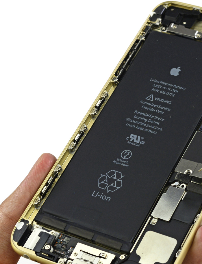

Here's a summary of the design flaw as I see it:
Here is the weak point as viewed externally.
From iFixit's teardown, here are the internal reenforcements.
Note that Apple chose to use a series of short steel plates in lieu of a single continuous steel plate. Had they chose the latter, the phone would not have pivot points at the ends of each plate. The meager reenforcements are "good enough," save a few cents, and make for a slightly lighter phone. A continuous steel angle or I-beam could have been used without altering the size of the phone and would have resulted in a virtually unbendable device. They probably used a formula to predict the cost of iPhone replacements vs. increased manufacturing costs, yet Apple's reputation was not factored in. It's a typical American business mistake - even Apple is not immune.
As a result of Apple's flawed design (under a test that doesn't even exploit the weak discontinuity at the volume buttons), the competition is about 150% more resistant to bending:

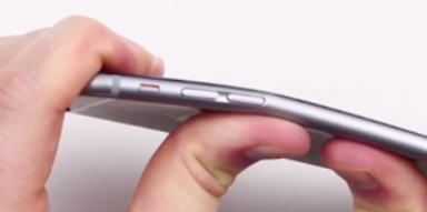

Those youtube videos are crap. You can see peoples hands shaking due to the amount of force they're having to use. Smack anything hard enough and it will break.

That's only from the the distributed load test, which has its flaw that the force is DISTRUSTED.
What was not tested is specific weak areas, such around the buttons, which is where we are seeing most of the bending and wrapping happening.
That zone was also where iPhone 6 failed first in there distributed test. How much force will take if the force is focused at that point? The Consumer Report test didn't examine that.
