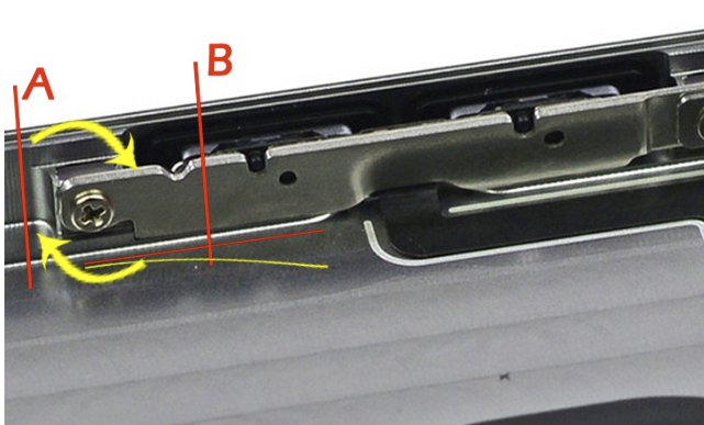

The mounting point of the reinforcement plate is improperly designed. As a result, iPhones bend when carried in pants pockets.
If that reinforcement plate had been slightly longer and mounted in a way the preventing it from pivoting, this entire thread would not exist.
If that reinforcement plate had been slightly longer and mounted in a way so that it could not pivot, this entire thread would not exist.

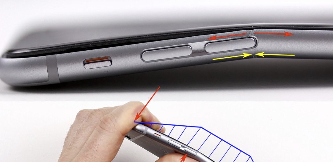

My question is, what kind of real life situations would apply 70 (or 90) pounds of force. How common would it be for a phone to be subjected to that. Can a tight pocket / hip crease apply that much force or more? Clearly you can apply that much force with your bare hands (as the original viral bend gate video showed). It's interesting to know how the phone stands up against other phones in a more scientific experiment that some dude trying to bend a phone with his hands (including the much strong iPhone 5)... but it would be more helpful to have some real world examples of exactly what 70 or 90 pounds of force means.

There's no doubt that Apple could have made the new iPhone more durable by engineering it differently, be that with more thickness, different internal construction, or whatever. Whether they need to address this now and what, if anything, they need to do about it remains to be determined. We still don't know what percentage of iPhones will deform when carried in pants pockets or whether the ones that bend are somehow different from others off the assembly line.
