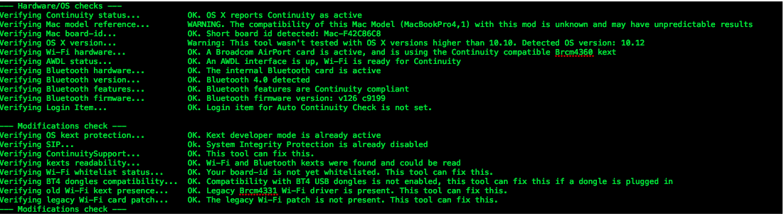

2008 MacBook Pro 17" (4,1) here, running PB6 (latest iOS and WatchOS betas).
Do we have documentation on the actions that the CAT tool is doing for all of the options?
I'd like to try manually changing the items that yet need to be repaired (last time I forced CAT to apply, disregarding the compatibility check my BT and wifi drivers were hosed and had to restore my kexts).
Current state of the system:
I tried some of the manual steps provided in the Yosemite thread (noted earlier in this thread), but the whitelisting seems to have changed for Sierra.
Let me know, thanks!
Edit: Amazingly, through all of my messing around, it just worked. 🙂. (I have a problem with my IOBluetoothFamily.kext - system report says it isn't signed properly, so need to fix that, but the Apple Watch just unlocked the lock screen) 🙂. So, at least now we know it's possible on this system (if you beat your head against the wall enough) 😉
