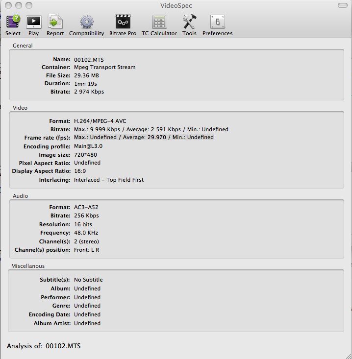

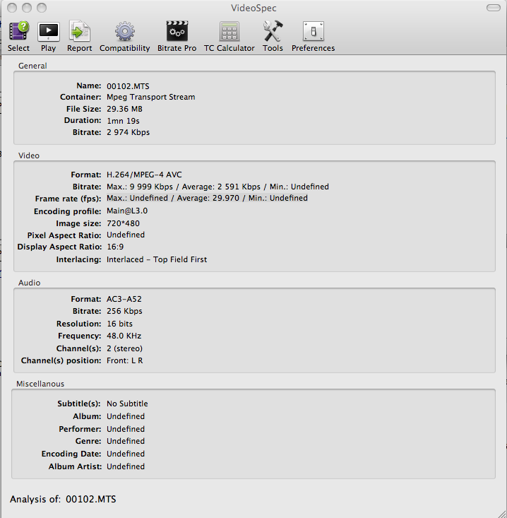

I tried downloading that other small tool to convert video containers thing, but it it says something about not being compatible with my version of OSX and I need to update. I did download VideoSpec and here is my result.
In that link you sent me, it said this "This is a very simple task for the command line tool "ffmpeg", but people are often afraid to use the Terminal." Is there a way to fix this by using terminal? Is it complicated? Or is my only option now to update to Lion or whatever the current one is?
