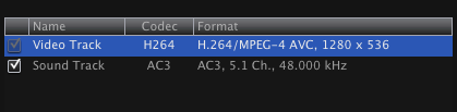

OK now what? I changed the extension to .mp4 but my xbox still wouldn't play it.
So you did use Handbrake to transcode the .mkv file to an .mp4 file using the H264 codec?
Or did you just change the extension in Finder?

I just used finder. My computer, see sig, isn't the fastest. So i was hoping to find a way to convert mkv to a xbox compatible format with out re-encoding the file.
