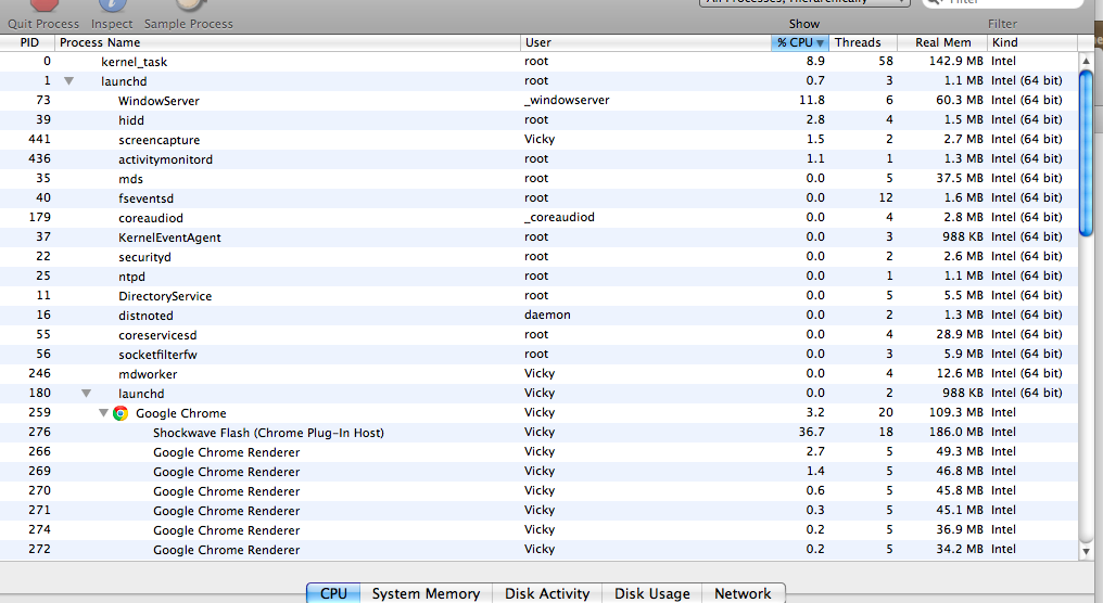

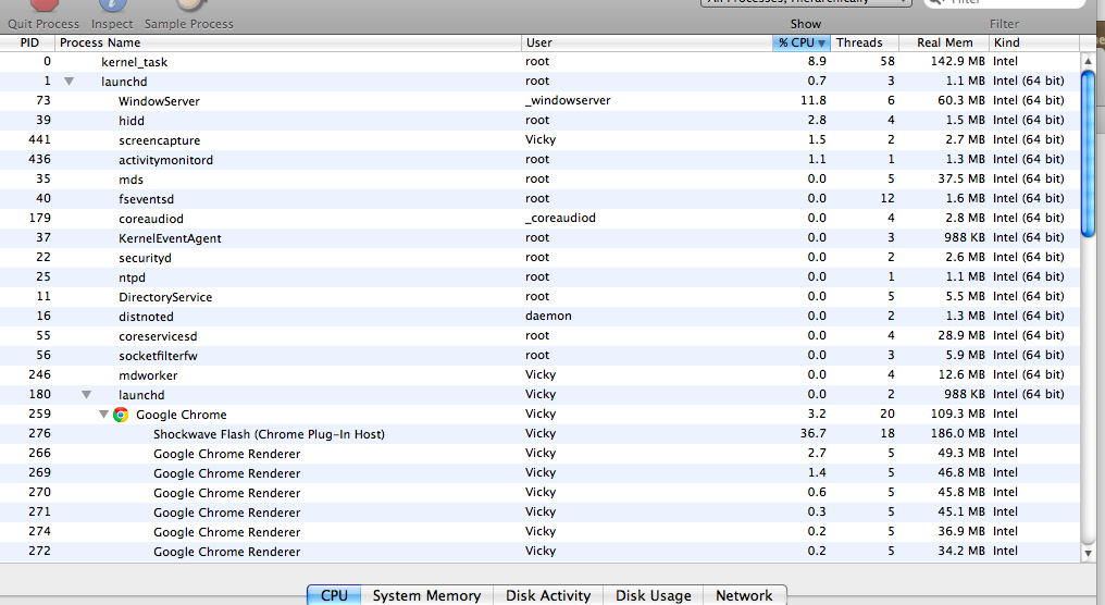

Hmm, maybe it's just that you're running intensive programs without realizing it or maybe something is using up a lot of your CPU and you aren't realizing it.
Can you post a screenshot of your Activity Monitor showing "All Processes" and the "CPU" tab selected? Thanks in advance. 🙂

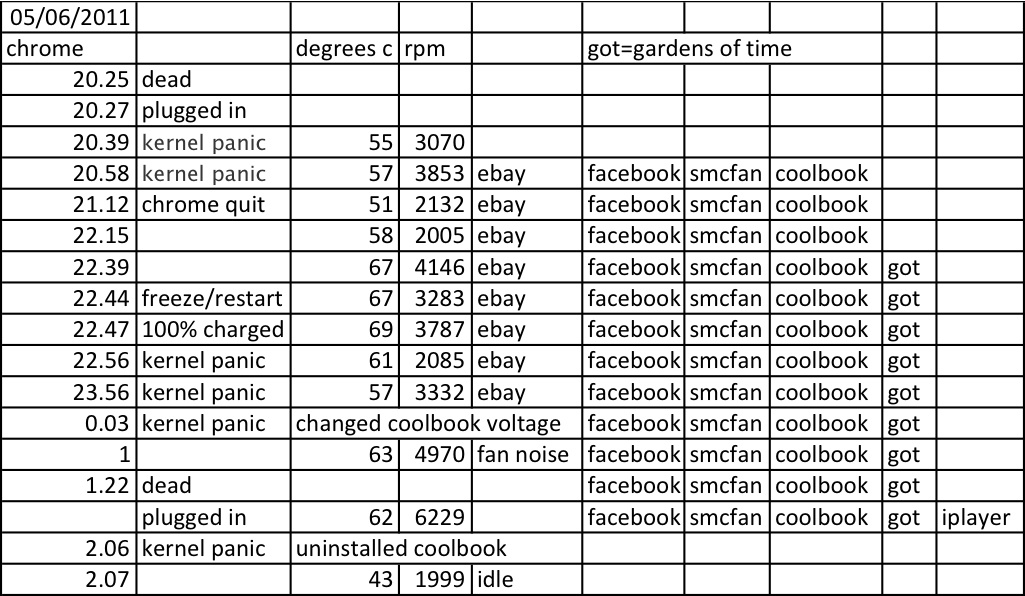

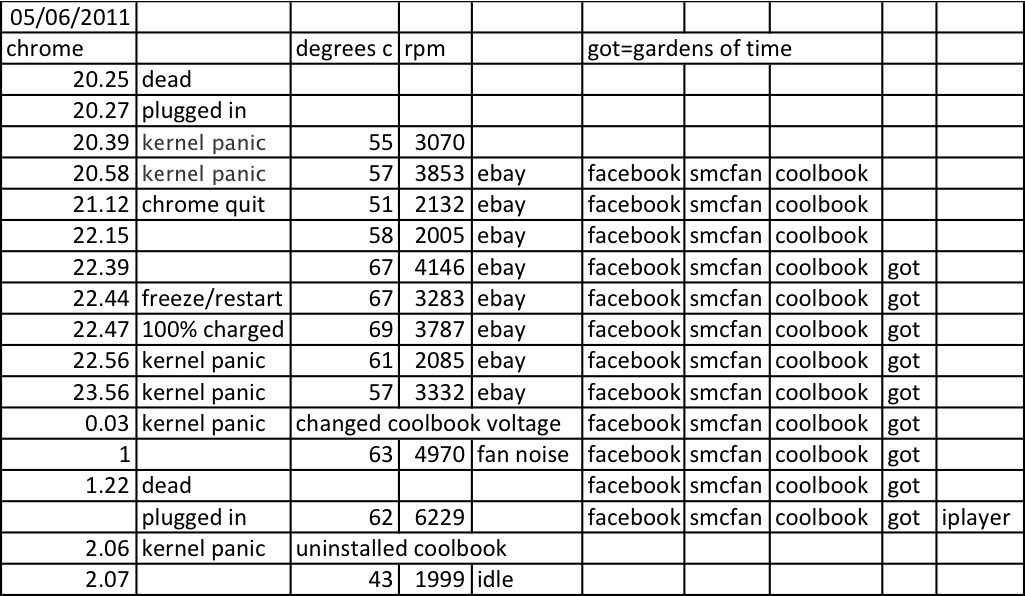

I have attached activity monitor and also a log of the activity today. I did this as it kept crashing. I then uninstalled coolbook, as per log.
I have noticed previously that the chrome shockwave flash is quite high. I am also a bit shocked at the short battery life.
I've never checked anything like this before, just assumed I had a quality machine !!!
Your voltages in CoolBook were set to low, which is why your Mac was crashing, and I'd say that the short battery life is because of the shockwave flash that is using a lot of your CPU. Have you tried using Safari or Firefox? Try using both of those (each for one day, 2 days total) to see if there is any difference. In 2 days, report back with your findings so we can further look into your problem.
Hope this helps.
Thanks for the advice. I have bought a program called flash frozen which disables flash when it uses over 30% cpu. So far this is working ok. I have no crashes tonight which I assume is because I uninstalled coolbooks. I stopped using firefox because on another thread I was told it was too cou intensive and was slowing things down, I can't get on with safari as I really need my bookmarks bar icons and as yet it isn't possible in safari. I have always liked firefox and will try that and post back. Thanks again.
