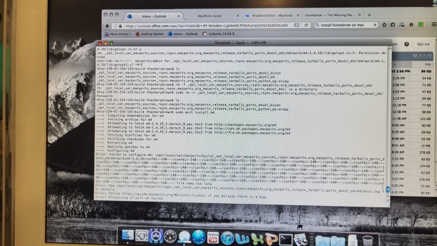

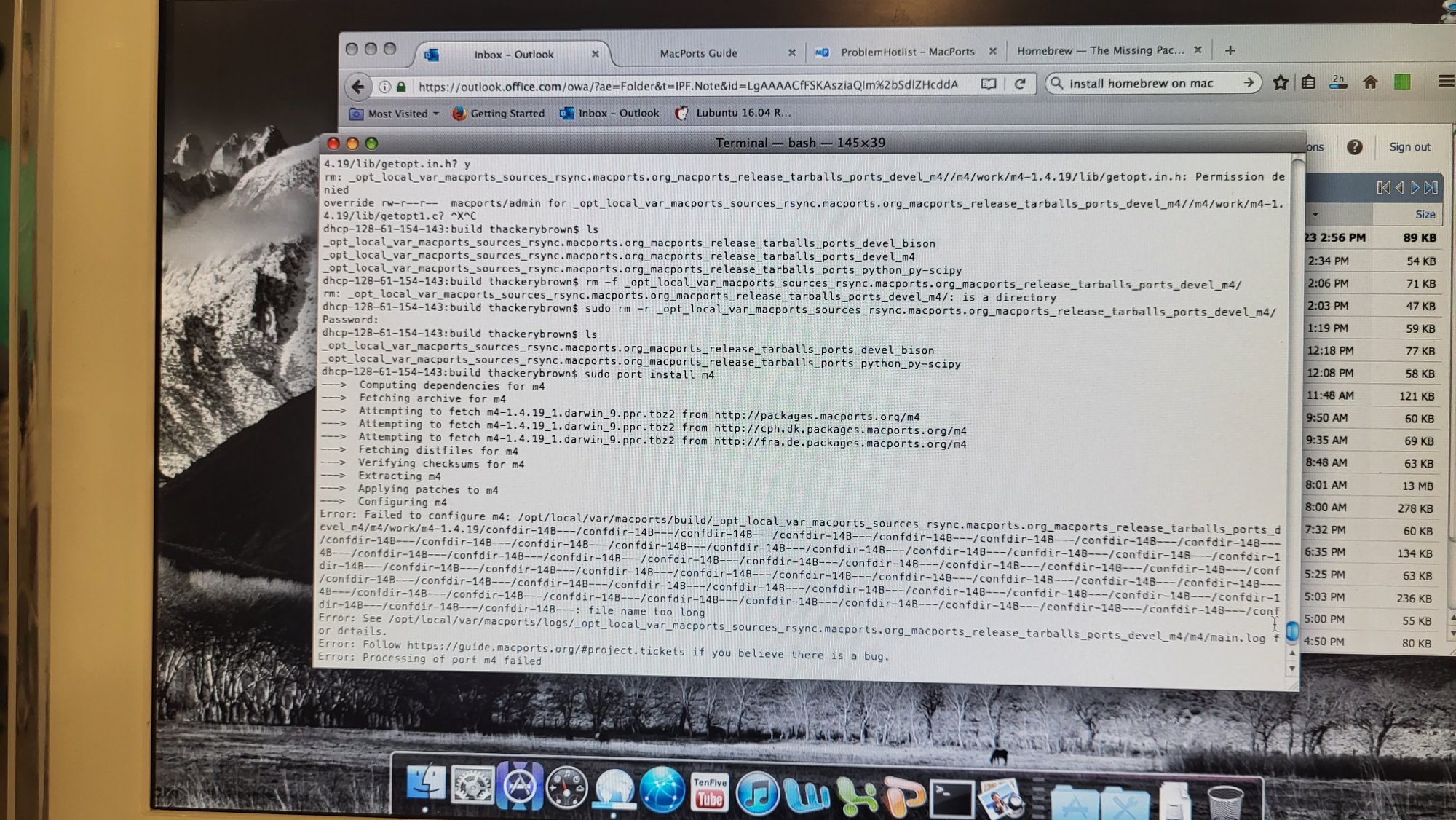

Wait, I can reboot to 10.5 and check current state of m4. I guess the error is this one? 🙂
*edit* sorry! you are right, that's the issue I have. Thank you! I was looking at a different thread. I'll try this...
Try the patch suggested there, it should work. I will try to do something about merging the fix, it is indeed annoying to have it broken (I tried building now, and yes, it fails).
