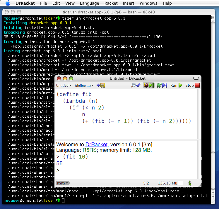

$ curl -O http://leopard.sh/leopard.sh
$ chmod +x leopard.sh
$ ./leopard.sh
or, for Tiger users:
Code:
$ curl -O http://leopard.sh/tiger.sh
$ chmod +x tiger.sh
$ ./tiger.sh
The first time it runs, it will copy itself into /usr/local/bin and perform some setup (you'll be prompted for your sudo password). If you'd like to audit exactly what it is doing during setup, have a look at the setup section:

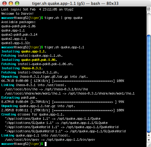

To install and play Quake, for example:
Code:
$ leopard.sh quake.app-1.1
$ open "/Applications/GLQuake 1.1"

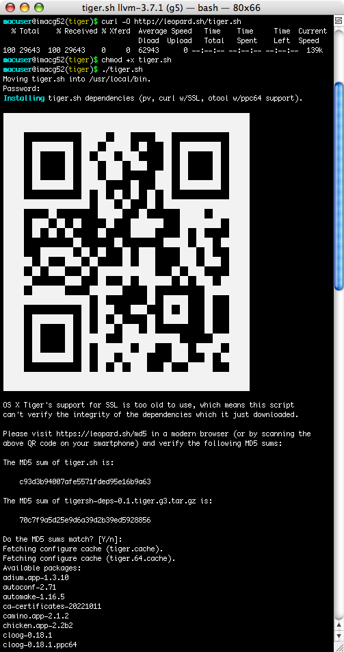

If you were to install a modern version of openssl and then build curl against that, couldn't you use that to avoid needing to verify signatures out of band?
I really like how every package is basically a self-contained shell script that tells you how to build it! One thing I've always liked homebrew (and why I personally use it over macports even on older unsupported systems) is that it's very easy to read a "formula" and understand exactly how it will be built. By contrast I find macports "port files" really hard to parse, with too much magic happening due to portgroup inheritance. (On the flipside, one could argue that homebrew itself does magic in terms of "superenv" but I actually kind of like the approach since it gives you a uniform way to add extra libraries without having to muck around in the specific build-system).
Thanks! Yeah, I explicitly decided to make each shell script as standalone as possible, at the expense of having lots of duplication among shell scripts (I don't mind -- VS Code has an excellent "diff editing" mode, and I start from a template anyway).
So actually the script does use a rebuilt version of curl with SSL, see
However, in order to squeeze out every drop of performance, you can drop SSL completely via:
Code:
export TIGERSH_MIRROR=http://leopard.sh
export LEOPARDSH_MIRROR=http://leopard.sh
Without SSL, it is nice to have MD5's verified, just in case 🙂.
The MD5 sum is actually verified in parallel as the file is downloaded (via a fifo), so the MD5 check essentially happens "for free".
Reactions: Amethyst1
Ohhh, I just realized you are maybe referring to having to verify the initial MD5 sums "by hand"?
There's kinda no way around that if I want folks to be able to perform the initial install using only the system-provided curl. I figure those who care will whip out their phone and verify it, and those who don't will just hit enter.

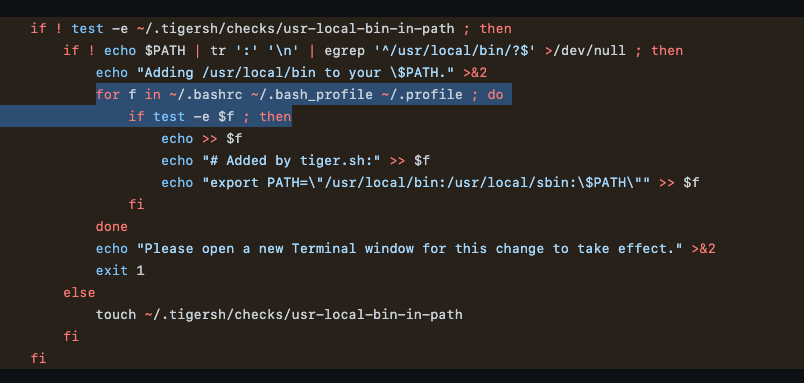

oh, I see the problem.
There are three files which your terminal (actually, your shell, bash) looks at when starting up to determine its configuration:
  • ~/.bashrc
  • ~/.bash_profile
  • ~/.profile
However, I just created a new user on Tiger and was surprised to find that none of those files exist by default!
So my code didn't actually do anything, because it checks if those files exist before it tries to modify them:
You can run the following commands in a terminal, which should get you sorted:
Code:
touch ~/.profile
/usr/local/bin/tiger.sh
Then you should be able to just run 'tiger.sh'.
Reactions: Yumiko Noua

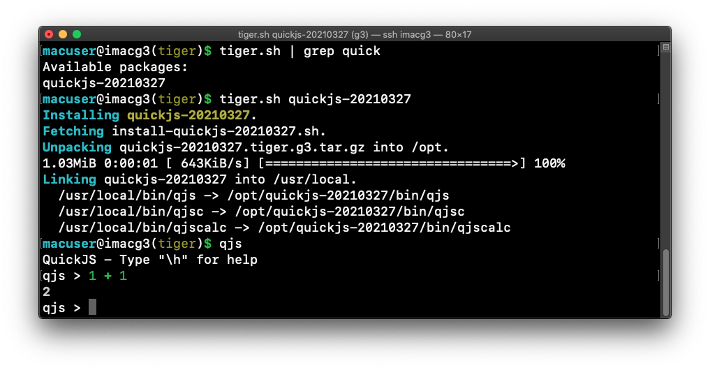

Here is an initial build of quickjs:
