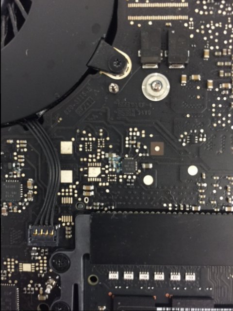

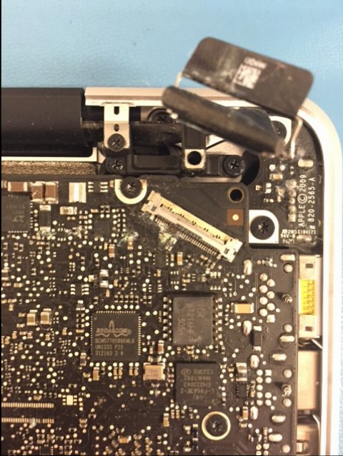

Daughter's MacBook Pro 13" went into Apple Store and they said there were two corrosion spots, must have had liquid damage. Pictures they sent attached, I can't see it. Had just scrapped together money to renew Apple Care but doesn't apply, would have to pay more than new to get repaired. She swears there have been no spills, doesn't leave in cold car (condensation), low humidity where she uses it. Wouldn't liquid damage be whole board if there was a spill? (Just as aside, why fan sucks in air? Design flaw? Should be Recall?). I find it interesting that an Apple Store just replaced that (logic ?) board no-charge in August. Does Apple have any kind of appeal process? Completely broke student (and parents) with 7 papers due for finals...

For me, I think the damaged areas are pretty obvious - both are near the center of the pictures. I putz around with older circuit boards so perhaps that's what makes it obvious to me but I don't have the experience and the pictures don't have the resolution level for me to speculate what caused it.

I hate this crap. It's clearly liquid damaged. Just because a liquid sensor isn't tripped doesn't mean it's not damaged by liquid. Liquid indicators are there to help find liquid damage, not be the end all and be all if something has liquid damage.

Because it doesn't work like that. With that kind of corrosion that board wouldn't have worked when installed, if it was installed like that. I've been working on Macs professionally for 8 years, I know what I am talking about. I deal with this kind of shenanigans on a weekly basis where people employ all kinds of mental gymnastics to try to explain why their machine is damaged, but because it's "not their fault", it should be covered. I've had two year old machines with an entire can of soda in them where the user says "it must have come from the factory like that" ... right because it would have worked for two years like that.

I'll concur with @bizzle I can clearly see the corrosion on both pictures, though like him my eye may be more trained to see it than others. If you've ever seen an alkaline battery leak and corrode you'll see the corrosion in the first picture.

Funny thing. I worked at an AASP from 2003-2008 and there were a handful of times that we'd receive a service part from Apple that had minor corrosion and didn't work. Apple has the option of using refurbished parts, after all. If there were times that we had boards come in FROM APPLE with minor corrosion that didn't work, I wonder how many times boards arrived with minor corrosion that DID work.
I work at a contract manufacturer now, and we build circuit boards for different customers. I know how corrosive certain types of flux can be if not properly activated or cleaned up.
I'm not saying that there isn't a possibility that liquid got into the computer. Are you saying that it isn't a possibility that Apple screwed up when repairing the board that ended up in the OPs computer?
That's not "minor corrosion".
There are dried water marks on the fan.

To me in the first pic it looks like a component failed and leaked its contents. How do you get a liquid in a spot like that without damaging surrounding components.
The only typical component that would leak is an electrolytic capacitor and unless it has a non-typical packaging, I don't see those in the photos. Electrolytic capacitors, when they leak, will usually leak a brown fluid.

Does anyone see the liquid sensors in the photos of the corrosion?
None of the LCIs (Liquid Contact Indicators) are visible in the 2 pictures. Actually, most of them are only visible once the MLB has been removed.
