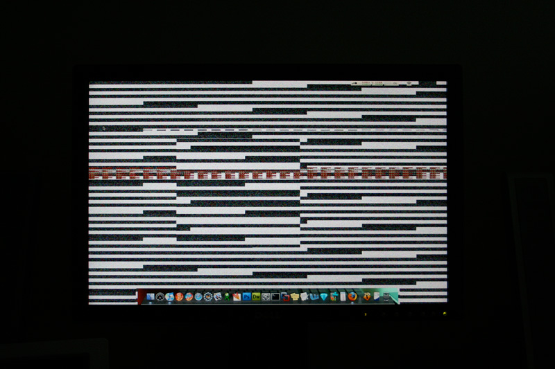

Occasionally when I wake the Mac Pro from sleep it wakes up like this:
All you can do is cold boot it, then it's fine again. Worrying though, anyone ever seen this?

I'm going to say it's your graphics card. That's about the only thing you didn't mention here, so I don't know if it has a rash of failures.
That's interesting that your hard drive would come back as the cause of a graphics error. Unless the GUI data is corrupted... I'm a little out of my league here.
It just looks like every graphics card error I've ever seen... 😱
Run the firmware update for the 2600.
You download it in software update.
It should show up in your Utilities folder, just double click it to run.
If your card already has the current firmware it will tell you.
Check the GPU fan is spinning when you boot the Mac, and a while later. Cheap GPU's have cheap fans and when they fail the card overheats and you end up with similar tearing / artifacts on the screen like that - it's the #1 failure point of any machine when we e.g. buy entry-level GPU'd workstations with something like a Quadro FX5xx. Either way it also looks like a GPU issue to me, either though an outright failure or cumulative thermal damage.

Check the GPU fan is spinning when you boot the Mac, and a while later. Cheap GPU's have cheap fans and when they fail the card overheats and you end up with similar tearing / artifacts on the screen like that.
Good idea, I'll check that out.

I had a similar problem quite awhile ago. I hunted for weeks to find the cause of it all. Then one day one of my older Western Digital storage drives died. No more problems on waking from sleep. I can't really say how it actually caused it, but it had to be the drive in it's last throes of life screwing things up. Ever since that drive died, I have never had the graphical corruption issue.
Definitely a dead card. I would run diagnostics on the HD's once again once replaced though as you may have 2 problems lurking.
The Video card & the hd.
Interestingly I've just recently replaced my boot drive, but this problem still persists.
I ran diags (as noted in first post) and got this error: 4HDD/11/40000004:SATA(1,0). I just don't know how to understand which drive it is referring too.
To me, it seems more like a GPU issue.

Maybe the 2nd disk (disk1) with a bad GUID_partition_scheme?
It certainly looks that way. I worry about the HDD error though, but I don't really see a connection between this and the display issue. 😕

Not sure I would point at the GPU when you are getting a Hard Disk error. I would think maybe disk 1 is drawing to much current on wake sometimes and causing the system to screw up. Would try running it without the one drive for a bit.
