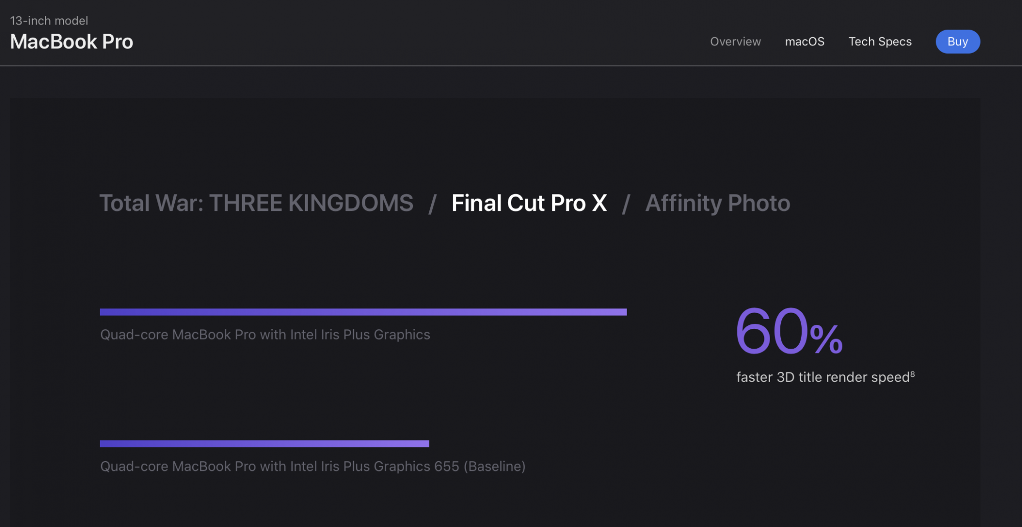

One question about the graphical performance between 2020 Air and 2019 MBP. Where did the 60% delta on paper come from?
Initially i suddenly saw it on the Apple's web site for MBP 13:

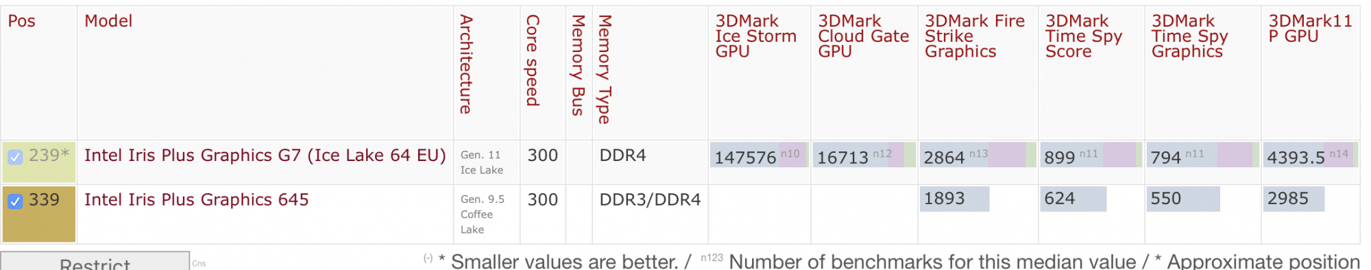

Then i searched for GPU benchmarks on notebookcheck web site and really benchmarks show us +60% difference. Link.
Results are just like on the Apple's web site. Sometimes it is +25% and at maximum it is +60% depending on the use case.
It sounds different than the video export mentioned earlier, but not sure.
Because G7 graphics in Air is not able to sustain its' performance. So in benchmarks it is good, but when rendering something 5+ min. it is behind MBP 13 base' graphics.
