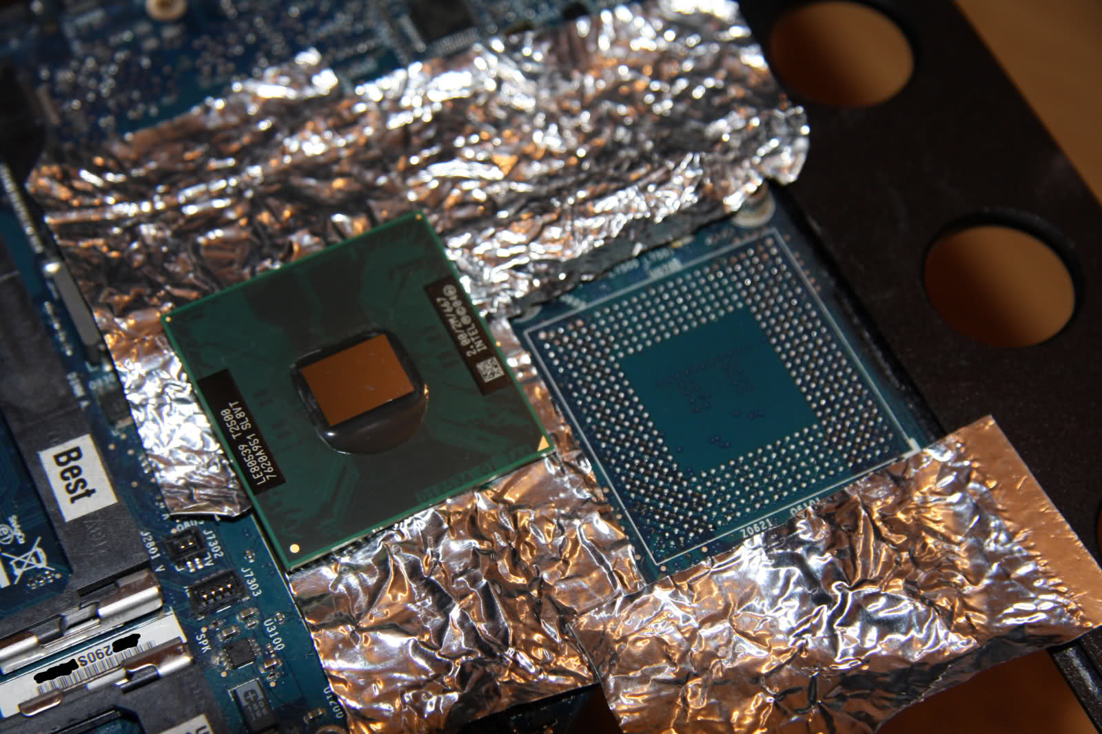

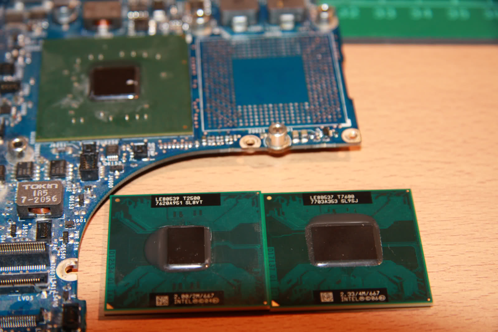

was recently reading this thread and i took a few pictures of my progress in regards to upgrading the cpu inside a macbook 1.1
I have sucessfully swapped out a 2ghz core duo cpu for a 2.33ghz core 2 duo cpu and the machine works perfectly fine.
Only problem i have noticed is that when you go to "about this mac" it shows up as a 1ghz core 2 duo but everything else detects as a 2.33ghz core 2 duo
thermal management works fine and idles at same temperatures as 2ghz.
the bonus would be the fact its a core2duo, extra .33ghz faster and now 64bit!
the coreduo 2ghz was a T2500 and i swapped it with a T7600 core2duo 2.33ghz.
wonder if i am a first?
before anyone says its not possible.. i specialise in bga reworking and i own a jovy 7500 :)

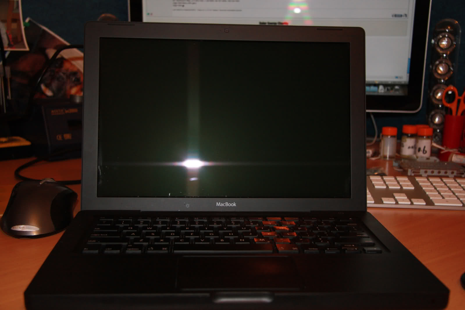

this is the macbook that recieved the new implant
here is the system profiler and cpuid running
all working 100% i will look at that link to change the info in system profiler then its bye bye to this macbook as its being sent back to america. I did the upgrade for a friend for FREE to prove to him that my theory on it was right and that i could make his macbook 64bit

BGA reflow is common sense, if you have common sense, and experience in SMT technology and electronics. It's not rocket science, just soldering on a VERY small scale. With the right jigs and IR reflow, anything is possible.

Wow im suprised this thread is still going and there are people out there who still have the core duo units. Ive had numerous messages asking about this so ill just clarify a few things for everyone.
With the CPU upgraded lion will still not install as it checks your system identifier (macbook 1.1 in my friends case) and knows that its not supposed to support lion so will refuse to install.
The only way to get lion on a unit that has been upgraded would be to create a image of lion pre installed on another mac and restore to the old mac or install hard disk into a core2duo or above unit, install lion and put hard disk back into the old mac.
With regards to the T7200 CPU yes they are all the same CPU's whether HP or DELL etc.. as long its in BGA its fine.
This will most likely put people off doing the upgrade but i guess if your into modding and such then its just part and parcel of what you do.
