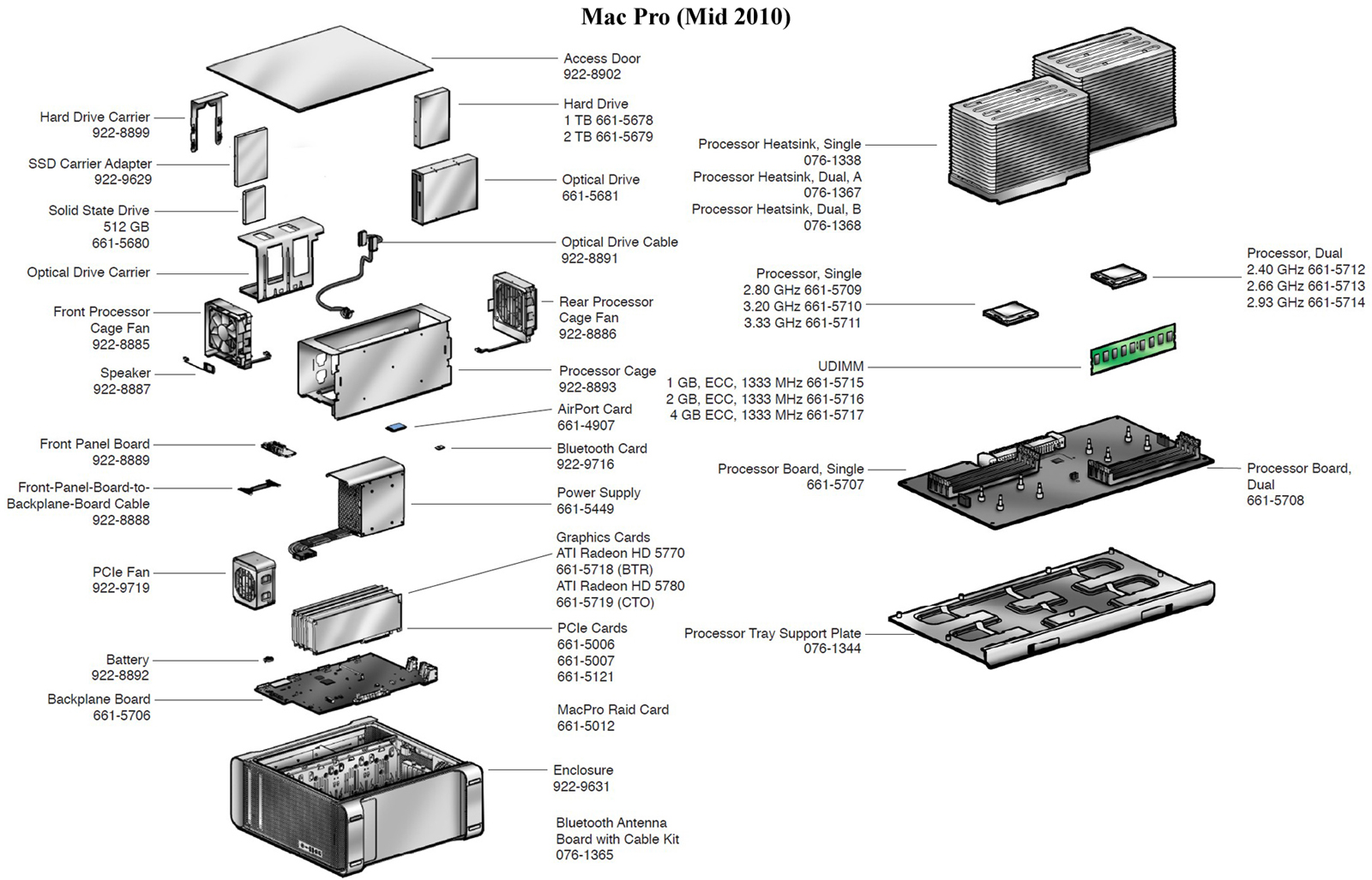

Here are the part numbers and prices for the upgrade. I attached some Geekbench scores for performance comparison only between the different processors.
Processor Board, Dual 661-5708 $599.00
Processor Heatsink, Dual, A 076-1367 $239.00
Processor Heatsink, Dual, B 076-1368 $239.00
...now the price for the processors, you will need two :-0
Processor, Dual 2.40GHz 661-5712 $1099.00 ea. Geekbench score 14832
Processor, Dual 2.66GHz 661-5713 $1299.00 ea. Geekbench score 23771
Processor, Dual 2.93GHz 661-5714 $1899.00 ea. Geekbench score 25598
I purchased a base model knowing that I would upgrade to a Hexacore when the processor prices drop...perhaps 2012.
Processor, Single 3.33GHz 661-5711 $1499.00 Geekbench score 16137
Prices are from here. Parts diagram is attached.
