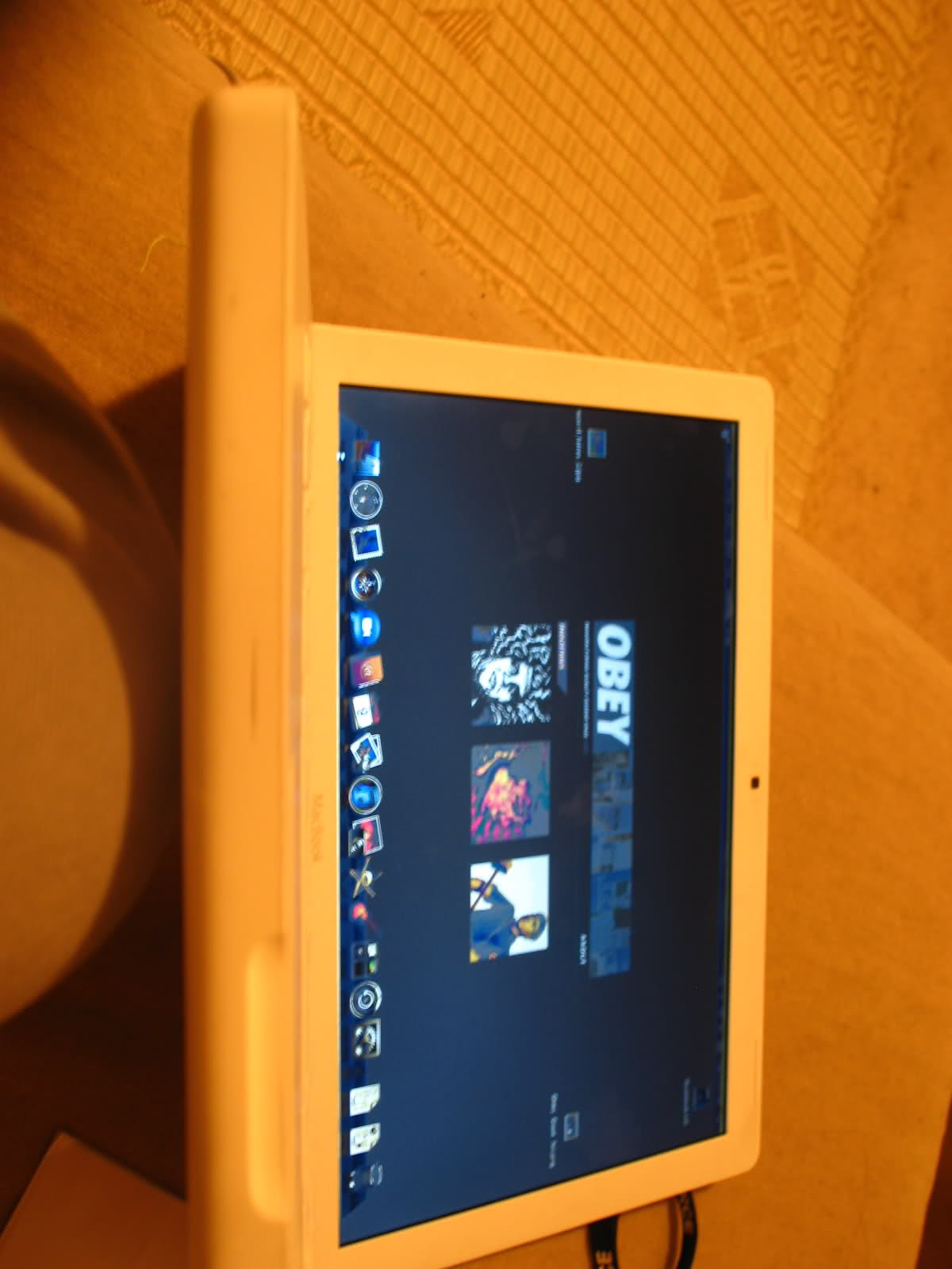

I have heard a few times people getting replacements from apple for this problem. Even customers that are out of apples 1 yr warranty or apple care. So I am just trying to see where I stand with this problem. My mac has the cracks that look like dark marks running not on the hand pad but below it where you open up the computer and a bunch of nicks near the cd port and a little pattern by a usb port. So would I be able to go to the apple store and have them replace my cracks with a new casing ect..?
Sorry if this has been covered in the past.
its hard to see due to my crappy camera, but this is best I can take.
crack is the darker line it runs alone to the left side it starts at the opening just to the right of it.
also i have noticed the fan is loud and computer gets hot
and when I have 2 fingers on the touch pad and scroll down I hear a odd sound almost sounds like a peeping but very silent when i scroll it goes away and and just comes back after like touching silent sound than back.
As for the peeping sound, it sounds like a processor whine that some computers suffer from.
Only thing you can do about the cracking is to take it to the genius bar and see what they say. 🙂

I took my mac to apple today and had them look at the thing. The lady that helped didnt really care about the cracks just said it cost a lot to fix. Than checked my mac because of the fan issue and heat. She ran a test on everything and there are no problems. So bottom line she said upgrade ram which I will do soo, but she said I can only upgrade to 2gb is that true? and get 10.6 and that will make a difference

I have had a bad fan once that made noise, and the topcase has cracked 4 times. I was always within warranty, but was told they fix the cracks even out of warranty.

I had two plastic MacBooks fixed last summer, one was 6 months after a three year applecare warranty would have expired. Didn't buy the extended AppleCare on that one.
Here's what I got from Applecare phone support. It might be better to try to set a genius appointment over the phone (with AppleCare) and then go to the store.
Here's what got me fixed:
"Please reference internal article "ts1964" to gain agreement with AppleCare agent to initiate repair at no charge. AppleCare agent to obtain "CS" code and provide case number."
Good Luck
