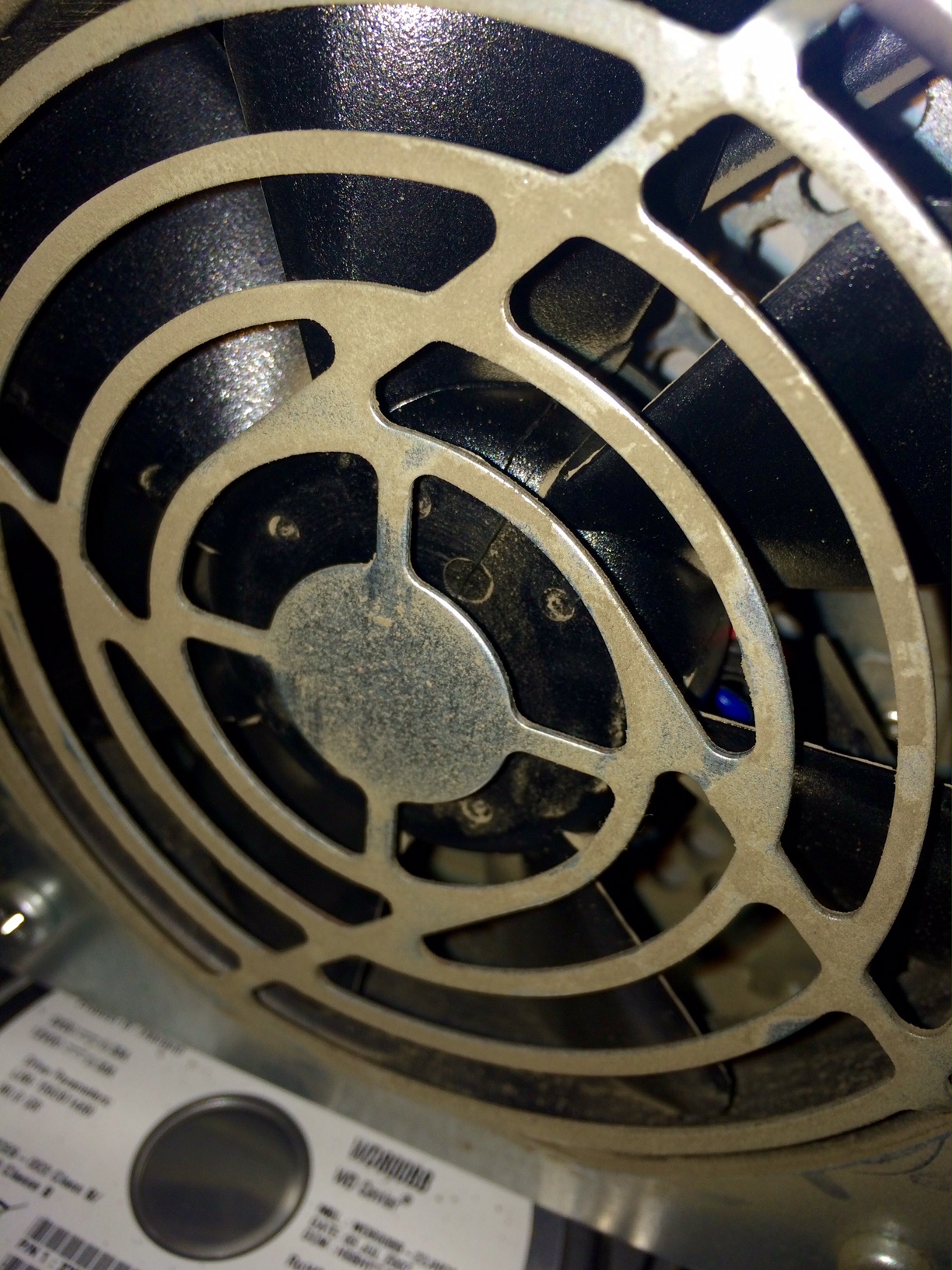

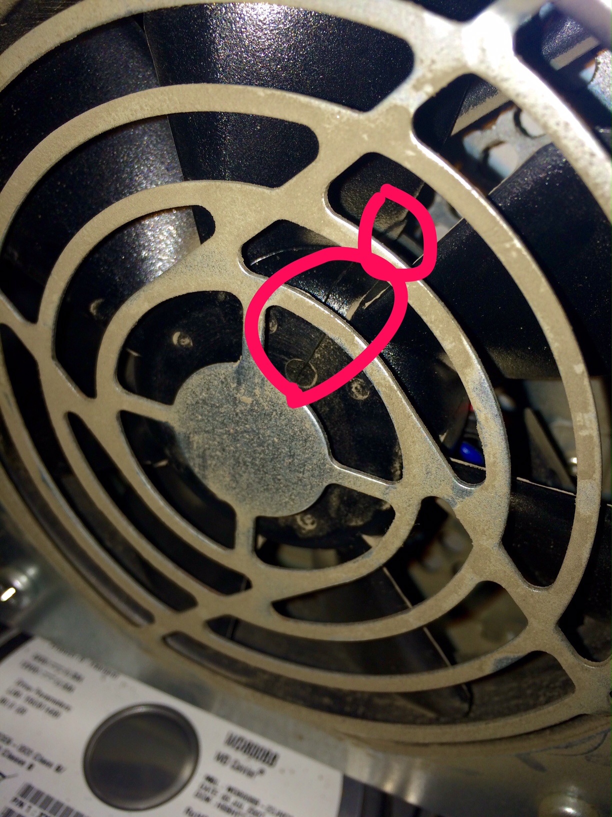

My 2002 Quicksilver has been working perfectly since I picked it up last October or so. Best PPC machine I've ever had the fun of toying with. However, tonight I reached around the back of the tower to insert a USB drive (PCI card with 2.0 ports. USB 1.1? Ain't nobody got time for that...). I was copying Mac OS 9.2.2 so I could install it onto an iBook G3 to play Railroad Tycoon 2 in fact.
But I order to to get back there, I lifted up the back handle gently while the Mac was running (this was probably my mistake?) and all of a sudden a new very loud grinding noise bellowed out of the system. Fearing the worst I unplugged it straight away and bit my lip. I let it cool before opening it up for inspection.
I found at first a bit of IDE cable plastic poking into a PSU fan. I though that must be it, tucked it in, and booted up. GRRRRRRRRR!!!!. OMG. Make it stop. Make it stop. For the love of all the earth. Make it stop.
I inspected it a second time, and discovered that the large fan below the PSU toward the back, was both too far up against the outer side of it's cage, and cracked slightly down a part of one blade.
I pushed it back into it's proper place and booted up again. All things bright and beautiful...for about half and hour. I opened it up yet again to find that the fan had moved back to being right up against the cage side, scratching up against it as it rotates. i.e. not where it should be. I have taken it out of service until this problem is resolved. Don't want to cause any further damage.
What do I do here? Can I fix it? Is that fan easily replaceable?
No worries!!! It's called the case fan.
That's a standard 120mm PC fan. Just buy a new fan. I would take this opportunity to buy the highest CFM fan you can. I replaced mine with a Cooler Master 120mm fan rated at 95CFM.
You'll need to pull out the ZIP drive (if you have one) and the optical drive so you can get to the fan shield. The shield is what the fan is attached to and it's held there by the standard four screws.
Just replace the fan. You will probably have two options as far as connector. If the replacement comes with a Molex cable connect it to a spare Molex connector. Or, you can cut off the end of the cable from the old fan and the new fan and splice them together so you can continue to power the fan through the proprietary Apple connector.
Either way, you'll get the fan back in operation.
I've replaced all the fans in my case with higher CFM models and even drilled out a hole in the bottom of the case for an additional 120mm fan. My case fan was the first to get replaced.
No big deal.

That fan is easily replaceable and fans like those are cheap.
I believe it is a 120mm fan but I don't know what connector it uses. You may need to do some soldering, though if you don't want to, you'd be just fine with wire nuts or crimp connectors. Just cut the cable of the old fan for the plug side and do the same for the new fan, and attach the old cable to the new fan so you can plug it in.
You can get the cheaper sleeve bearing ones with low speeds and CFM or you can get the more expensive one with ball bearings and higher speeds and CFM. Just use whatever you can find or already have.
I recommend looking in your local electronics store. Look in Fry's or Best buy; they have good prices on fans I think. Also you may have some RadioShacks closing nearby and you might find some fans at their liquidation sale.

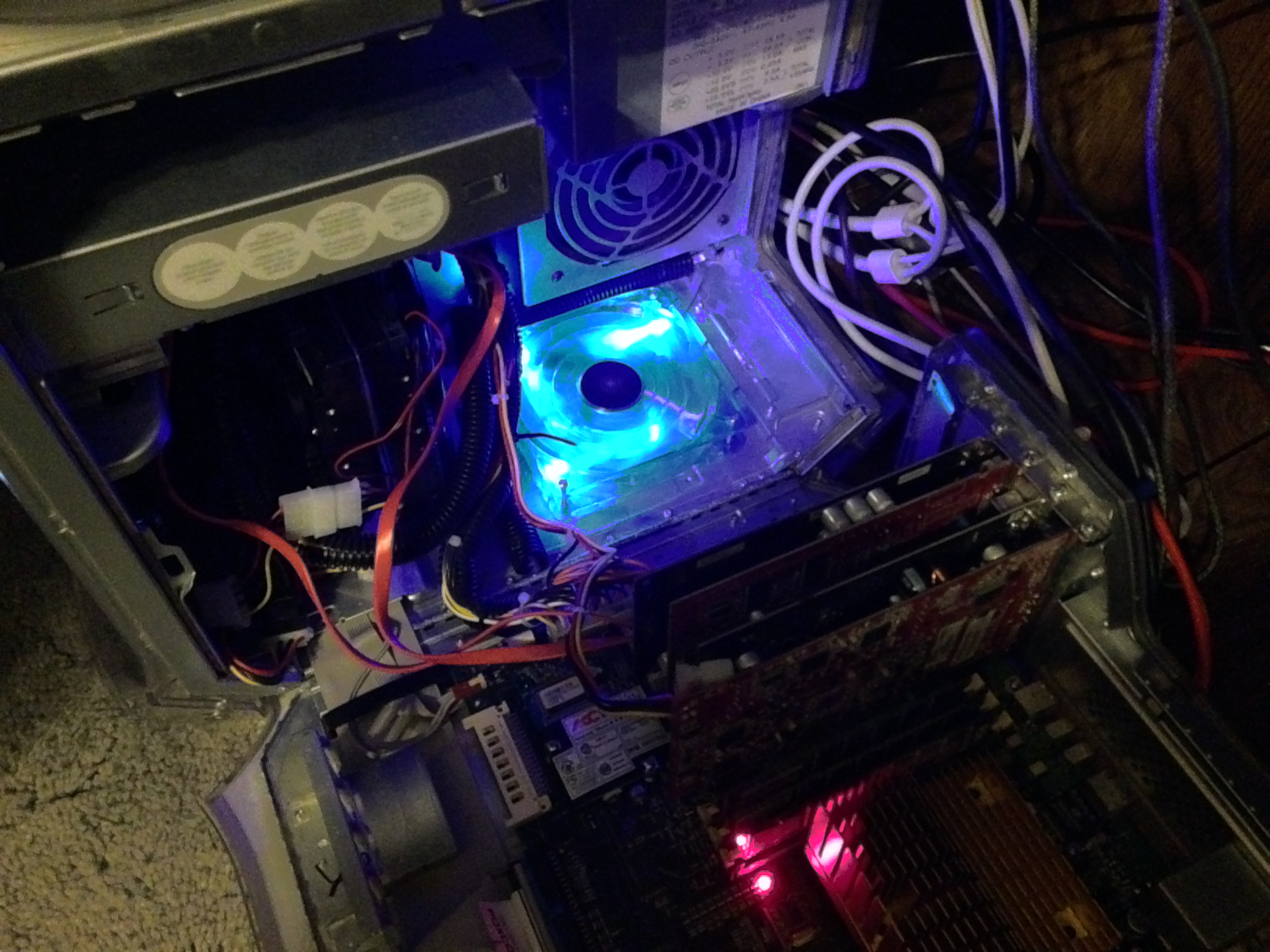

If you like you can get the clear LED lit fans :cool:
Look for fans with only two wires. 3 or 4 wire fans have those extra wires for the speed sensor but the Mercury Mac (Quicksilver) doesn't use that so I think it is a waste

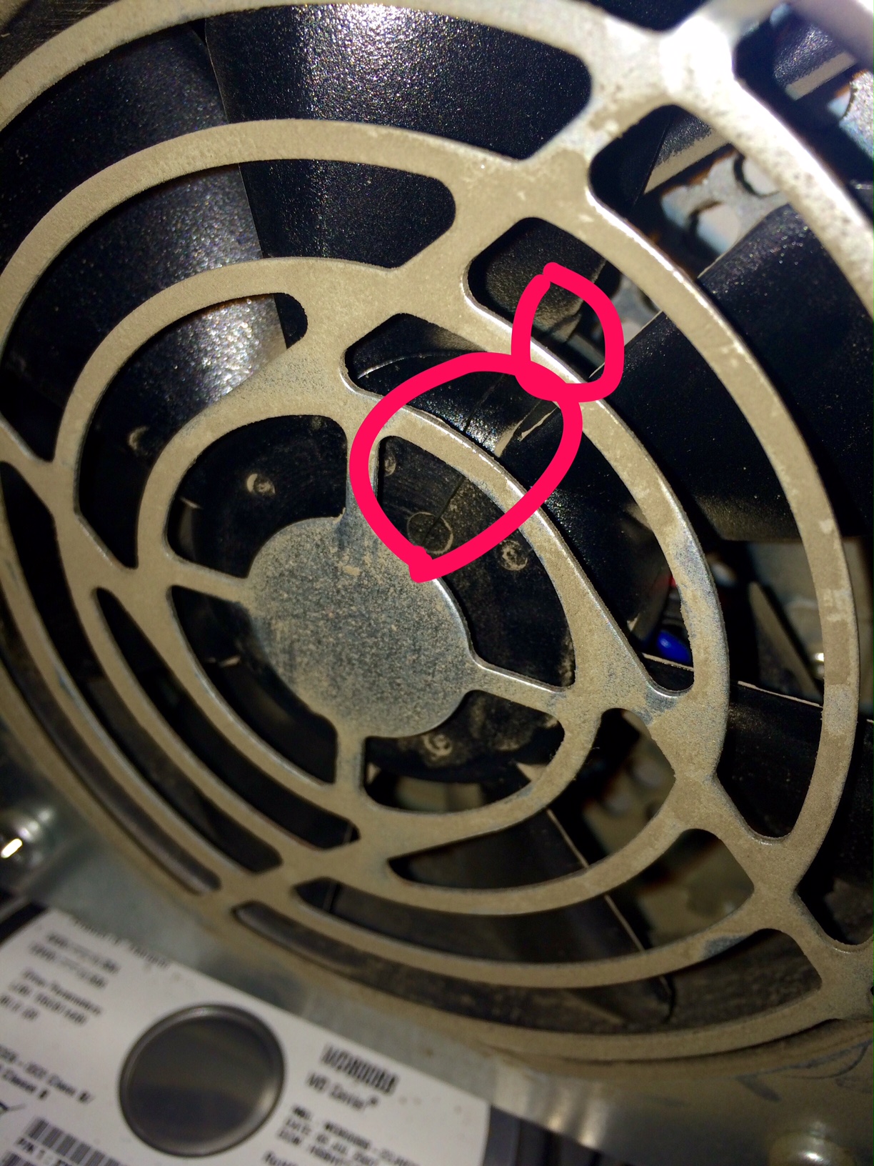

Also please take some picture when you take it out, I wanna see that crack better! Awesome crack!

My first QS2002 had a crack in that fan in almost exactly the same place when I bought it.
The seller told me that it made an "awful racket" when turned on, and I quickly figured out why. If yours sounded like mine, it really does sound like the computer is about to self destruct!
In any case, the entire fan housing can be removed pretty easily(I don't remember exactly how, but it should be fairly self explanatory once look at it). The fan plugs into the PSU via a two wire connector-disconnect this.
Once the housing it out, remove the four screws you see from the front of the housing, and the fan will come out.
From this point, you have two options. The prudent and smartest course of action is to find a like replacement fan(I think it's 120mm, which is a common size) and install it.
In my case, it was 10:00 at night when I got into it, and wanted to get the computer going, so I did the not-as-prudent, but nothing to lose course of action. The crack made it very easy to remove the fan blade assembly from the rotor, so I did. I cleaned the entire fan blade thoroughly with alcohol.
I then saturated the crack in superglue, and put a rubber band around the blades as a clamp.
I think I let it cure about an hour(or maybe less, but definitely no more) and pressed the fan blade back onto the rotor. It was a much more secure fit. I then put the whole mess back together.
I'd intended that to be a temporary solution. I bought that QS last June, and it was on pretty much continuously from then until February of 2002. It's been on periodically since then, although not 24/7 as before. I've not heard another peep from the fan or seen any sign that my "temporary" repair was about to give way. That's with about 8 months of that fan pretty much continuously running.
So, there's my suggestion. In the worst case, track down a replacement of the same dimensions on Ebay, and splice the current connector onto it.

Haha, such knowledge! :D That's good to hear at least, that it's a relatively trivial operation. I've disassembled a 2004 G5 once to each individual part. That was an incredible struggle. I feared fiddlyness to the same degree. Regular screws on the other hand are my favourite!
I'll have to hit the ebay and search for a replacement so. I must survive without it for a few days.

You might also be interested in the other 120mm I use, the one in the bottom. That one is a bgears, 110CFM.
https://forums.macrumors.com/posts/20731448/
bgears also makes them in red and other colors, but those are different part numbers.
Here it is in the bottom of my case…
https://forums.macrumors.com/posts/20727664/
I've never seen an LED fan IRL, and they don't look good on cameras. I wonder what they look like IRL.

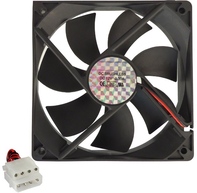

Ordered a basic 120mm replacement fan from the UK. It uses the standard molex power connector for the disc drives, so I won't have to do any modification to cables.

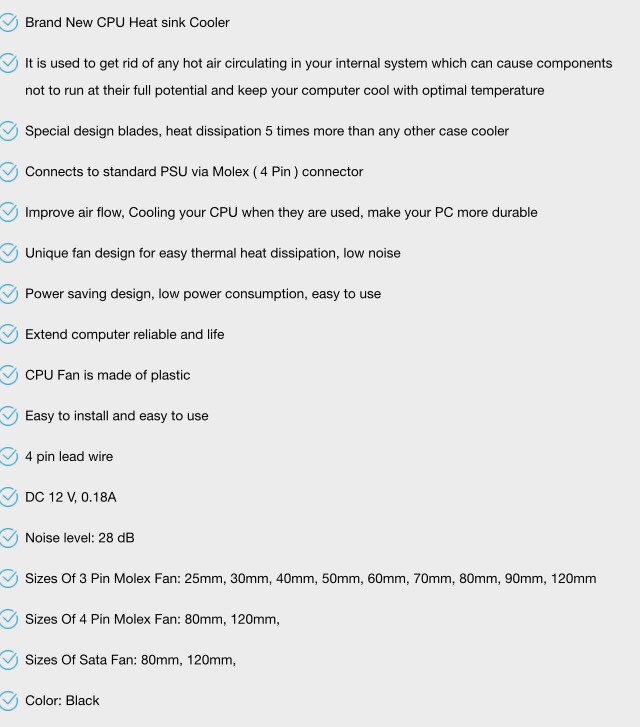

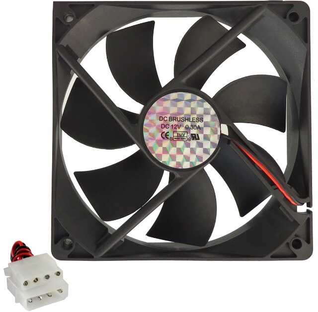

What fan did you get?
Oh just some cheap one from eBay. Nothing fancy. It's not my main machine, so I can't justify spending much on it.
Oh I see
Can you give the link of the page? I'm curious of the specifications of that fan.
Also you're Irish right? Or just live there? Well Happy St Patricks Day.

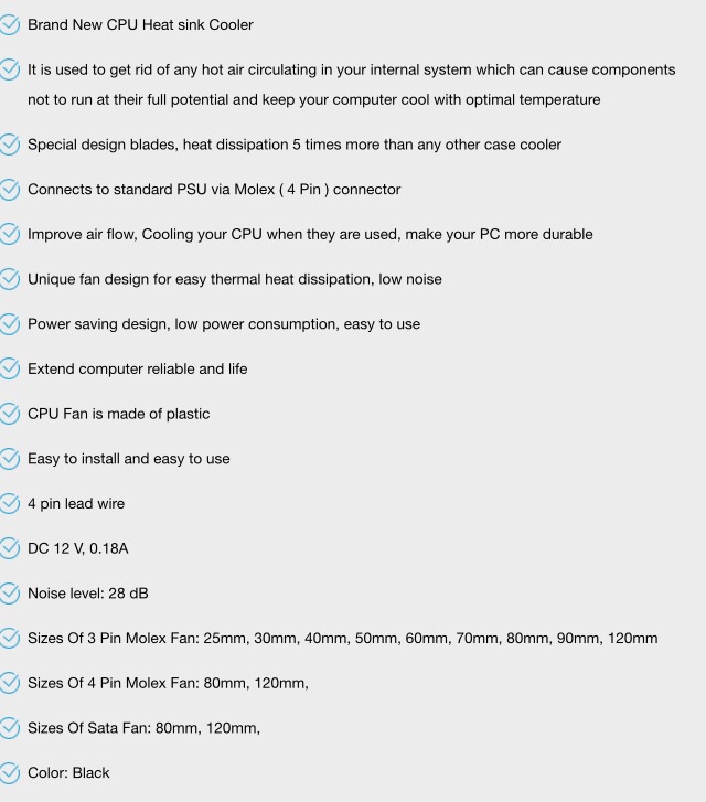

heh funny information there But it doesn't say much though. It doesn't say the CFM or speed...
Yeah, for a computer like that, you need a pretty good fan. Apparently the original was 85 CFM, I don't that that fan does 85 CFM.

That fan probably does around 30 or 40 CFM so you _might_ have some heat trouble but you'd probably be fine. The plus side is that this fan will be really quiet!
