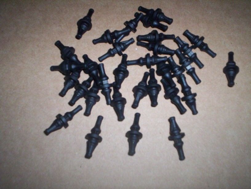

My gaming PC for example has more fans, mostly dirt cheap ones. Yet it makes much less noise in operations. Those low frequency sounds resonate well over distance.
Right guys, the new fan arrived today and I just finished fitting it into the system, leaving the glued up original on the shelf for now. I'll run some stress tests and heat the system up for a few hours and report back with temperature to compare it to the old fan. It does run a little quiter now. However, I think the design of the case itself resonates sound very well, and as a musician I suspect that it is indeed the case that is a major contributer to the famous noisiness of some G4's.
haha yeah they're like a guitar or drum hehe. 😛 Maybe using rubber things to hold the fans in place instead of hard screws would be better.
Like these in the image attached below.
They would insulate the vibrations of the fan from the case so the vibrations don't travel into the case and use it as an amplifier.
