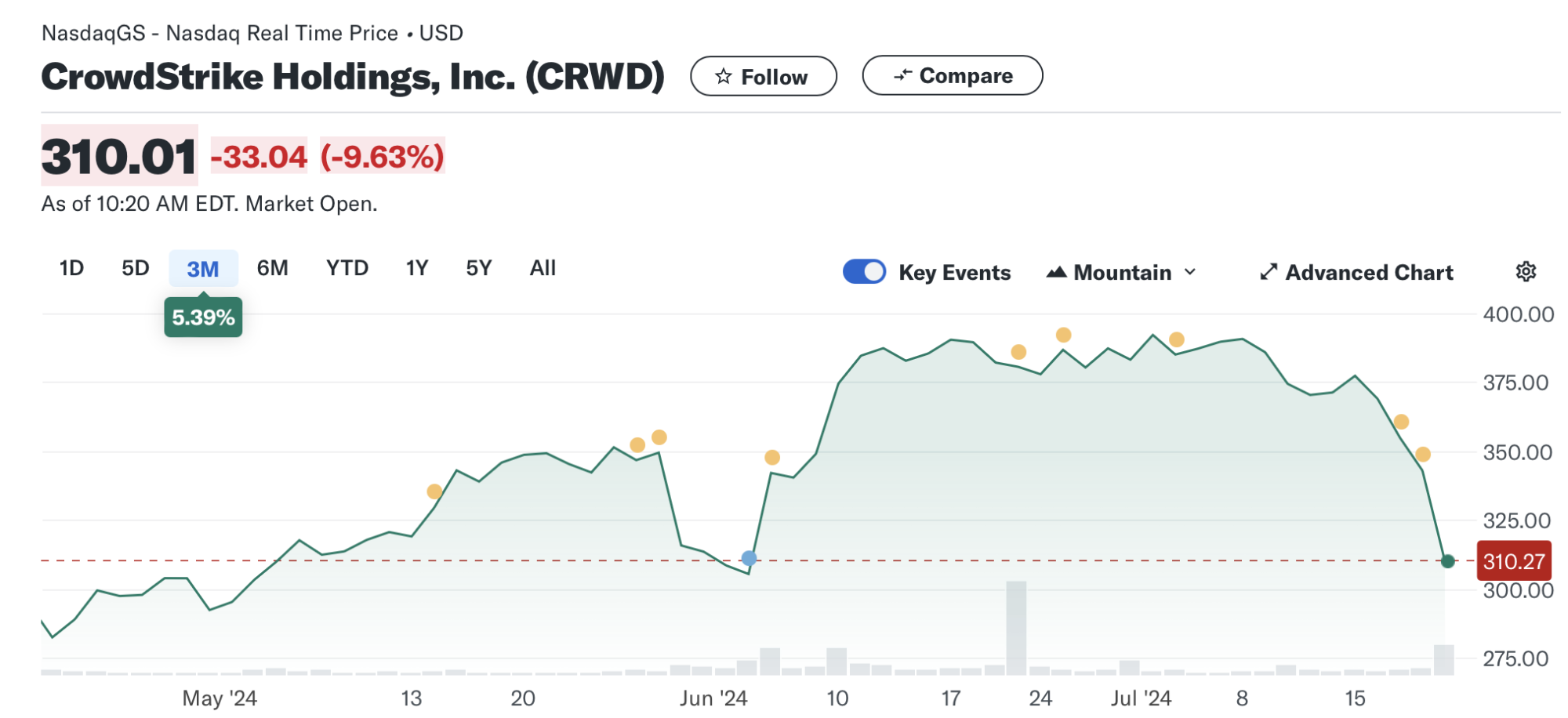

I tend to be resistant to most conspiracy theories...but interesting that Crowdstrike stock price began to dive on the 15th.
About the same time there was a general downturn in tech stocks. MSFT started falling July 10/11, NVDA did as well. AAPL fell July 10/11, went up a little, and then has fallen since the 16th.
CRWD is well within the broader market patterns (other than today).
