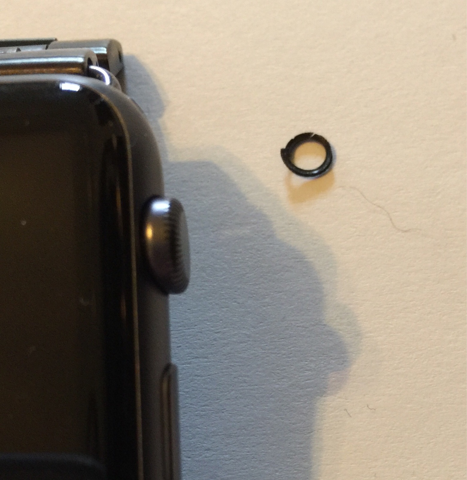

Had the sticky/stiff Digital Crown thing... did the warm water rinse while turning and pressing crown that Apple recommends in this advisory.
As I was drying it, I noticed a bit of black stuff in the gap, so I scraped it out with my fingernail. Out comes a broken O-ring seal! No wonder it was stiff.
Booking an appointment with a Genius - is this a fix or a replacement? Will be Watchless for a while?
Reactions: samiznaetekto
i guess it all depends on their stock. my guess is that it will probably be a replacement but you never know.
It's a replacement. No repairs are taking place in store for the Apple watch, iPod range and iPads.

How long have you had your watch?

Launch day, so 12 and a bit weeks. Not a total shock - I have had to replace 3 launch week iPhones so far, so I was kind of expecting this.
Thanks for the advice guys, will try to find time to see a genius this week, and remember not to get it wet meantime.

Well, Genius appointment today, and sent back to depot for repair or replacement - quoted 1-2 weeks.

I'd considered, if and when the water rinse treatment got to not being effective the fallback might be flossing.. this is a good indication that flossing is going to be really bad.. I know you didn't floss but it just shows that it could damage something we now know is there.

Well, 8 days later and they email me I have a replacement.
Restoring from backup on 1.01 took about 12 minutes, much faster than the initial setup of 40+ minutes on 1.0.
But the point is our long national nightmare is over, and I can tell time again. And stop missing notifications. Jeez it was a rough week people.

Hey, thanks again for the original photo. Always interesting to see the guts so to speak.
