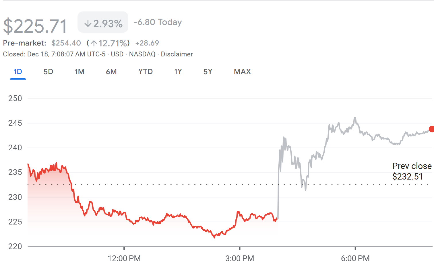

Are you using DIMMA2 and DIMMB2 for two stick memory slots?
Hardware Unboxed had a show with topics related to DRAM. One question that was asked are they thinking about selling all of their DDR5 and closing up shop? With prices going up on DRAM, SSD and GPUs, there may be far fewer people doing builds with current hardware.
