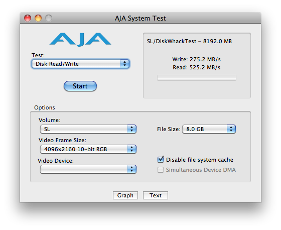

Just ran the update and everything was smooth sailing.
