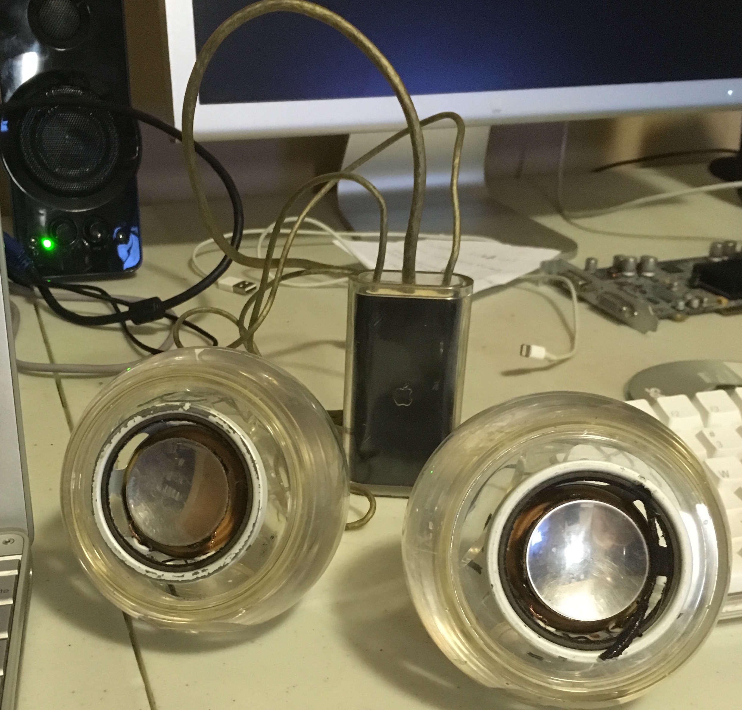

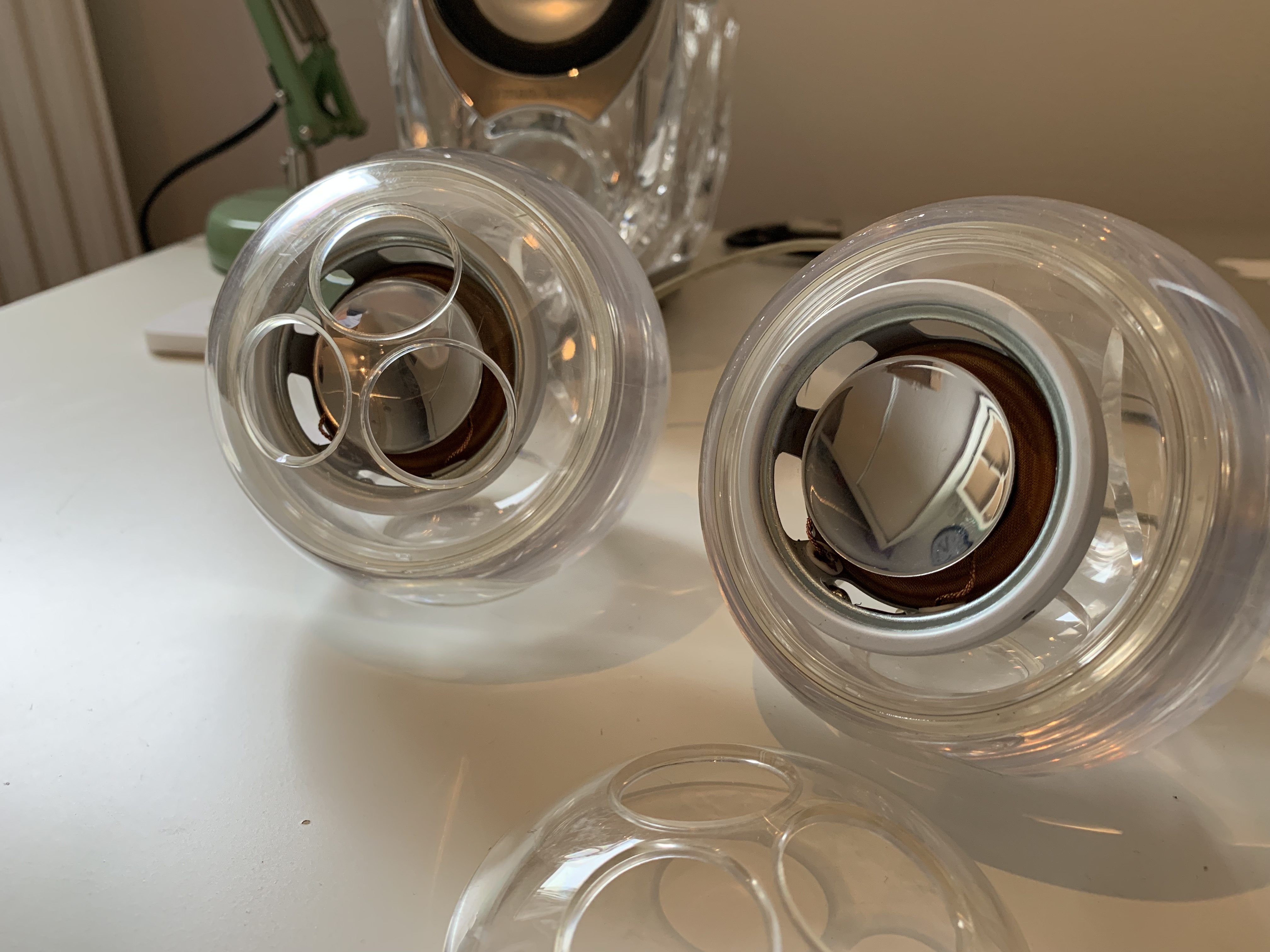

So... I was digging in the garage when these appeared, which I thought were long-gone-
The amplifier still works, however, those baffles...
Anyone know a good source for baffles that will work with these, other than the 'bay? I'll go that route if need be, but I thought I'd check here first if anyone has any experience with restoring these bad boys...

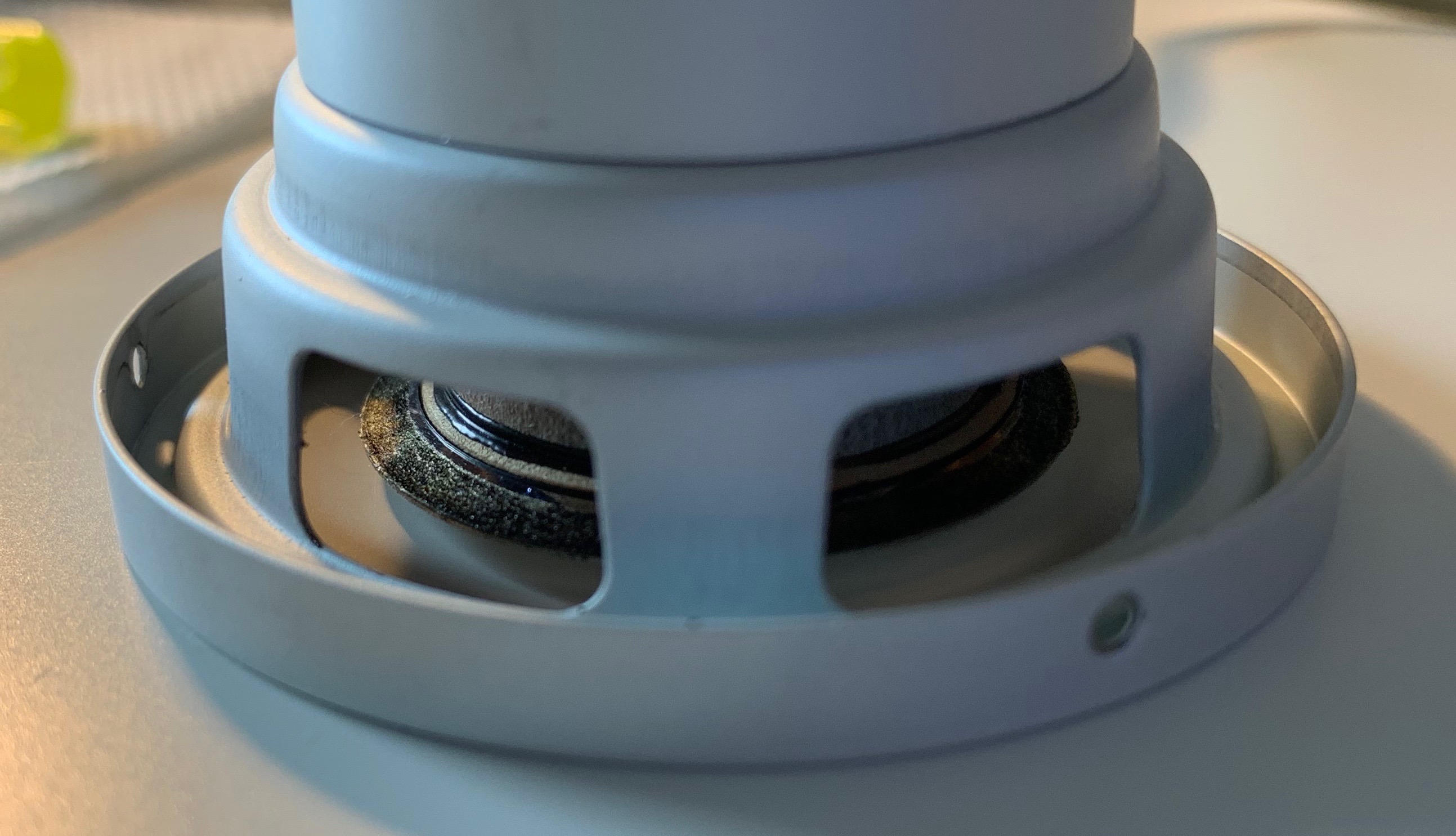

Taking a closer look at one of my own speakers, it looks like the foam / rubber (which is it?) suspension should be replaceable just like on other speakers (found some videos of people replacing them).
It's glued on top of the outside border and below the center part of the speaker. Don't know if that makes a difference as to what type you need, dimensions shouldn't be too much of an issue judging from a quick web search.
Could be hard to remove the old foam on the underside.

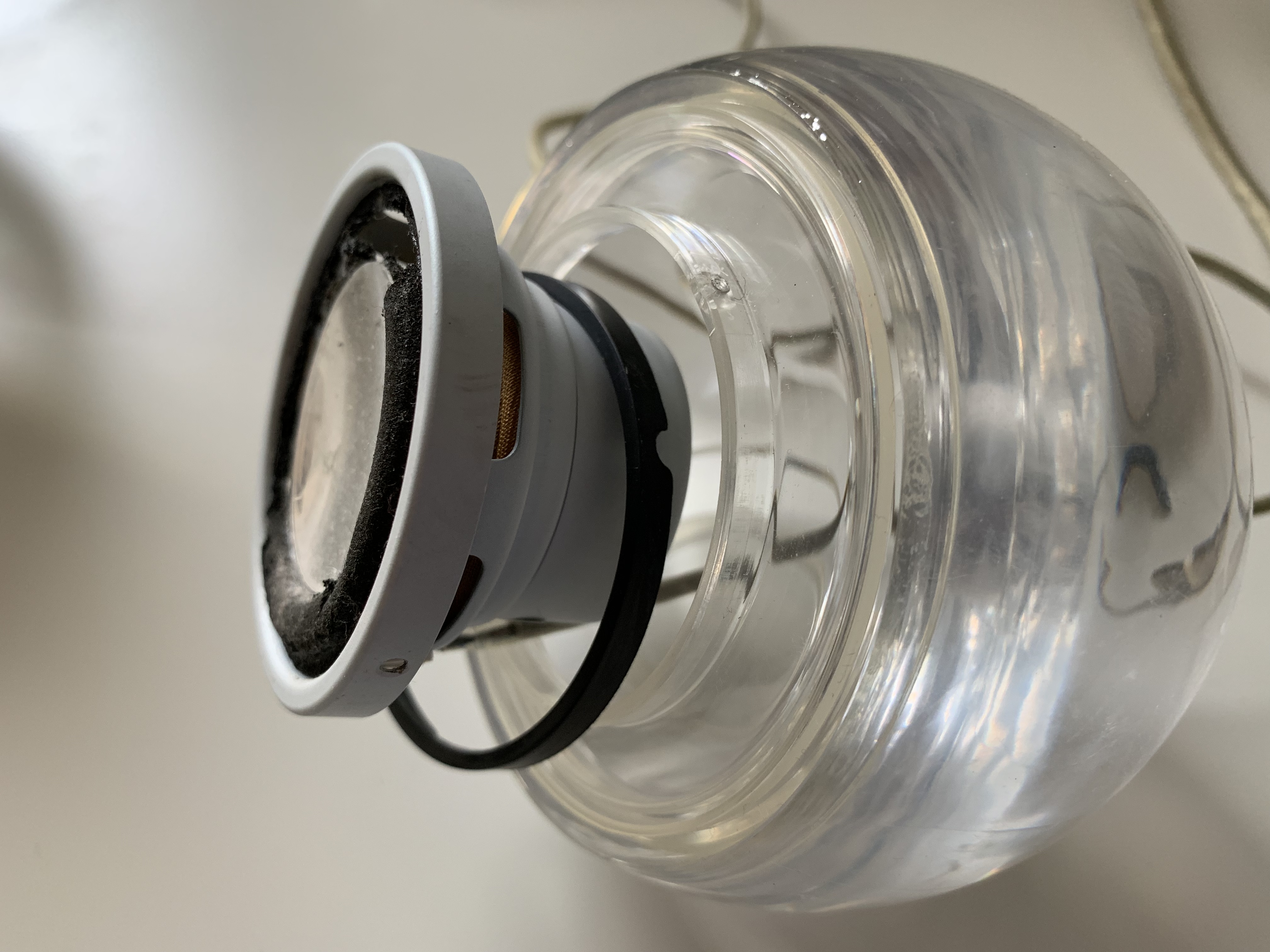

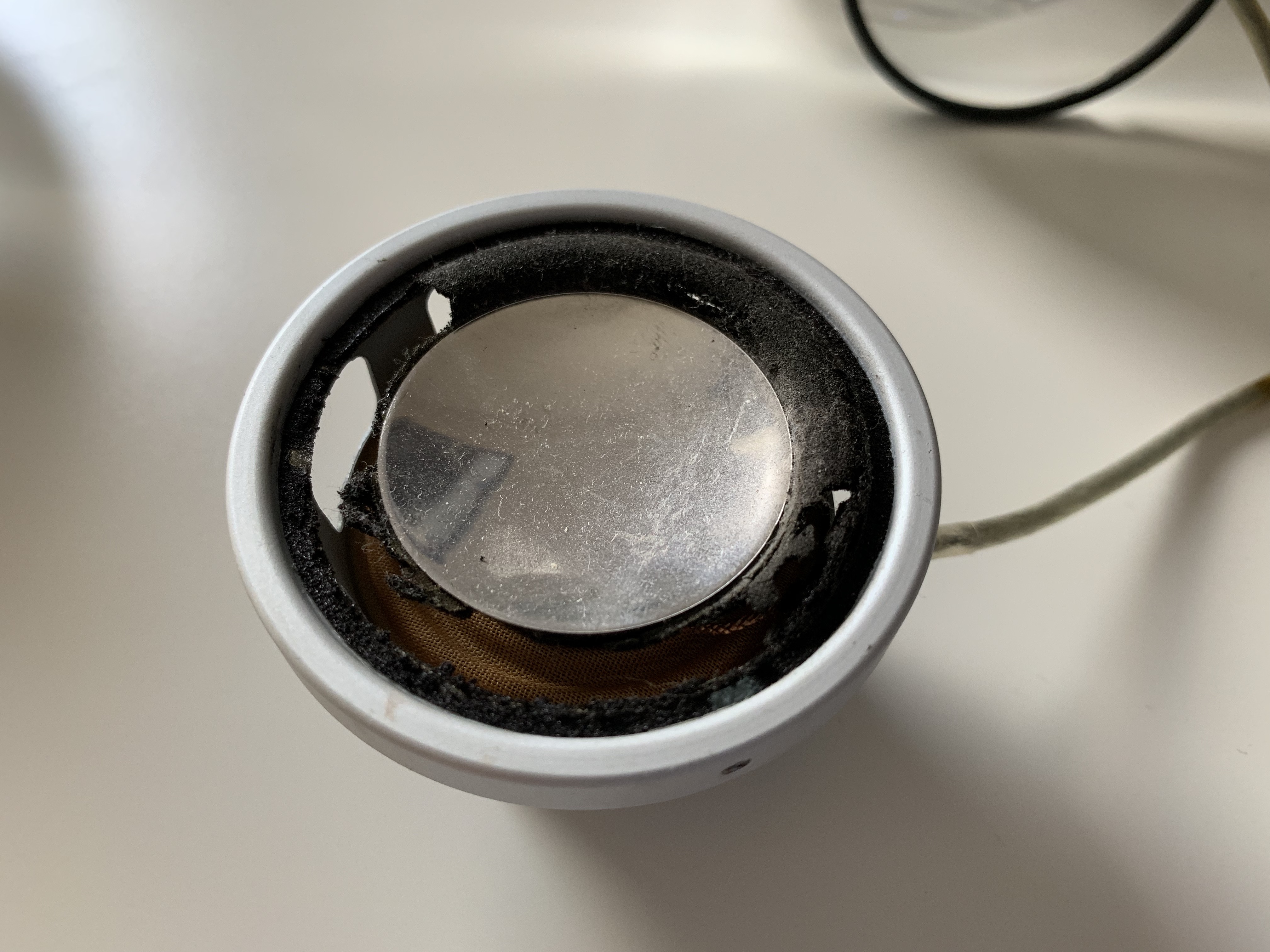

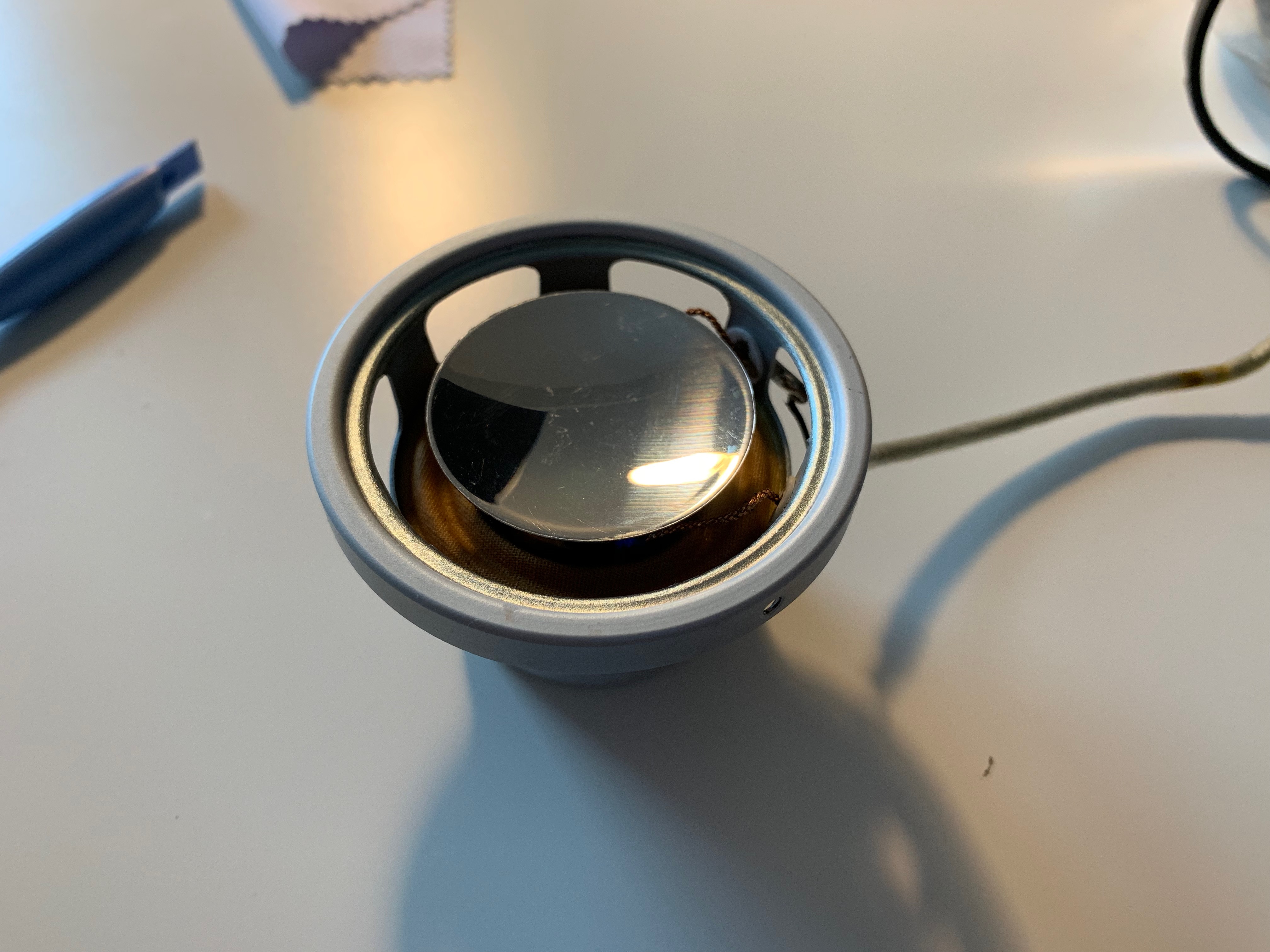

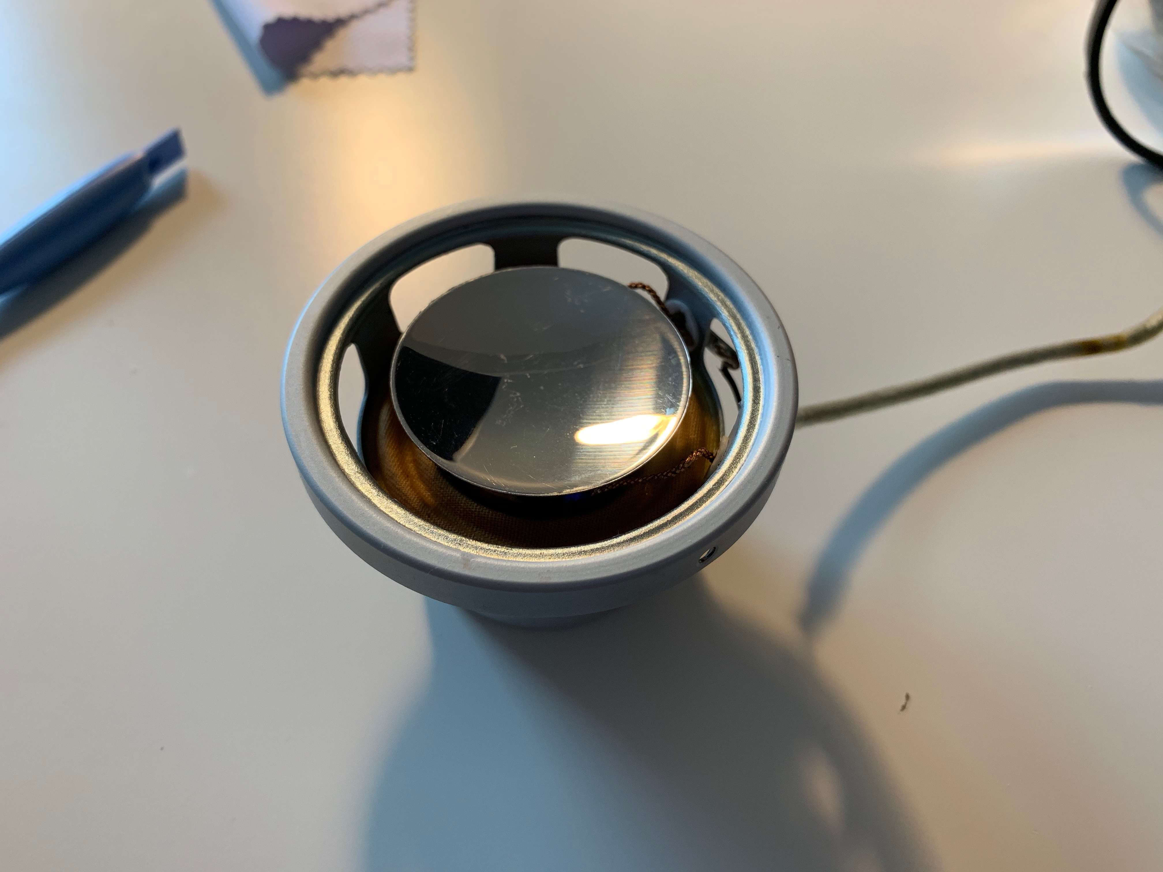

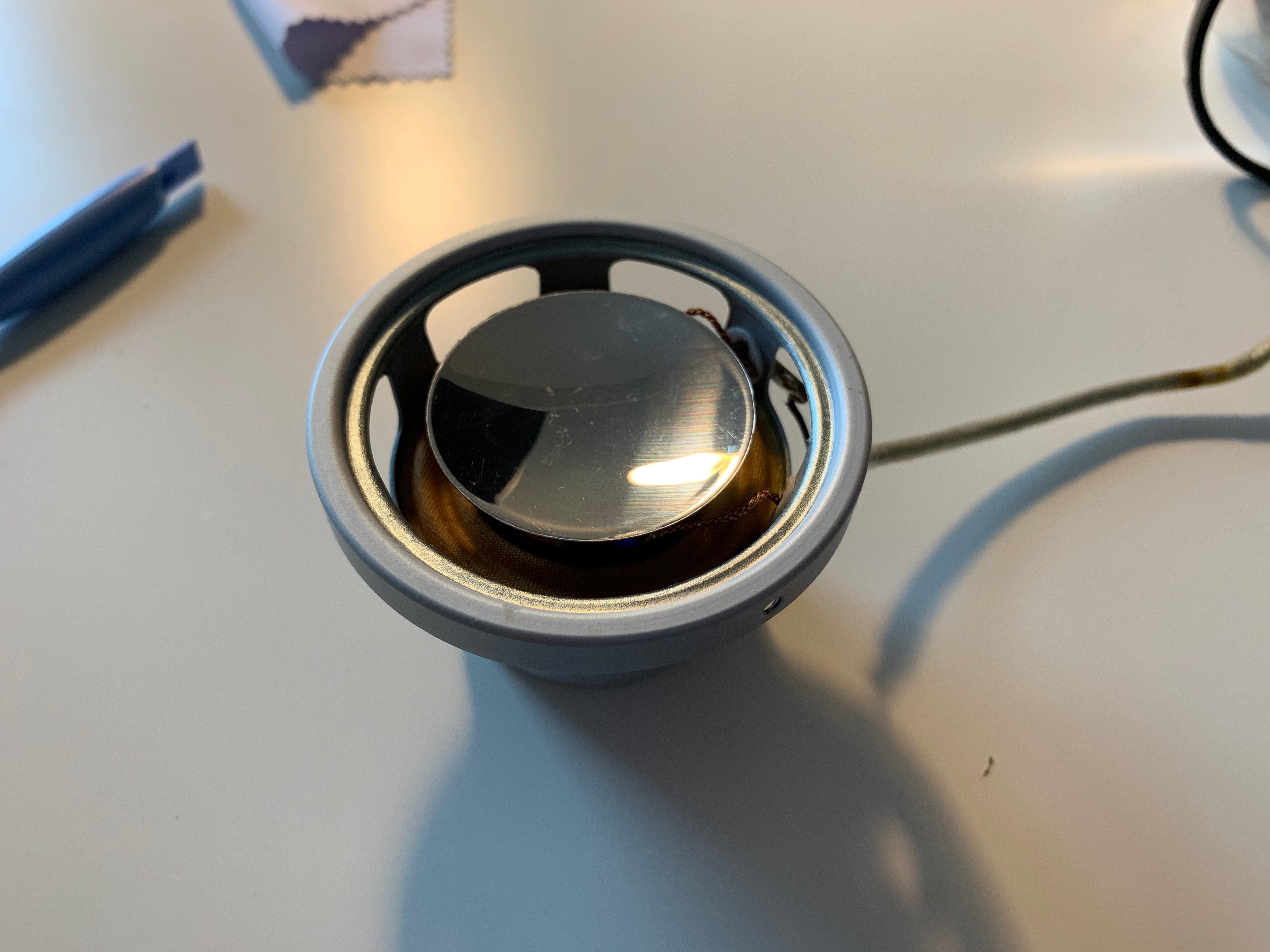

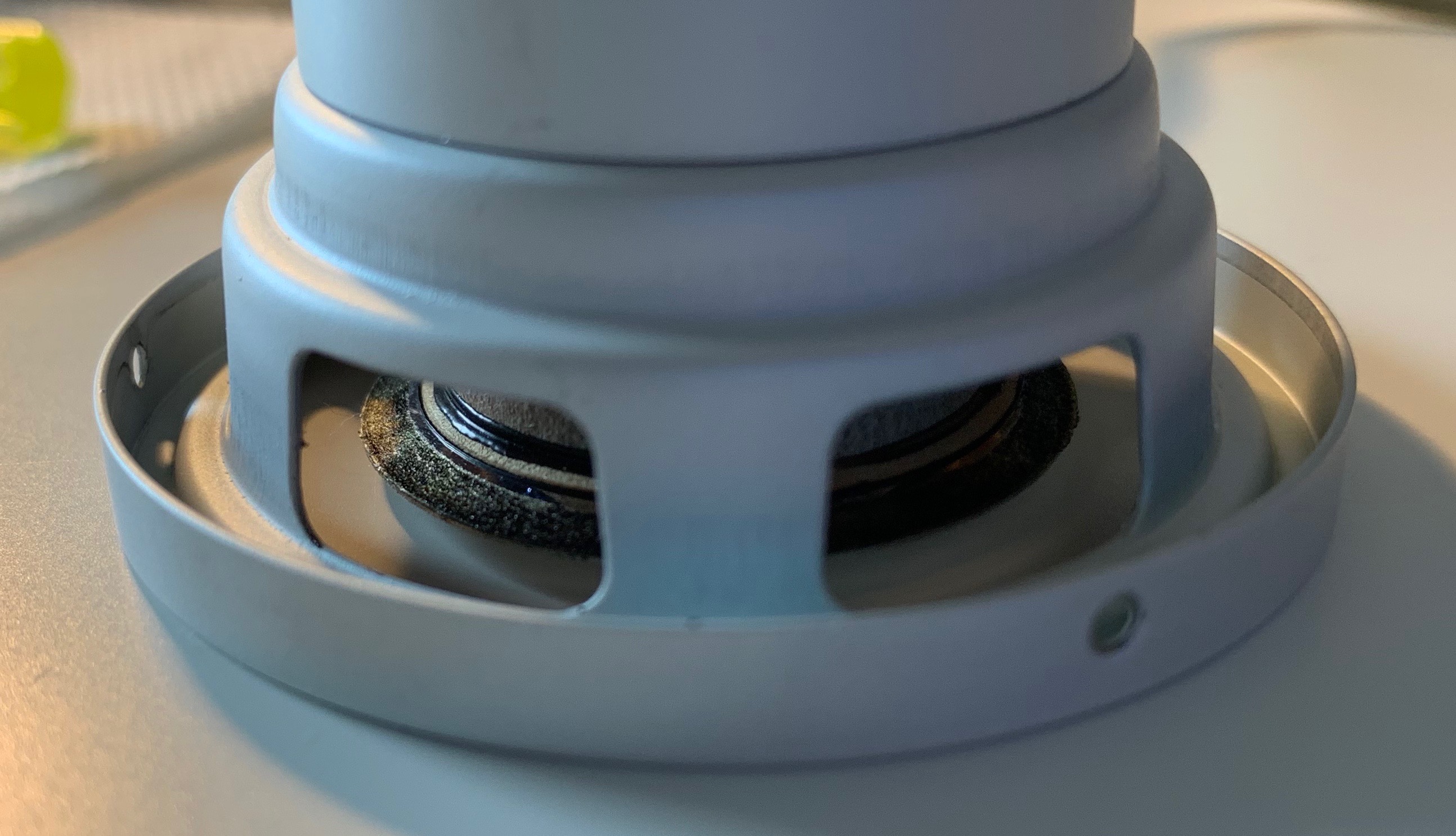

Update: managed to remove the foam after some scraping and cleaning (click for detail):
Underside was the hardest, used a few q-tips with white gas (correct term for Dutch 'wasbenzine'?, not to be confused with white spirit). It's a sticky mess, hope replacement foam will adhere.

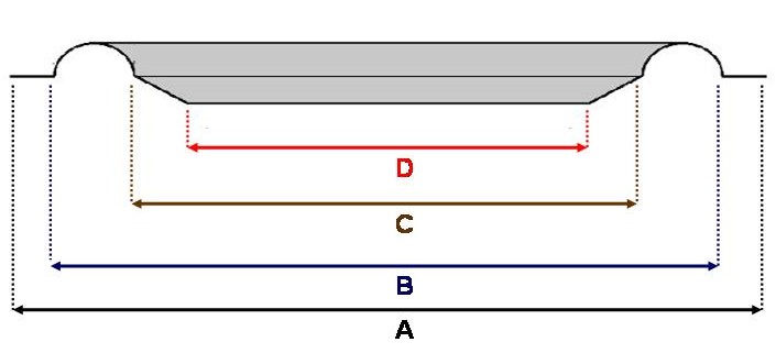

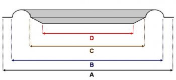

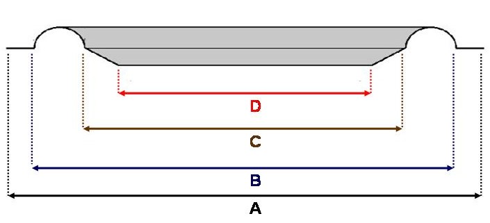

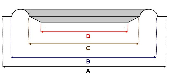

Next, I searched for 2" / 50 mm foam rings and I think this might be right (Dutch). I will buy them and try to glue them on, post results afterwards. Not sure if they fit, but this is the best size I found.
Edit: measurements of the foam I ordered:
A: 50 mm
B: 43 mm
C: 35 mm (size of shiny middle part)
D: 28 mm

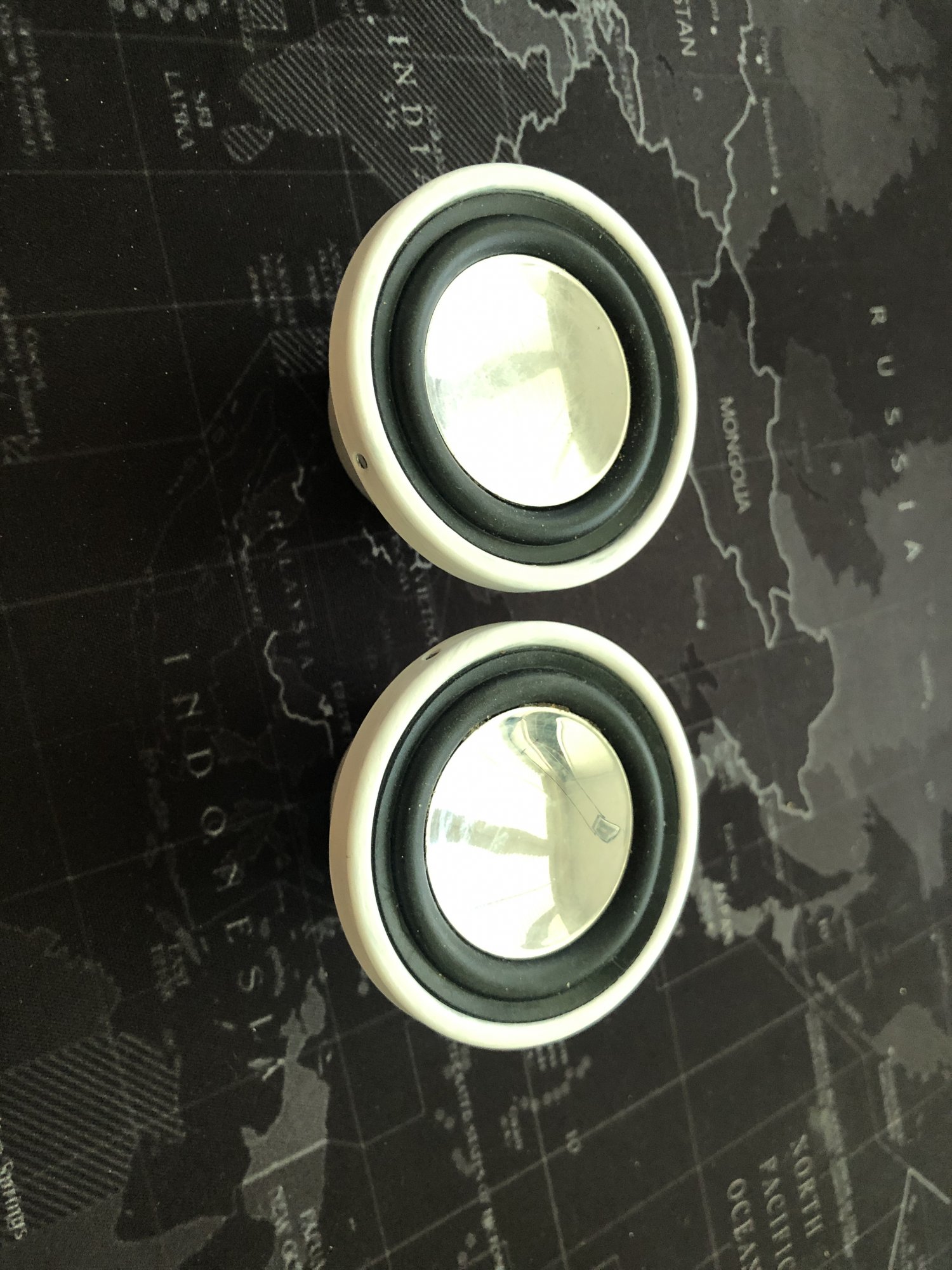

Both cleaned:

Good info. From measurements just taken from my Cube speakers it appears that the replacement speaker foam you've ordered should be an exact fit. Couldn't quite understand though if their price indicated is for one speaker piece or a pair.
A quick Google translate of the adhesive they show, indicates it's "Special water-based, flexible adhesive for repairing speakers." Just wondering what other adhesives would be suitable, or if speaker adhesives have specific properties.
A little more research shows that similar sized speaker 'rubber surrounds' (28mm / 35mm / 44mm / 49mm) are available from a well-known Chinese seller HERE. Very inexpensive too, and being rubber and not foam, possibly not so susceptible to rot.

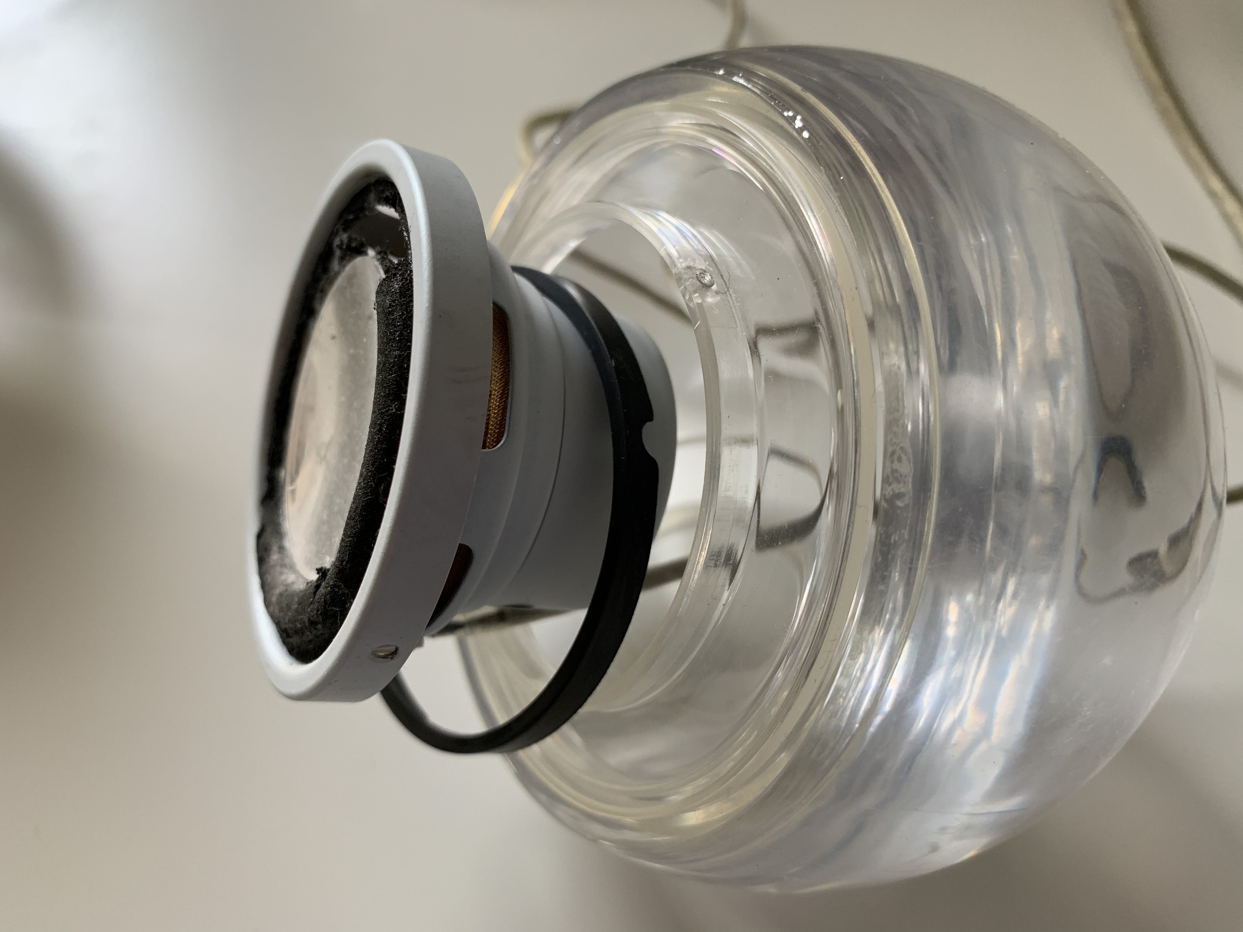

I rebuilt my own cube speakers a year or two ago using a beater pair of iMac G4 speakers. A few screws, a little soldering of the wires, and they're working and sounding wonderful. Can confirm, the iMac G4 speakers will work fine if you have a pair sitting around.
Thanks for these infos, as I have some too with the rotten rubbers.
I don't have them at hand right now, but remember checking how I could open the shell to get the speaker out...
Seems to remember it was glued ? How did you disassembled these please ?

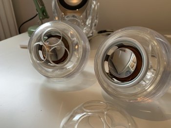

Not much of a disassembly, the speaker can be taken out of the transparent casing by unscrewing the three small screws. The speaker unit is connected to the wire that runs out of the back of the casing, don’t pull the speaker out but rather push the wire in from the back. If you pull the speaker, the wire may break away. Pushing the wire inside the case may be a little difficult as the wire can be sticky.

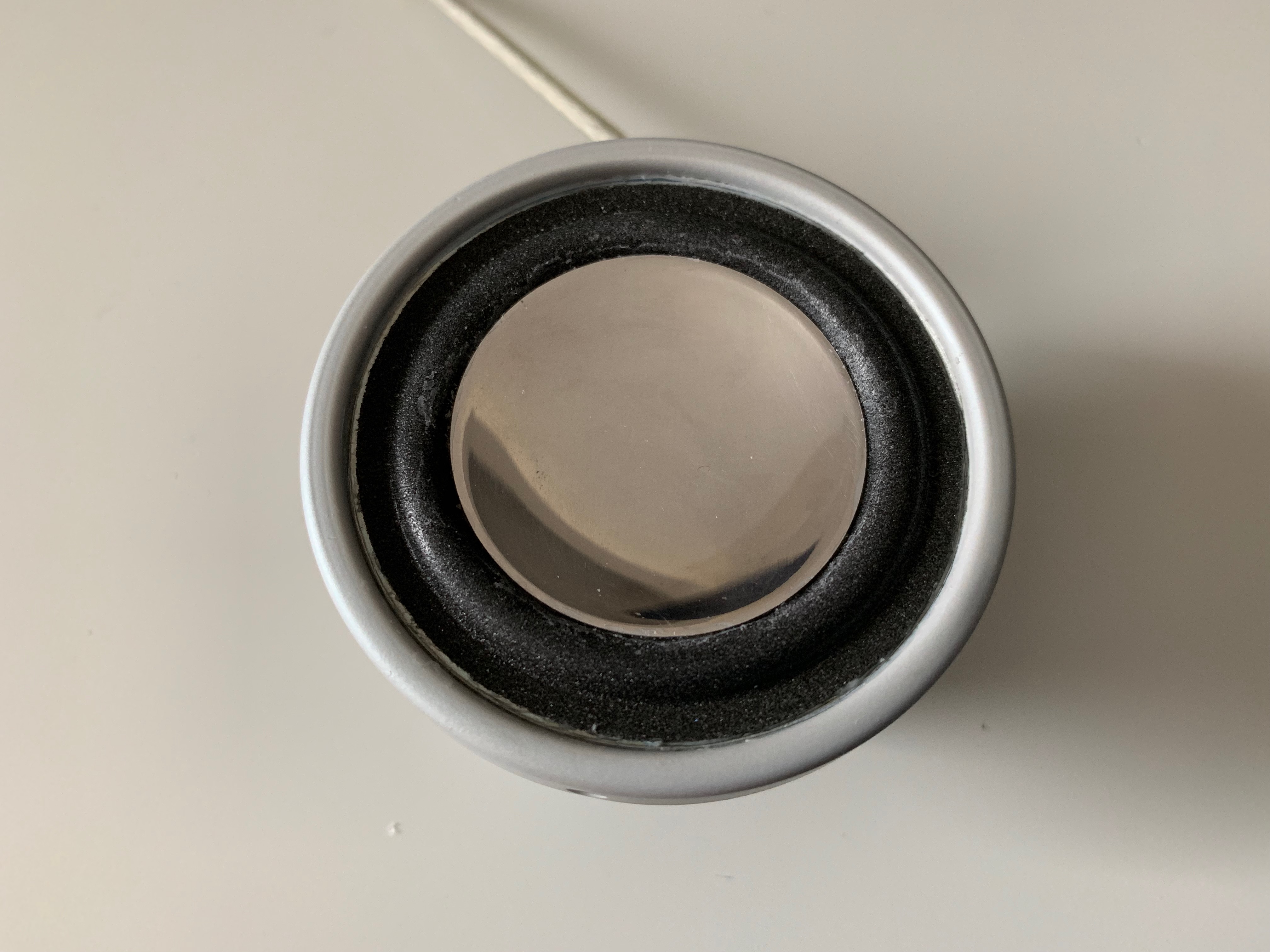

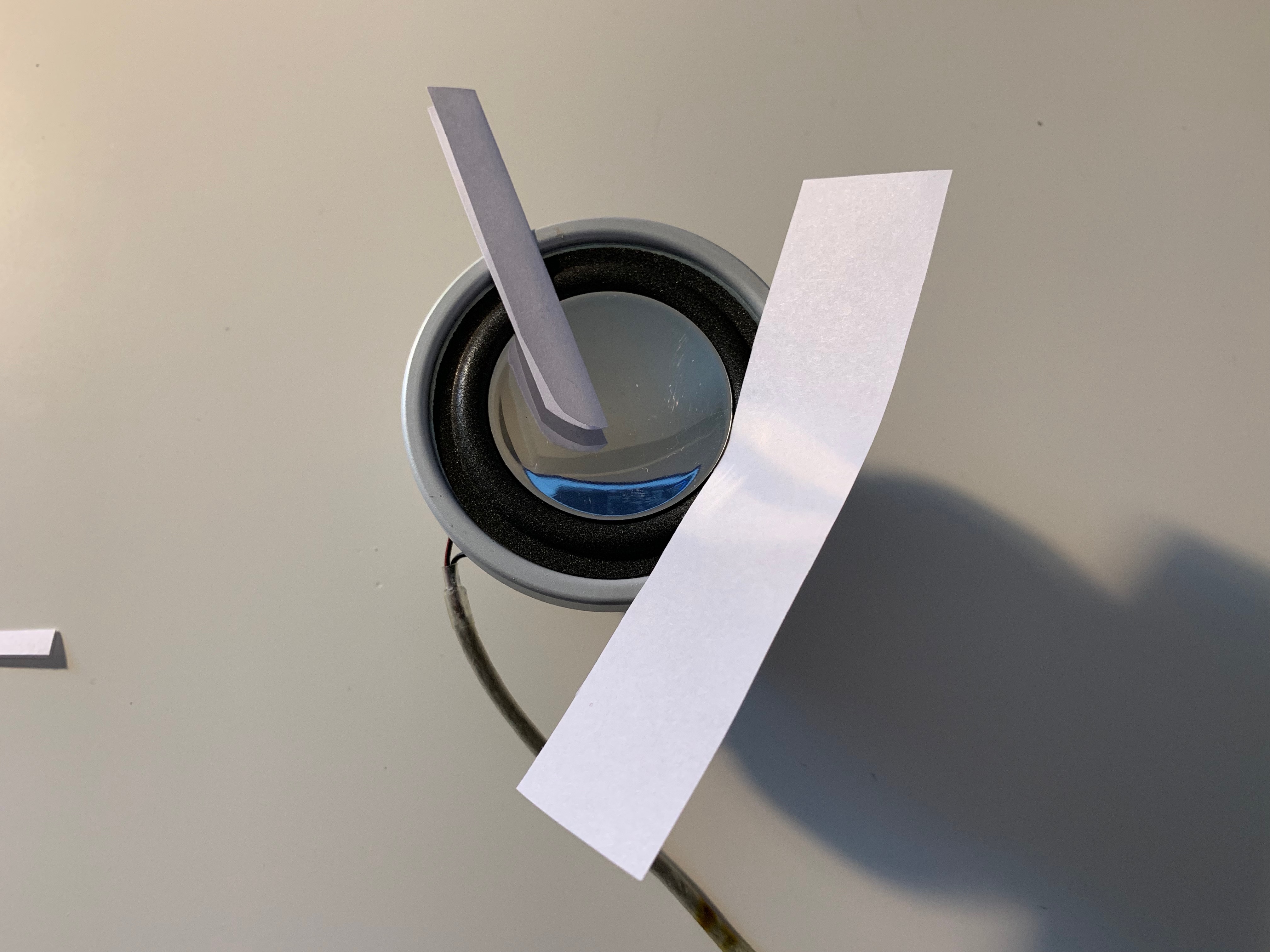

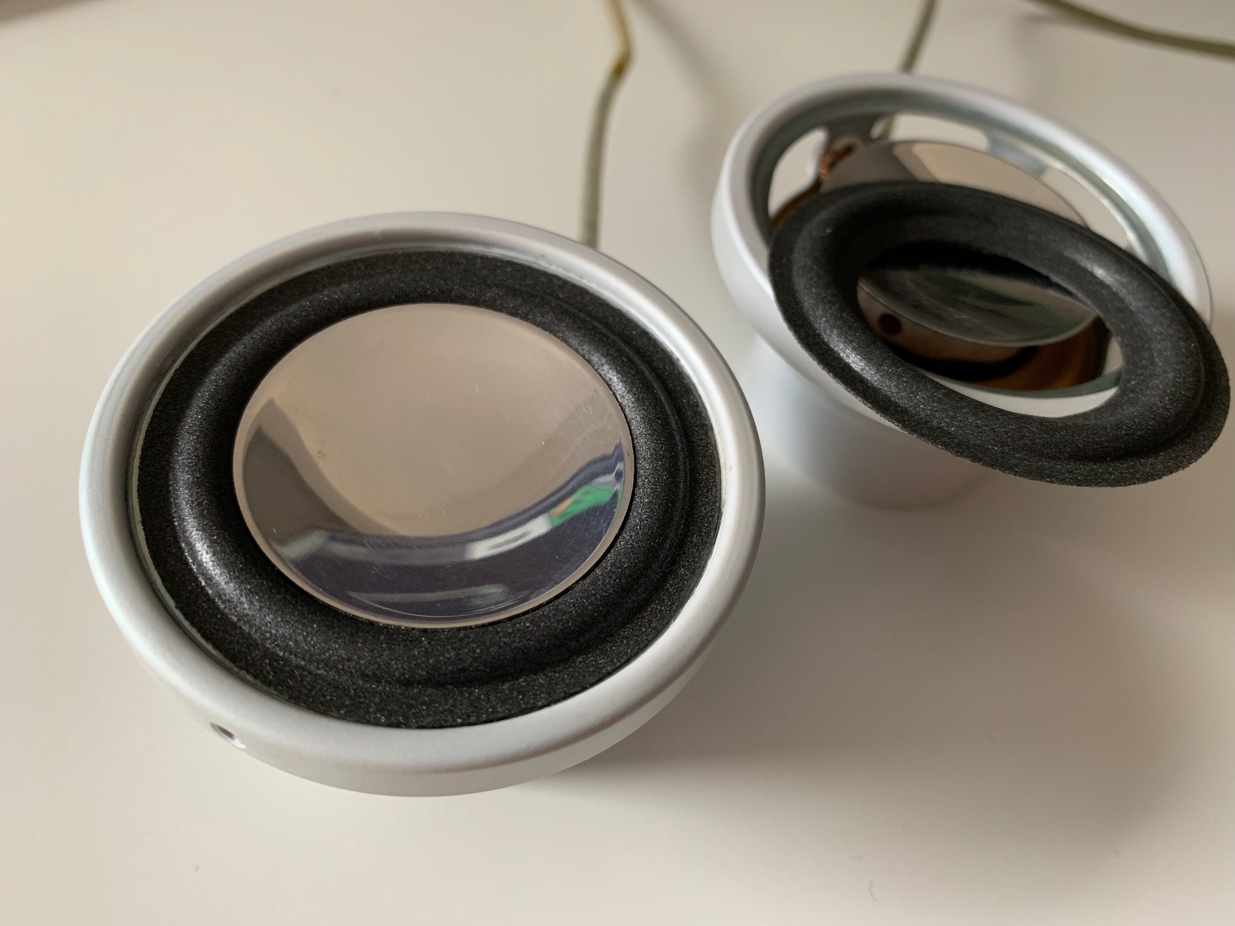

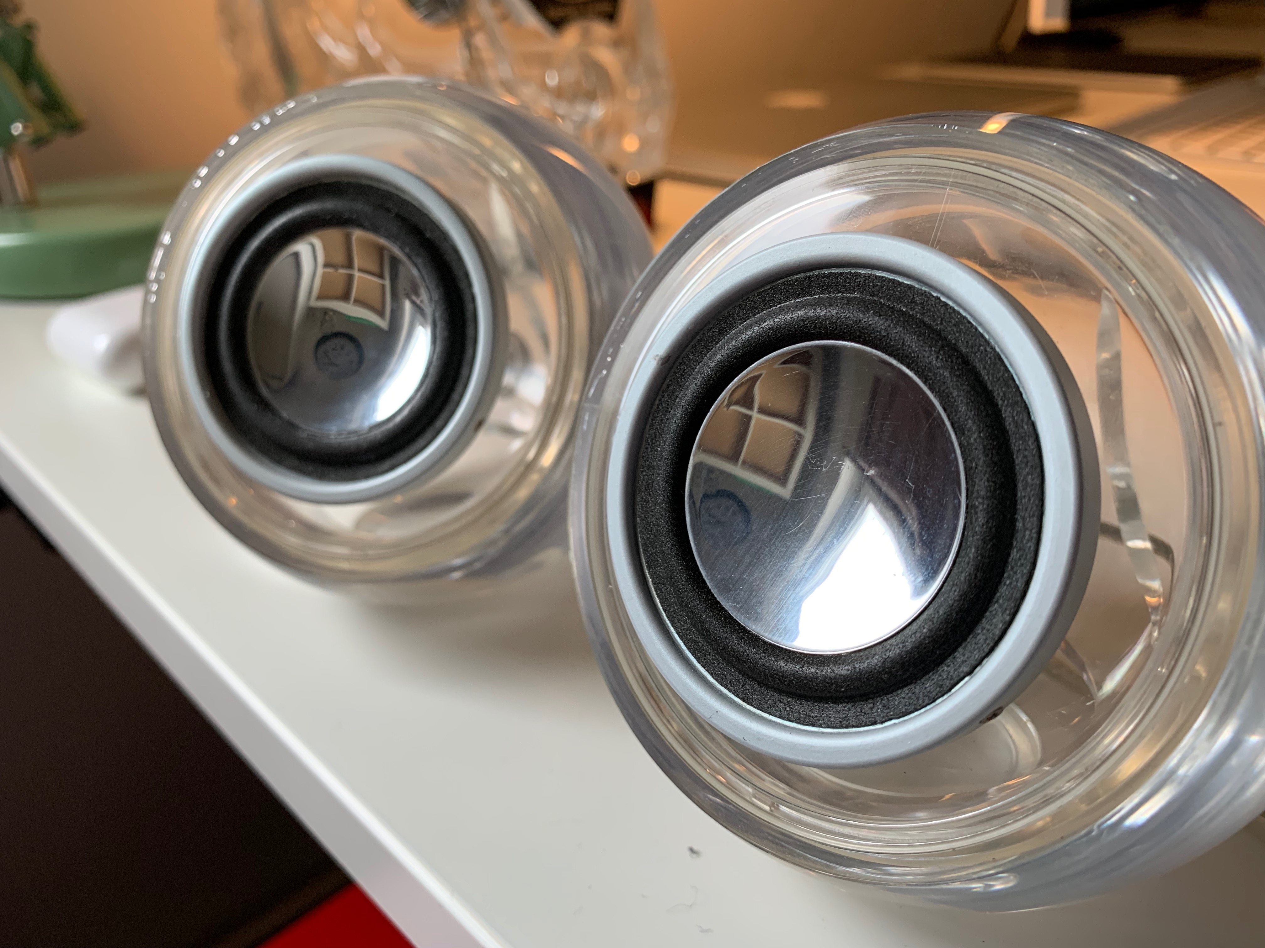

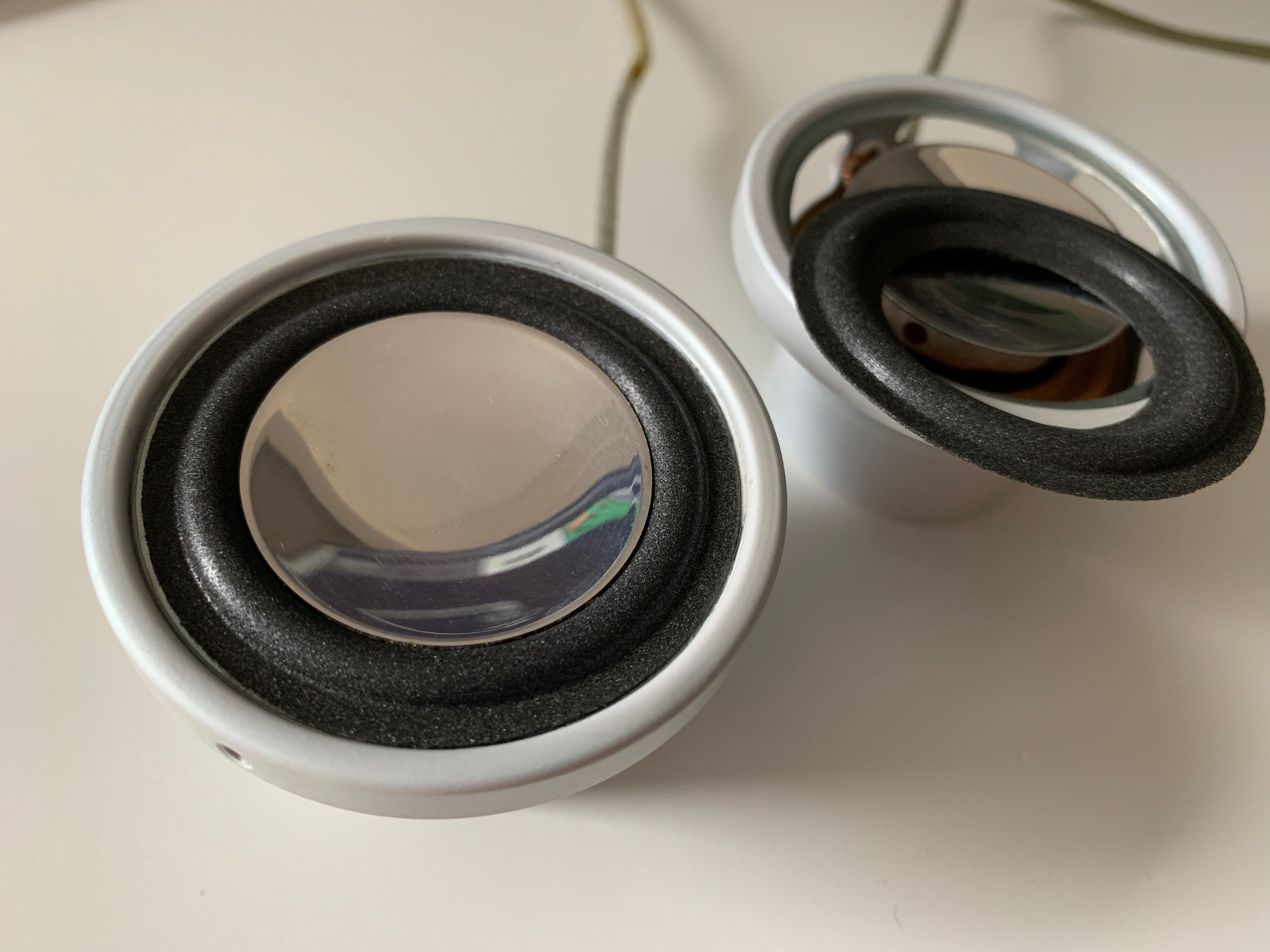

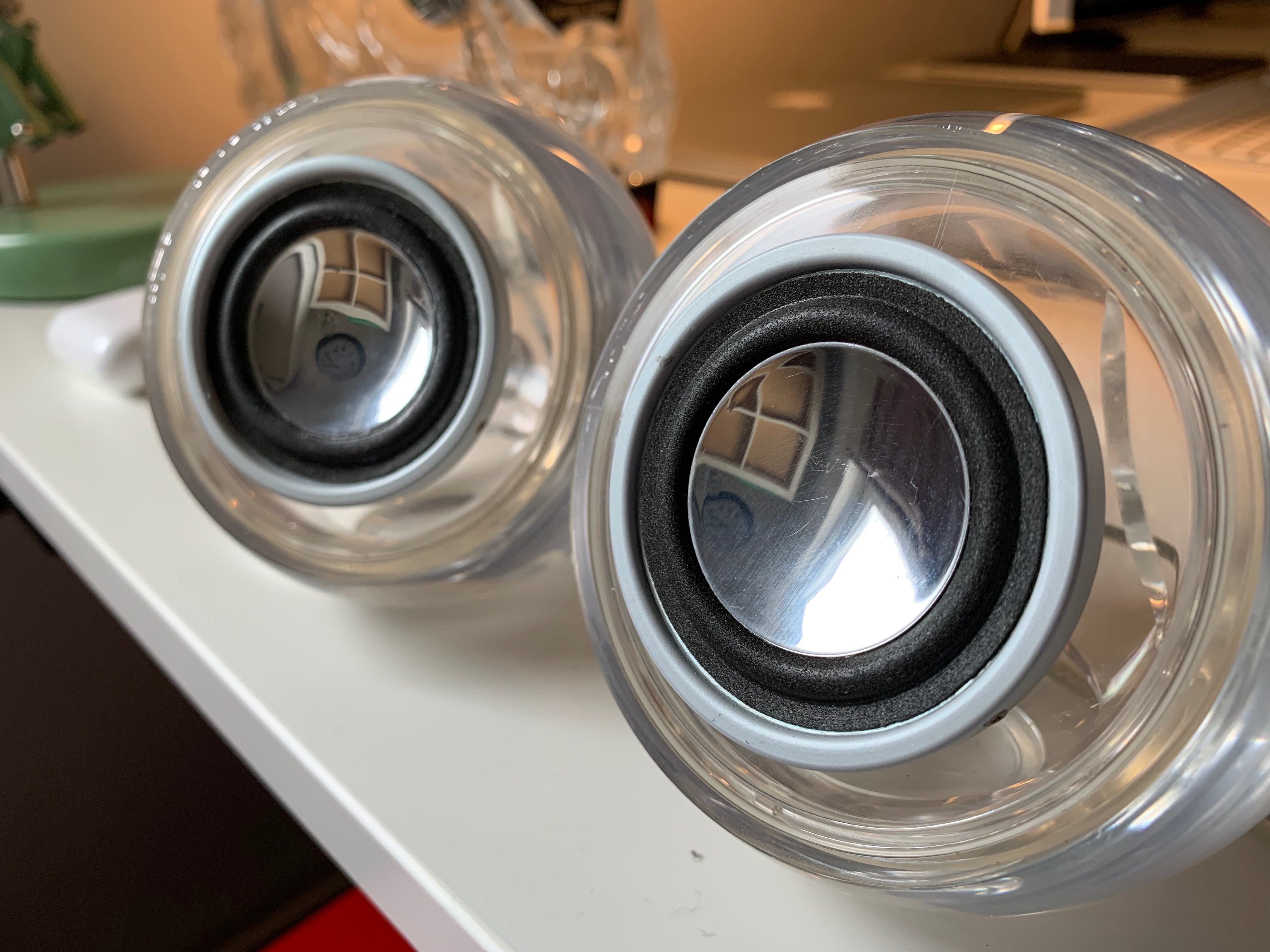

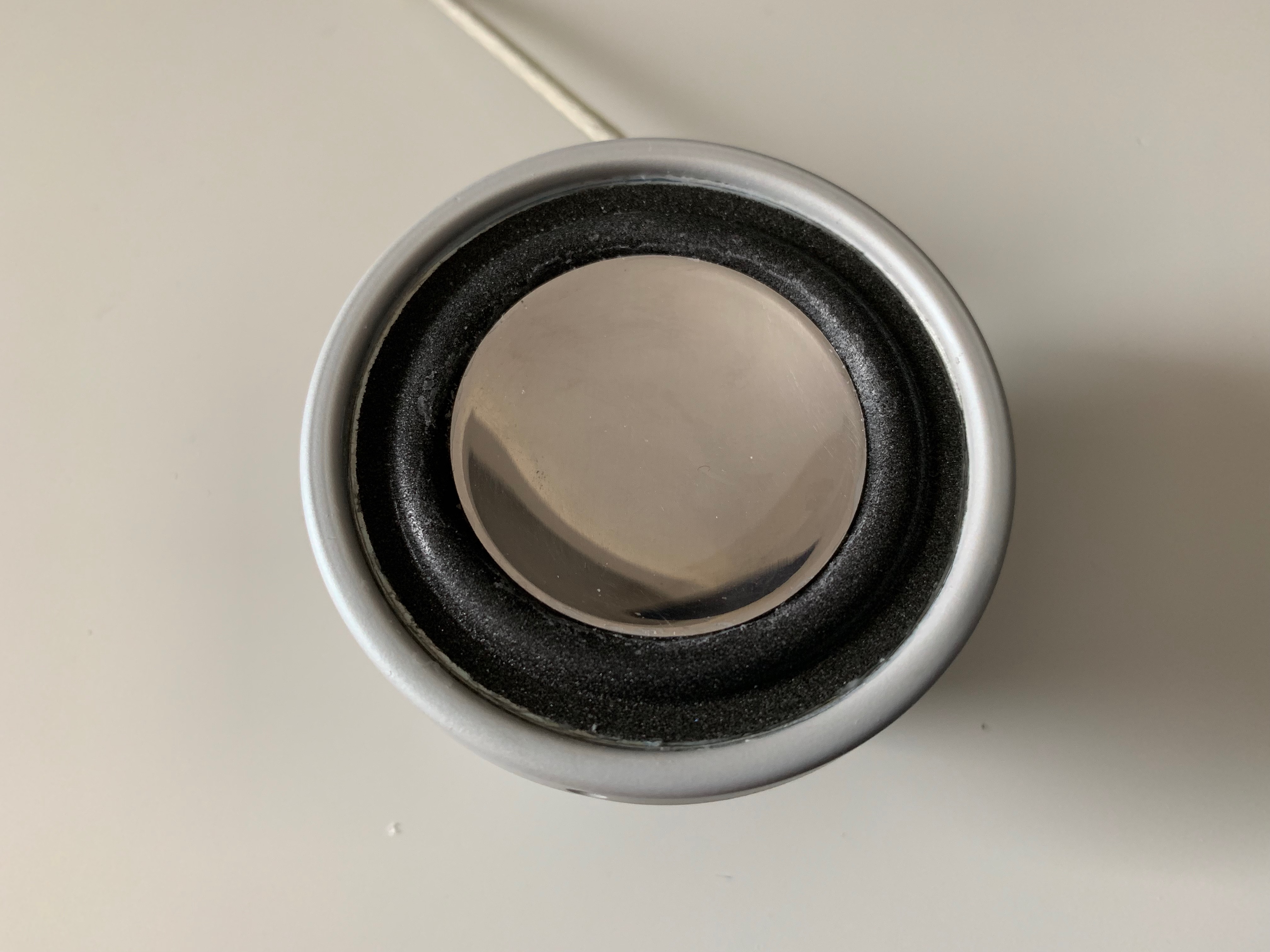

Sooo, the 'surrounds' finally arrived in the mail today, spent a few hours glueing it all together.
First off, the rings fit quite snugly. Maybe the inner ring (size C from this post) sits too close to the mirrored part, but it works. It's hard to get them underneath the mirrored cap, so I figured that should be done first before applying the glue.
This was the first speaker I did. Used white wood glue and that stuff gets messy when it gets on the black top. Tried scraping it off, it looks a little better than it did in the picture below. The wood glue hardens quickly and ruins the flexibility of the surrounds when it gets on top. Also, they originally had a black ring (1mm width) to cover up the gap between the foam and the metal on the outside, haven't figured out how to replace that but it's not too important.
For the second speaker, I used a transparent water-based glue for kids on the inside, trying not to leave such a mess on top this time. Paper helped as well. Still have to find out if this glue will adhere correctly. Outside with wood glue again.
The end result is quite neat, especially the second one I did. Looks miles better than it did before anyway. Not sure if I will even get to using them, their big brother that sits in the background blows them away anyway (H/K GLA-55, their spiritual badass successors).
I plugged them in when I had finished the first one (this is how you can connect them to a modern Mac BTW), the speaker with wood glue was already adequately dry and sounded a lot better than the speaker without foam.
I'm sure I could get called out on my amateurish DIY techniques by true specialists, and I'm not sure how this affected the sound. However, for my purposes, this was as much as I was hoping for. They look great next to my Cube and could be used if I wanted too (still looking for an iSub BTW).

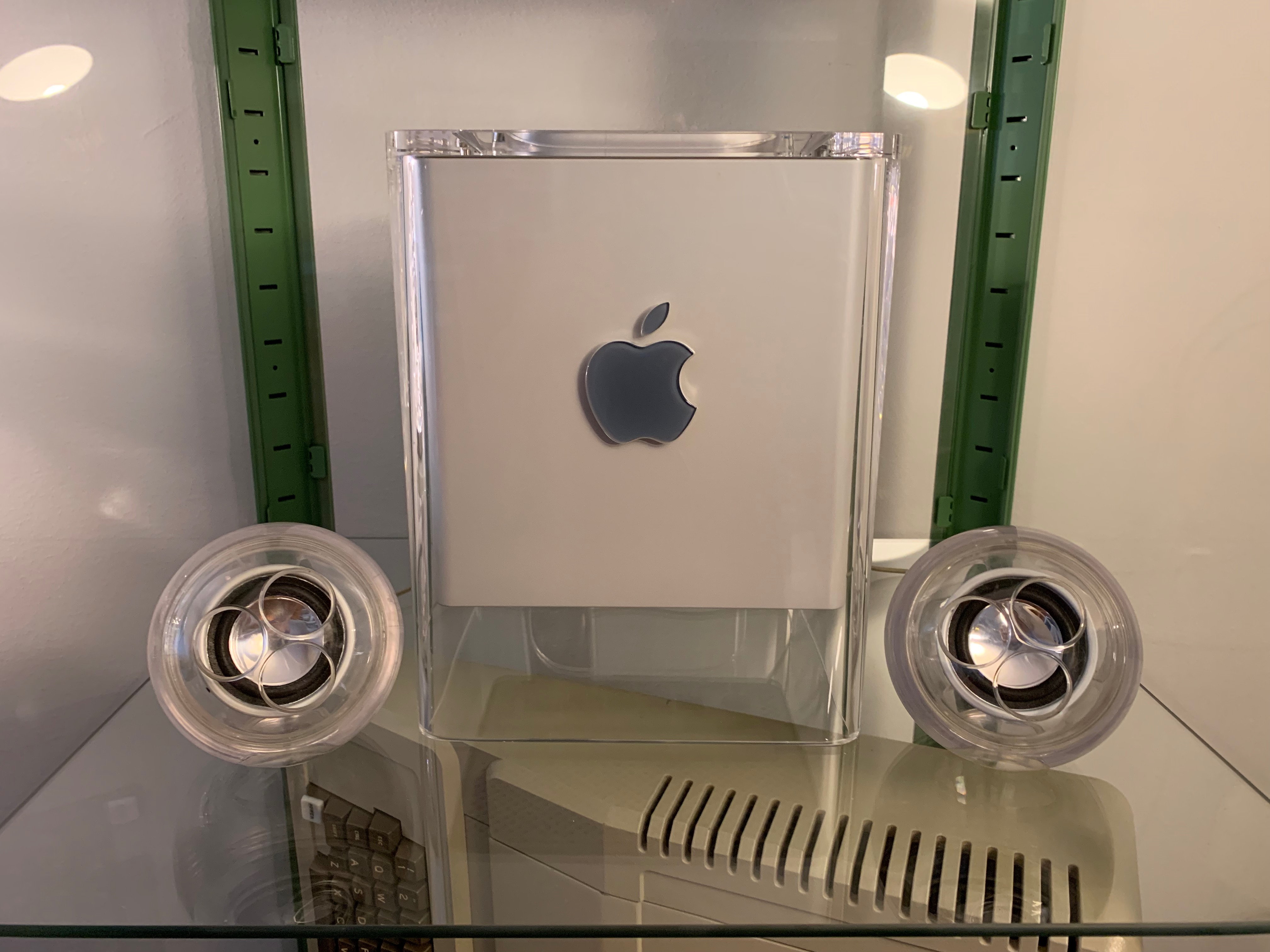

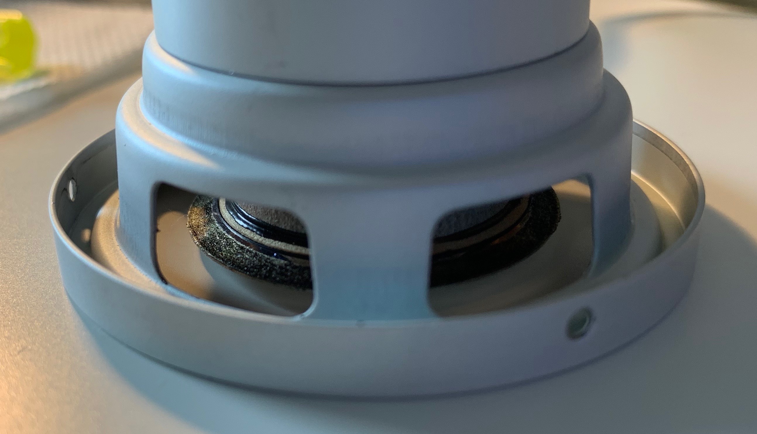

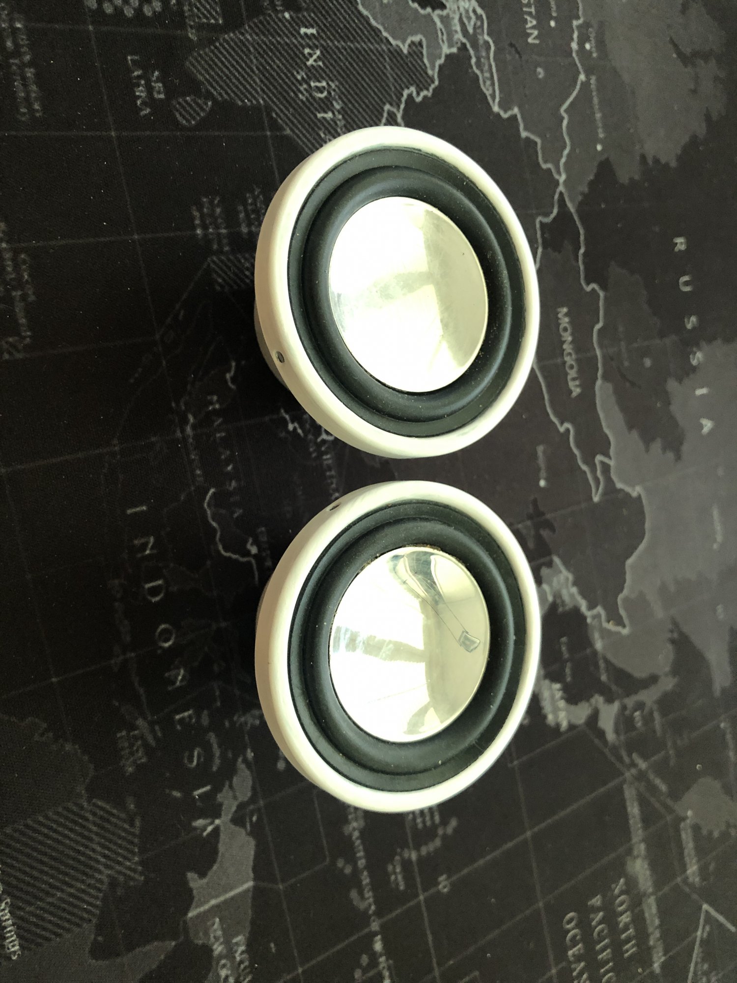

My Apple Pro speakers sound like new again. 🎶 🔊🎶🔊🎶🔊

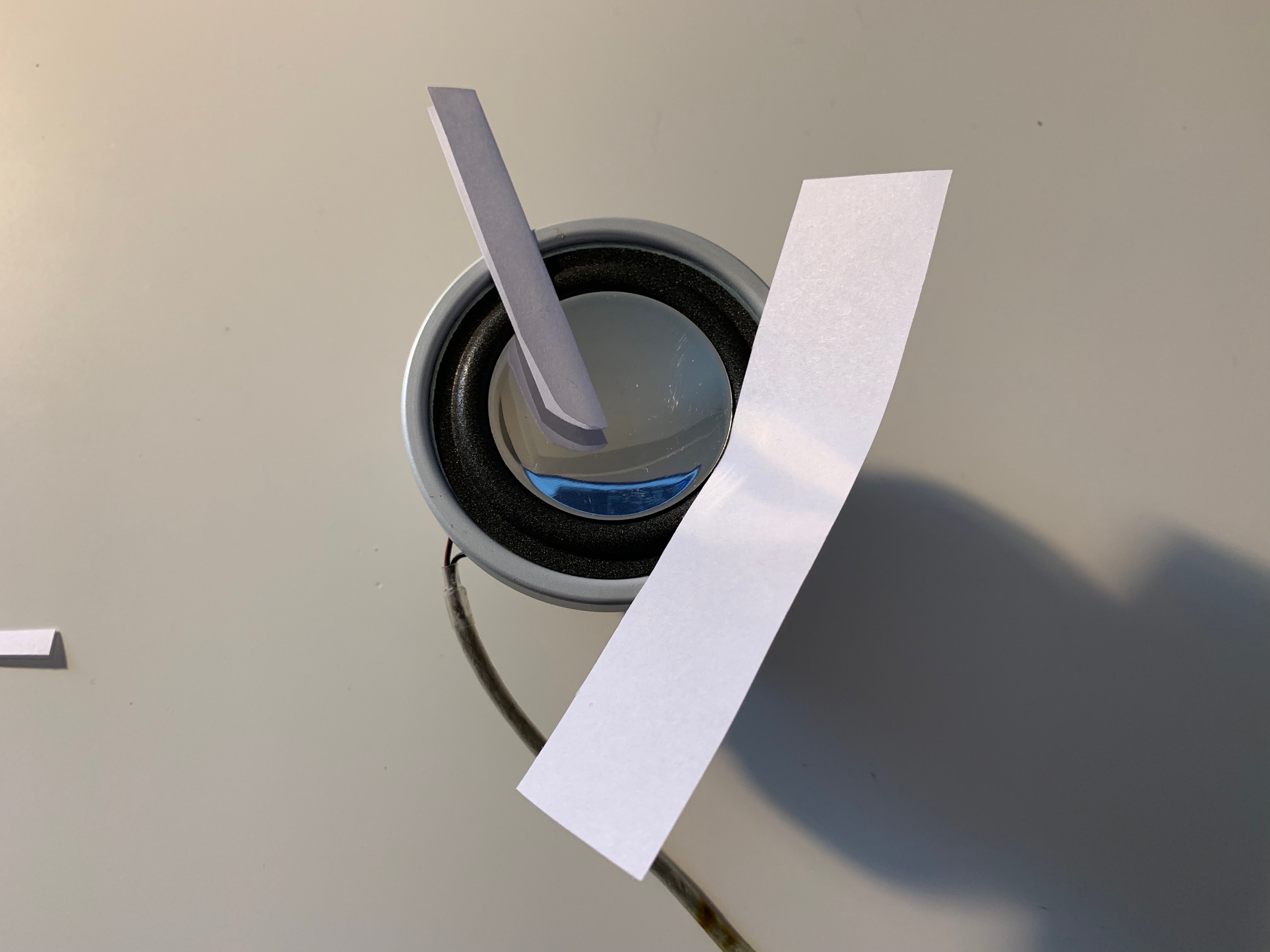

But removing the old foam ring was quite disgusting. The foam disintegrated into sticky black crumb.
It turned out, that the best way to remove the old foam and adhesive tape is to just scrape it clean.
