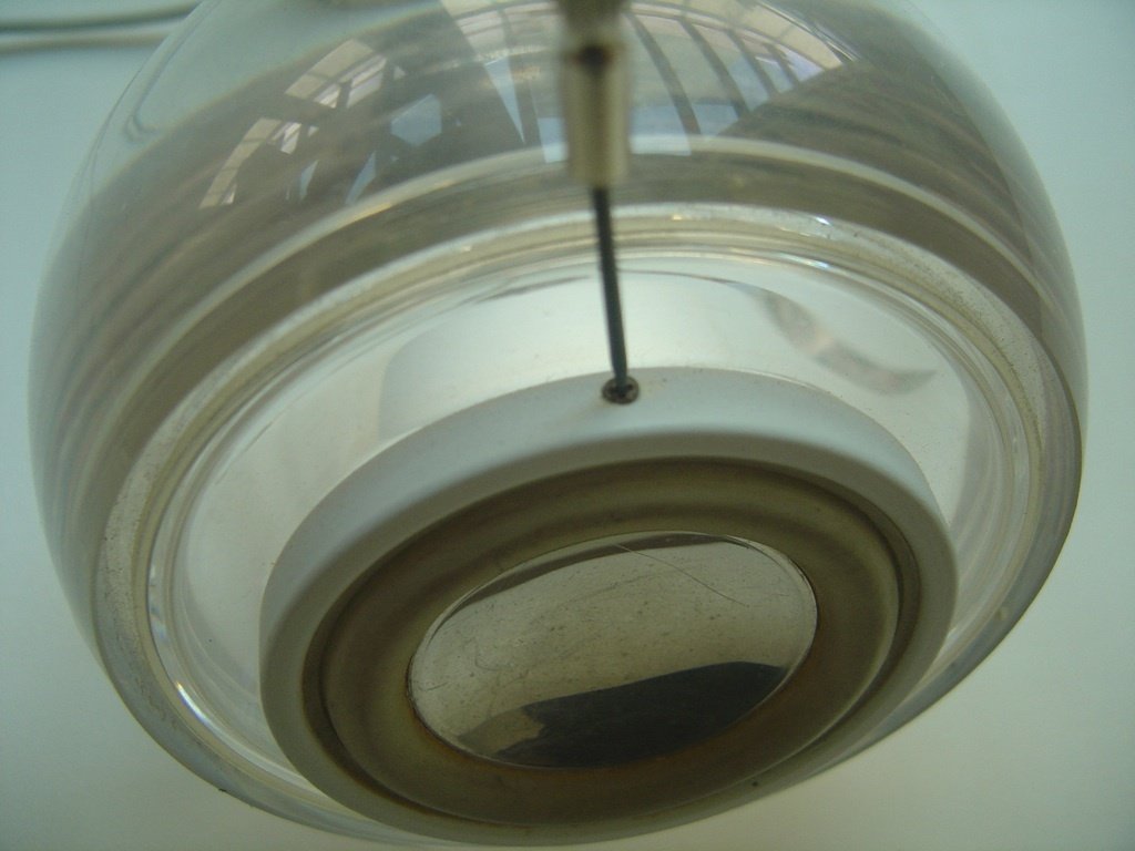

Thanks Sunapple for your ideas. I have ordered rubber cones from here; https://nl.aliexpress.com/item/1005001963172688.html?spm=a2g0s.9042311.0.0.45f44c4dTrp9Vd
Less then $2 and free shipping from China. I ordered the 50mm ones. They come with a black metal cone in the middle. With some alcohol you can remove the metal cones. The rubber cones fit perfect in the Cube baffles. I also ordered black rubber/metal flex glue for €12, so this should finish the job.
Hi. I have ordered the same rubber.(recently got those speakers and foam seems to fail apart, although better than OP speakers) How to put rubber in? Is glueing necessary?
I certainly think that glueing is necessary. Loose cones might give a distorted sound. I glued the inner part of the cones before installing. Then when they fitted well I went around the outer part with glue on a small metal tool. I used black glue so it won't be visible when finished.

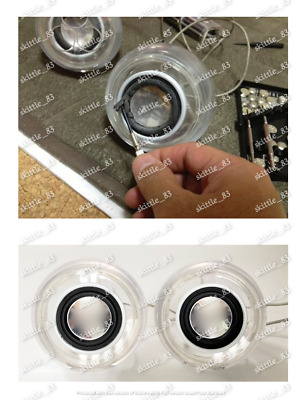

Thanks. Applying glue like this?
And rubber can be simply pushed in?
