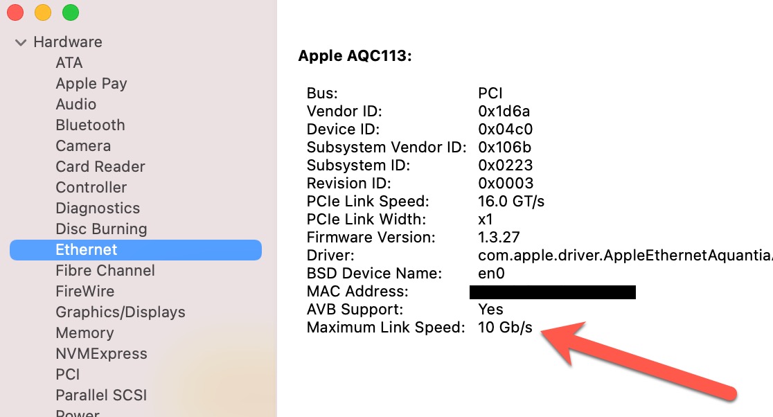

my laptops don't have ethernet connections, but doesn't System Information -> Ethernet provide you with the info to settle this question?
It does indeed.
