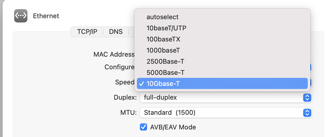

How are network hardware preferences set?
Reactions: BeatCrazy

Finally, go into your iMac's System Preferences, Network, Ethernet, Advanced, Hardware, Speed -> see what the drop-down says per the screenshot from @HDFan directly above this post. Leaving the drop-down on Auto is fine.

Okay some news…
Confirming that the iMac has shipped with a 10G ethernet card…
Confirming that my internet connection is 1gig max…
Setting the network settings to 10Gbase-T results in an unstable connection that briefly connects and disconnects … which makes sense as its attempting to go faster than the network… so no surprises there…
Changing that setting to 1000base-T has resulted in ~500Mbps up/down same as the OWC TB4 HUB/DOCK thing…
However… it’s done this in the past and for no reason it just drops down to ~100Mbps with no change to any of the settings….
I will keep an eye on it, but for now I’m using the iMac ethernet port at speeds that are acceptable given the network speed and port type…
Apologies for my confusion in my initial diagnosis of the potential problem… in hindsight this was premature…

Have you checked your iMac?
In Catalina this is what you do:
System Preferences - Network - Advanced - Hardware - Speed - and scroll to find 10Gbase-T.
If you find that then you have got what you paid for.
