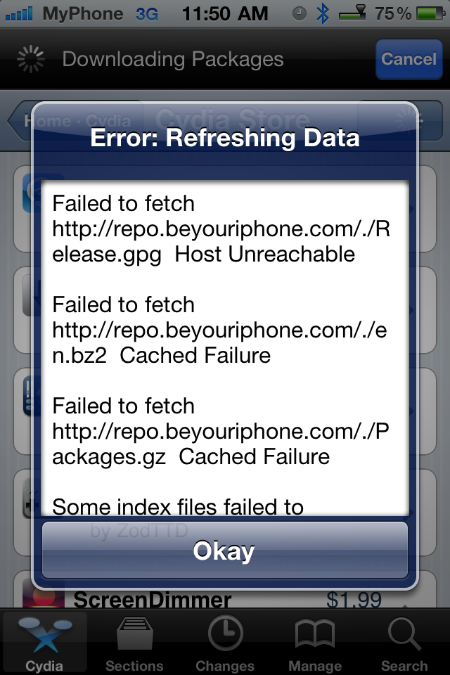

How Can I Get Rid Of This Error That Pops Up Everytime I Open Cydia?

You can't except to wait until there's not a bazillion people hammering the servers constantly. Keep trying, it'll work eventually.
still
its still doing it. everytime i open cydia. i tried to add that source but it errored out, and doesnt seem to be a way to get rid off the source attempted.

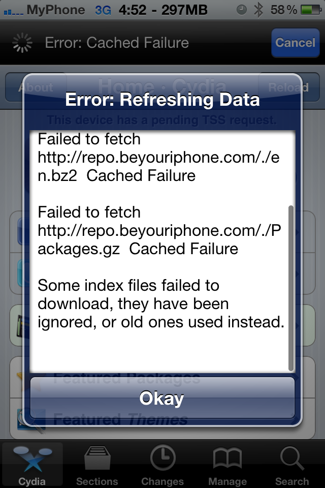

aww, someone please help. this is soo annoying for this pop up everytime i enter cydia.
you just have to wait, there is nothing else wrong but the server are busy.
Remember this are 'donations' maintained servers, unless you donate enough to keep a full dedicated server up and running with massive bandwidth all you can do is wait

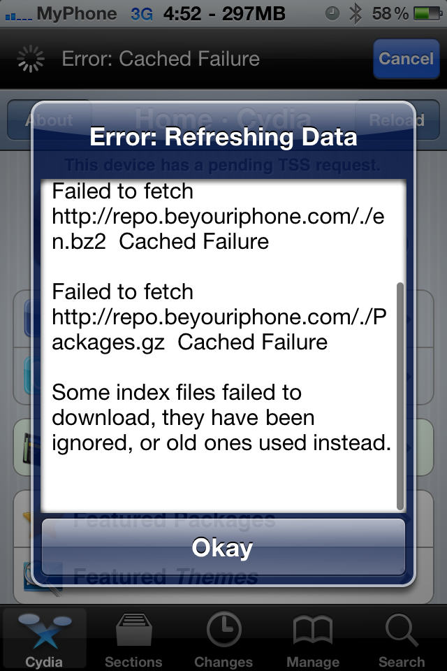

i have done everything, i disabled it in rock and cant find the source in cydia since it was never a good repo. i have rebooted and everything, switched from wifi to 3g for hte last 2 days and still everytime i open cydia this happens. it doesnt affect anyting, but still very annoying.
