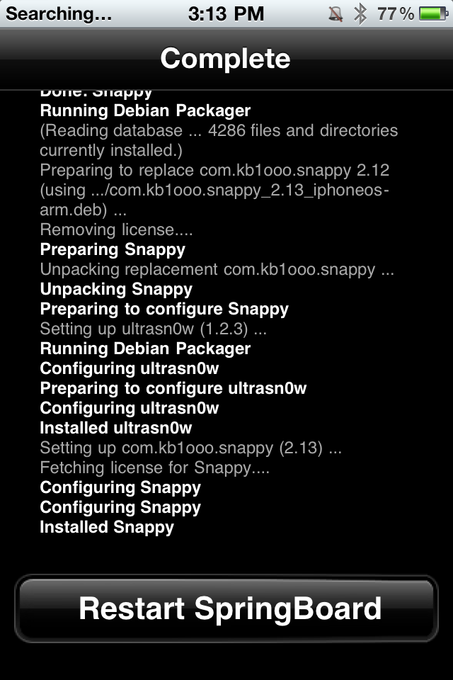

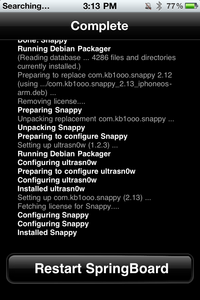

I realize I'm having a conversation with myself here but I have new information to add that I think may be relevant. I really think ultrasn0w may be part of the problem here and this is why. I did the procedure from my 2nd post above again and got Cydia working. There was an app that needed updating (Snappy) so I went to update it and somehow ultrasn0w got involved (keep in mind that ultrasn0w was already installed and working at this point). Once Cydia finished doing its update I uninstalled and reinstalled ultrasn0w and when I rebooted my phone after that, Cydia wasn't working again. Why would ultrasn0w need to be updated when all I was trying to do was update Snappy? It's not like ultrasn0w was in the queue or anything and like I said, it was already completely installed and working. Now I'm back at square one with Cydia not working properly. Please help!!!
