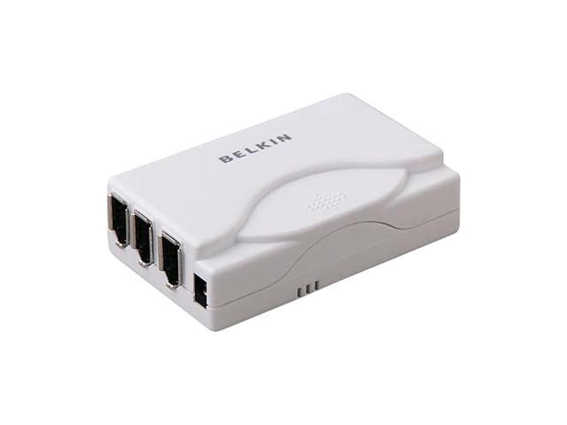

Please show me such thing 😀. Never seen this IRL.
They're expensive and not commonly seen because they're very niche devices, but they are out there:
And for FireWire 800:
Reactions: dextructor

i have seen those hubs out there before, something like 120 firewire devices can be run off of a single firewire hub as usb can run 126 devices off of a usb hub.

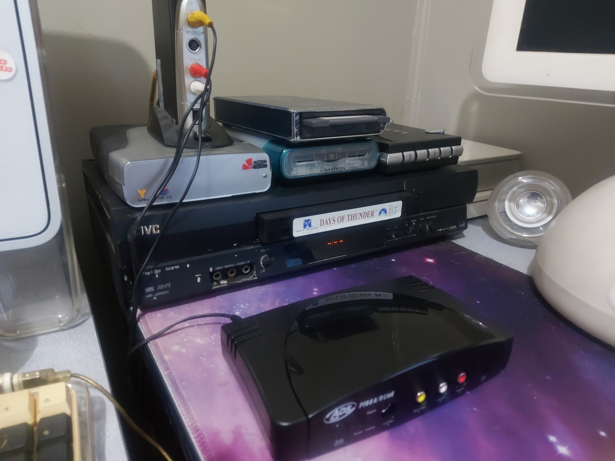

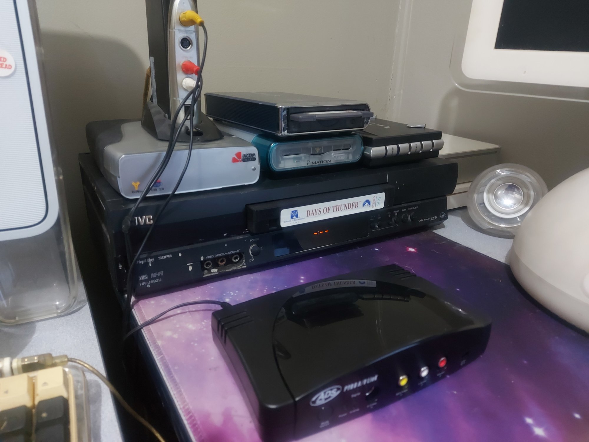

how i have it set up right now it the hollywood dv bridge daisy chained into an external hdd which is then plugged into the mac. the second external hdd is just plugged into the other firewire port on the mac. so far everything is working as it should. i was able to copy over a vhs film to digital and have it copied to the external afterwards.

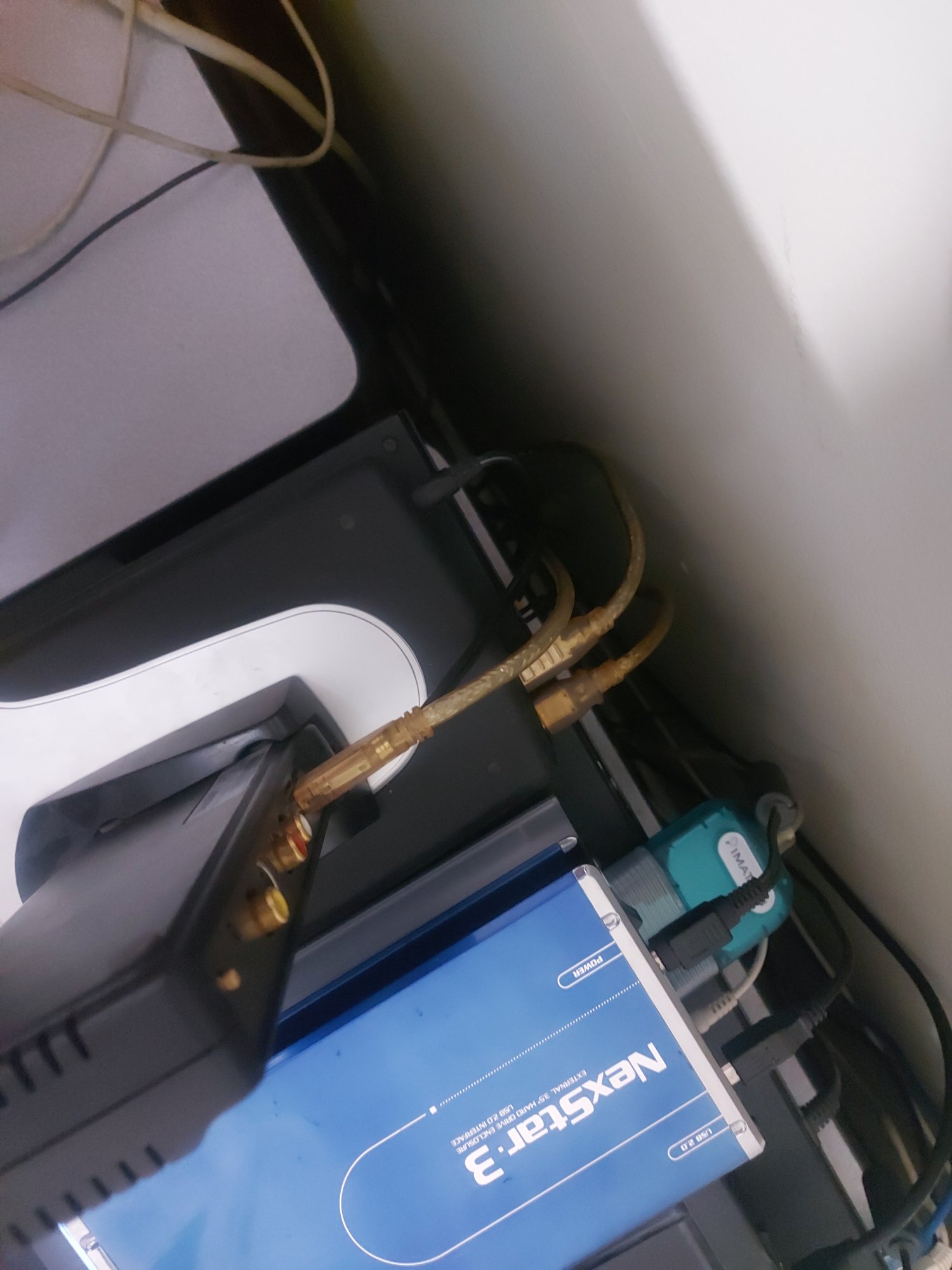

i just wish i could run the pyro because it has component input for recording. 20201113_203828.jpg20201113_203810.jpgPicture 1.jpg

@reddrag0n

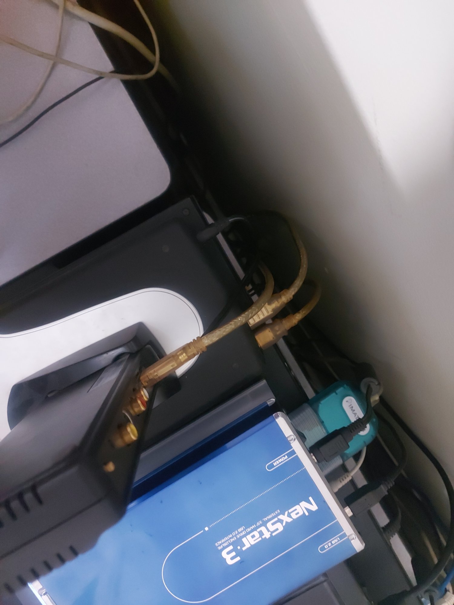

What is second external drive, under NexStar3? "Imation" & triangle force me to think about LS120 USB 🙂. (My favourite floppy drives 😀. Got 2 with IDE connection in pair of my old PCs.)
first gray one is an unknown firewire to ide external case, then its a nexstar usb/esata to ide (modded cut front to hold a 250 zip) under that is an imation LS120, then the far black is a noname firewire to ide
Reactions: Amethyst1
That's very cool. Are you using the LS120 and Zip drives for data retrieval/recovery purposes or...?
I have them because i can, i guess.... i have a few floppies that i use to swap files to my classic, and the zip drive because i have 30 zip disks that are on a shelf. Other than that, i have other odds and ends i have collected over the years. Still have my old imate for adb peripherals... 😀
