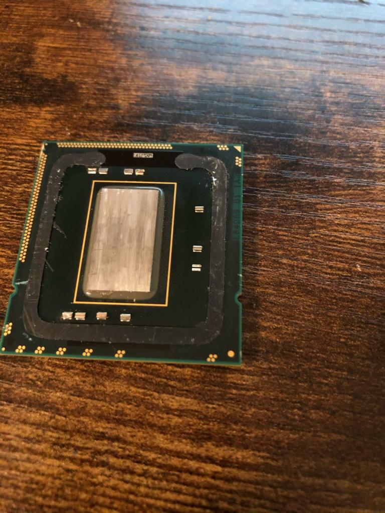

I attempted a delid today and noticed when the IHS was off, I had nicked a few of the “blocks” there. It is on the bottom right of this picture. Are these crucial? Can I simply solder a bead across both contacts?
Hello,
In July I did the same things and when though the same issue as you. I did break 2 capacitors.
I bought a new CPU and delidded again and broke only one capacitor.
I used my solder to fix back the capacitor, put back the CPUs on the board, power the MP and it worked.
According to your picture, I can see more than one capacitor off. This is too risky to put it back like that. I would either recommend to not delid, ask someone to do it for you or try again but with the same risk behind.
Also you could consider to buy a small Chinese hot air station from AliExpress. This will do the job very well and help a lot in the process plus other things.
Thanks
Thanks for the reply. Yeah there’s on that is completely off and another that is damaged as well. I have bought a delidder and will go that route after I get a replacement CPU.

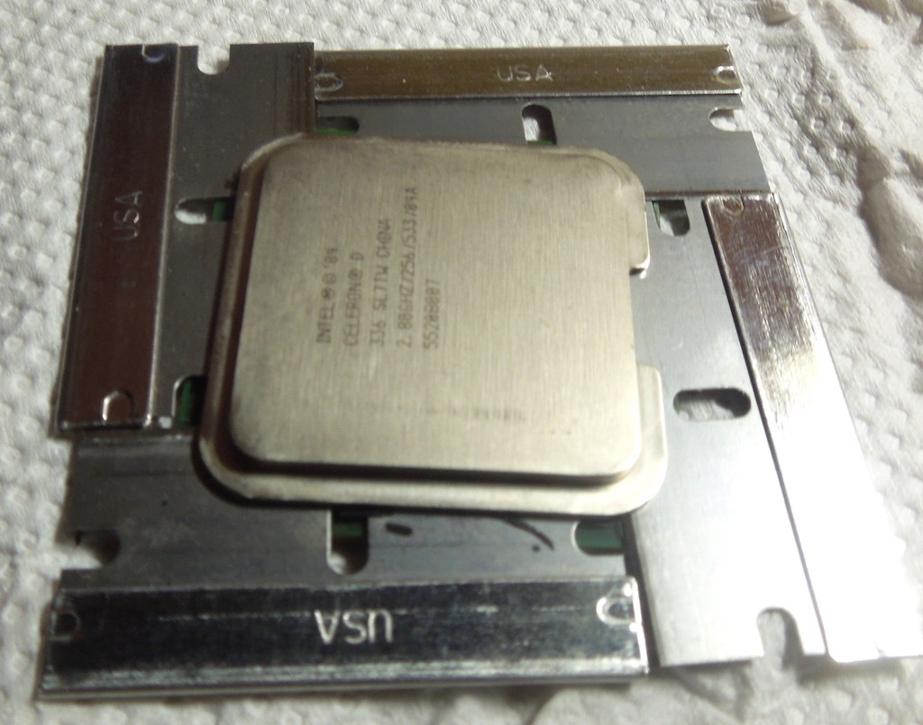

Razor blades work perfetly well as long as they are ANGLED 5° UPWARDS whilst cutting. This way, NOTHING gets nicked, cut etc. Common sense.
( The CPU in the above pic was for PRACTICE )
