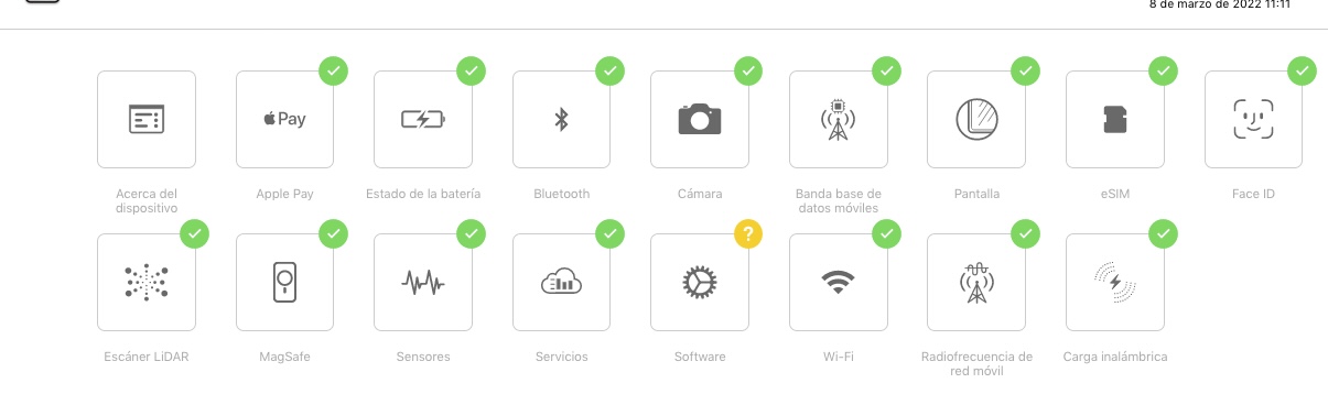

I sent mine to AASP (In Chile we don't have Apple office) and I'll let you know the findings. I hope they can change Wi-Fi module.

The iPhone passed all hardware tests including wifi chip. The only warning was software because I was using a beta version.
Yesterday a friend came to my home and his iPhone 12 suffered from the very same issue as us. Wifi drop while other devices are working perfectly. It’s strange because my partner has an iPhone 11 Pro Max and his device doesn’t suffer from this issue.
In my case I think it’s a firmware problem between iPhone 12 and 13 and the router that my ISP uses, a Arris.
Why I think this? Because this same iPhone works flawlessly in others wifi with others routers. Also older iPhones work right with this Arris router.
