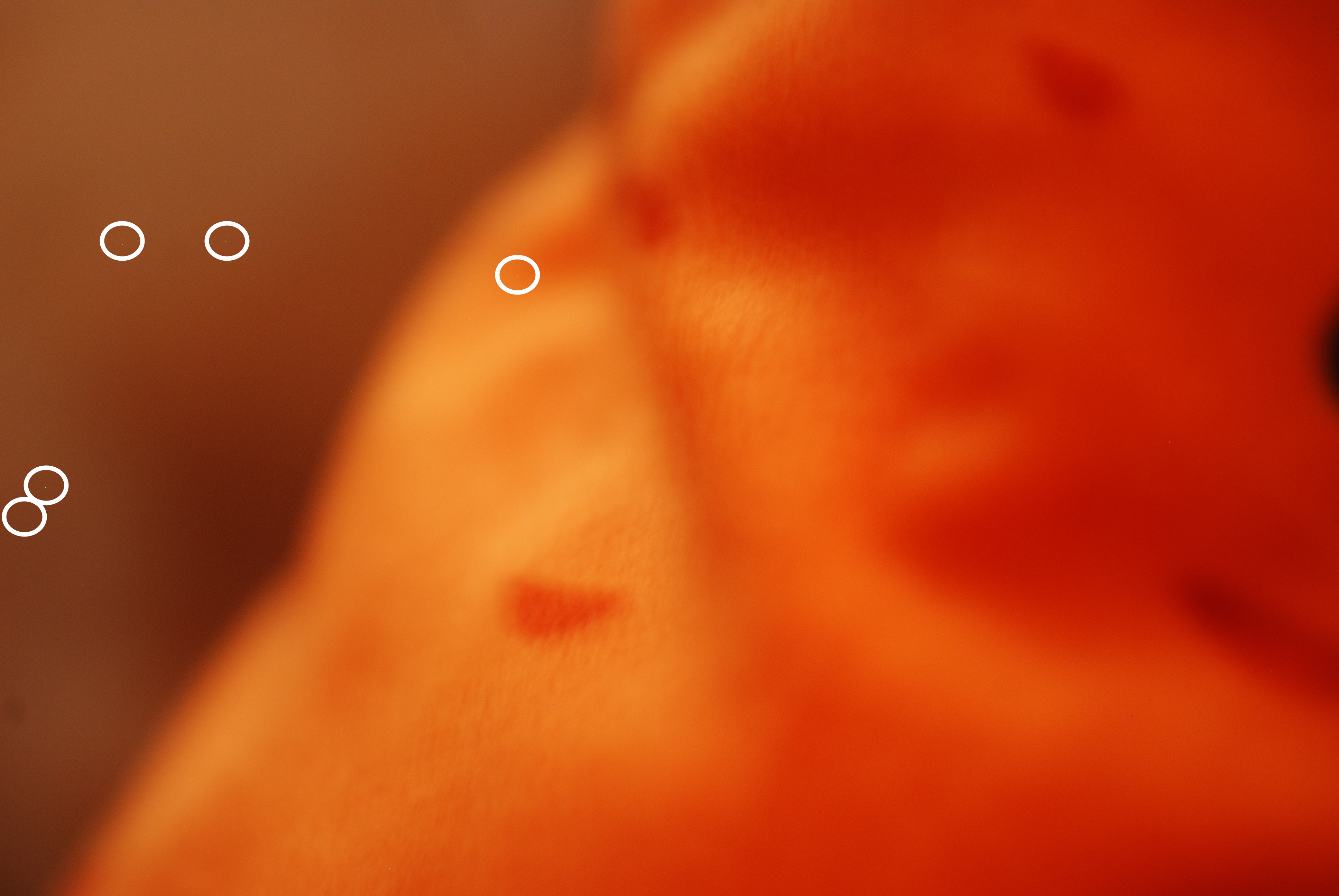

Hi all,

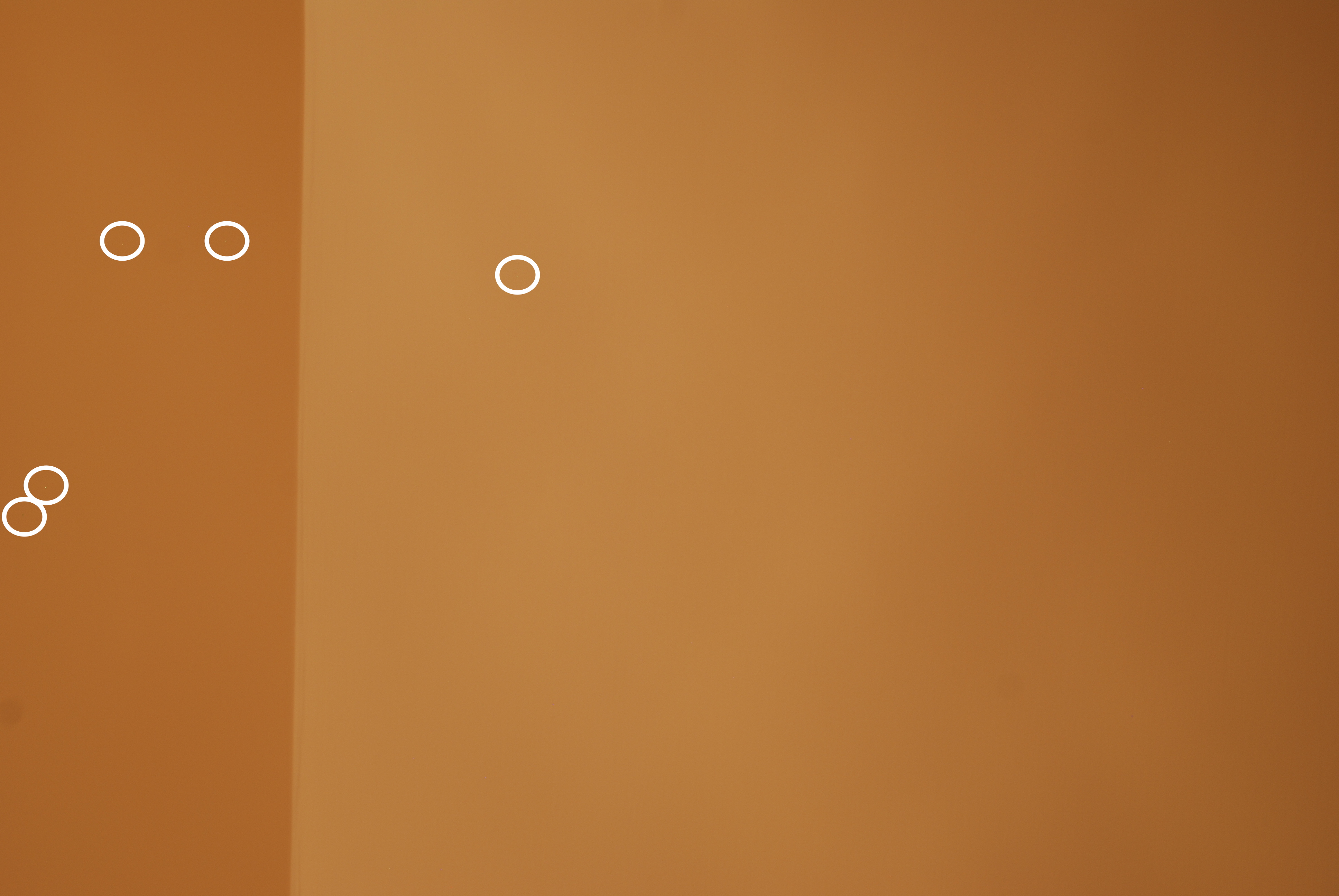

Only ever had one DSLR so I'm not sure about these artefacts showing in photos.
I have a feeling they are dead parts of the sensor if that can even happen because in the two photos, both with totally different focal lengths, the artefacts are the in the exact same place.
So, does this mean my sensor is pretty much dying (somehow)?
Thanks for the advice.
(P.S. they are the original high res images, sorry if they take time to load)
Are you sure that isn't dust? Dust on the sensor shows up in the same place in every photo, unless it gets blow around. Have you examined the sensor?

Could be dust, could be a stuck pixel. Probably a stuck pixel due to the uniform structure. Some of you guys probably know way more about this than I do, but isn't a dead pixel a black pixel, and a stuck pixel pure white (or sometimes red, green, or blue)? Either way, I've had cameras with stuck pixels, and it's not really a problem. Some manufacturers have a diagnostic utility built into the camera to detect them, and automatically fix them. Some don't, and you do it in LR/Photoshop.
I'd be shocked if your sensor is actually on the fritz, though.
I've never seen bright dust so +1 for stuck or hot pixels. TBH are they visible in the image when viewed normally? No digital image looks good at 100% (ie so you can see every individual pixel displayed as such).
Is it a sign your sensor is on the way out? No.
All sensors have some dead pixels. Manufacturing tolerances mean we always get some.

As said above, that is not uncommon. They are usually mapped out but over time it can change. What camera are you using?
With sensors pushing 50 million pixels these days it would be amazing if you didn't have more than a few bad photo sites.
Reactions: kenoh
They appear to be "stuck photosites".
Modern digital sensors are a package of several components. They don't get dust on the actual sensor itself, but instead on the front surface of the cover glass. Such dust is usually quite large, relative to the image pixels, and has an "out of focus" blur.
The OP's examples appear to be single pixels that are rendering improperly. A stuck photosite would affect only one color, but the demosaicing involved in the RAW processing* will use several photosites to create the RGB values for a particular pixel so there will be some color in the flawed pixel
*Note: all digital cameras always shoot RAW and only RAW, period. Setting a camera to JPEG doesn't change what the camera actually shoots. Instead, it changes what the camera saves to the storage media. If set to save JPEGs, the camera will use its own internal RAW-to-JPEG processing software to generate the JPEG from the RAW data produced by the sensor system.

Tools for cleaning sensors (blowers, wipes, ...) are a good thing to have, but the faults shown in the sample pictures are not dust. Dust can't get on the actual sensor. It lands on a sheet of glass in front of the sensor and thus leaves large, somewhat diffuse dark spots. These tiny white spots are certainly stuck photosites. Remapping will help, provided you camera offers the feature. Unless they are increasing in number over a short time I wouldn't worry about a "dying sensor".
