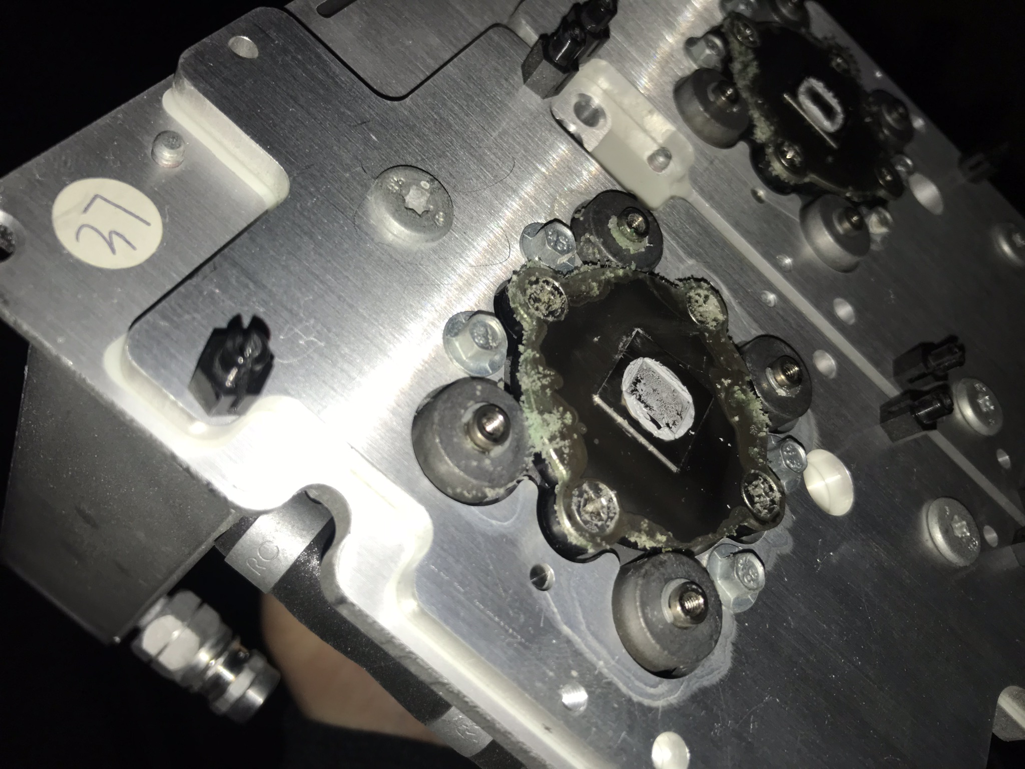

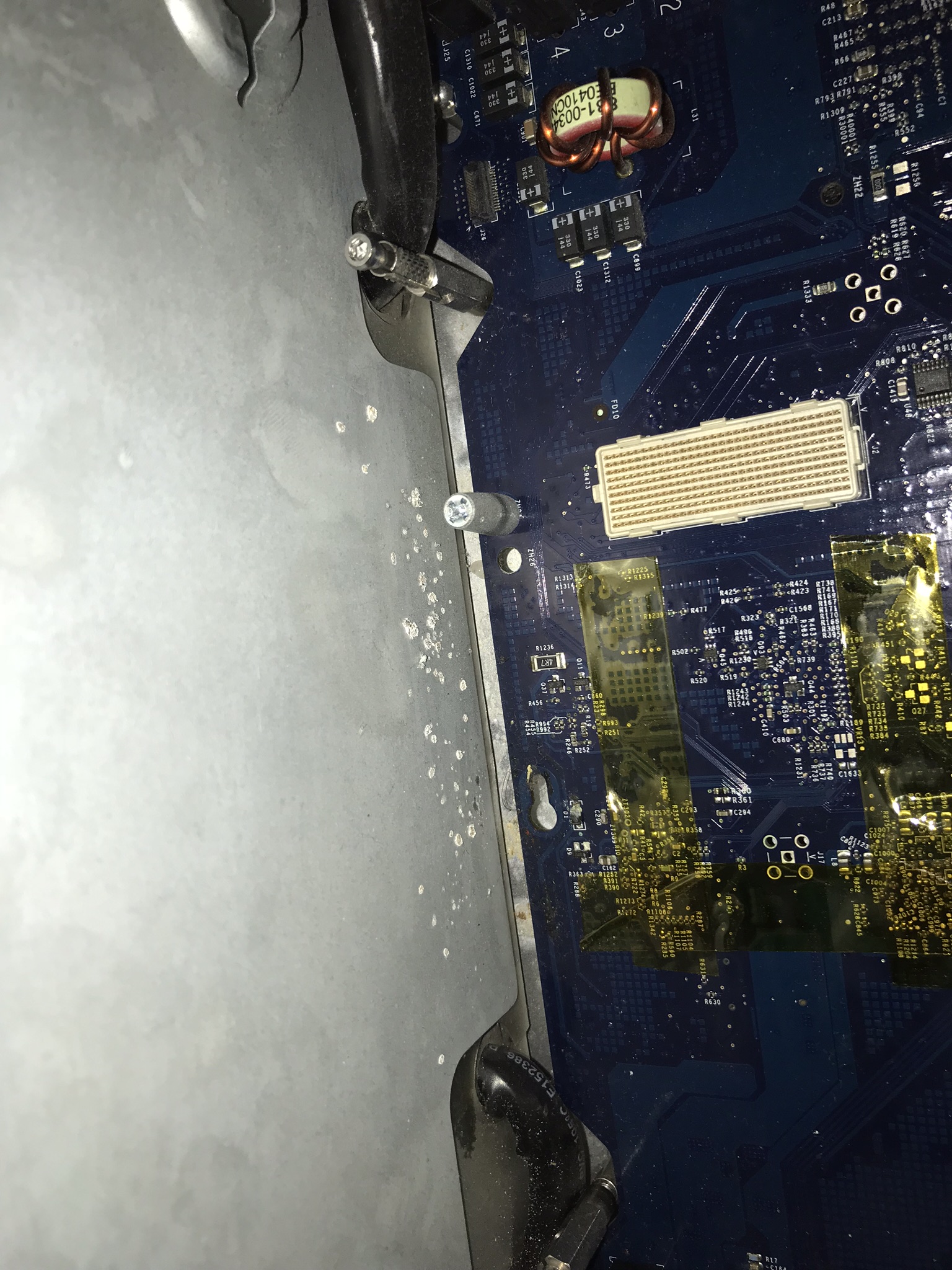

I did notice the residue on top of the power supply:

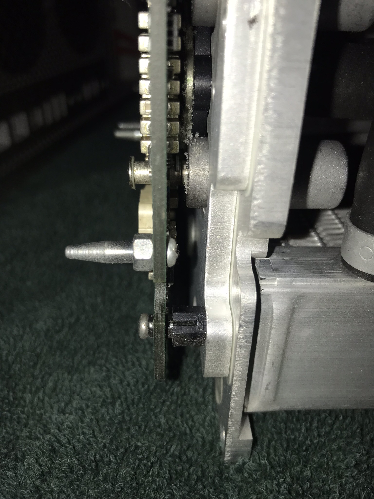

And with the processor cards removed:
It doesn't appear to be extensive wrt the power supply, more like surface contamination. I recommend cleaning up the processor heat sink connections and moving forward with the power supply replacement.
Yep, I've done that. Over the last week I fully disassembled the LCS, installed new Viton o-rings, cleaned off the surface corrosion with a brass wire brush and some alcohol, replaced the very brittle and seeping coolant hoses with 3/8ths fuel line, and refilled the cooling system with coolant.
Update: I pulled everything out of the case; I think I didn't get the processors fully seated or something. The power supply registered proper voltages when I checked it with my multimeter. I had it relearn the thermal calibration, and it's running faster than ever.
